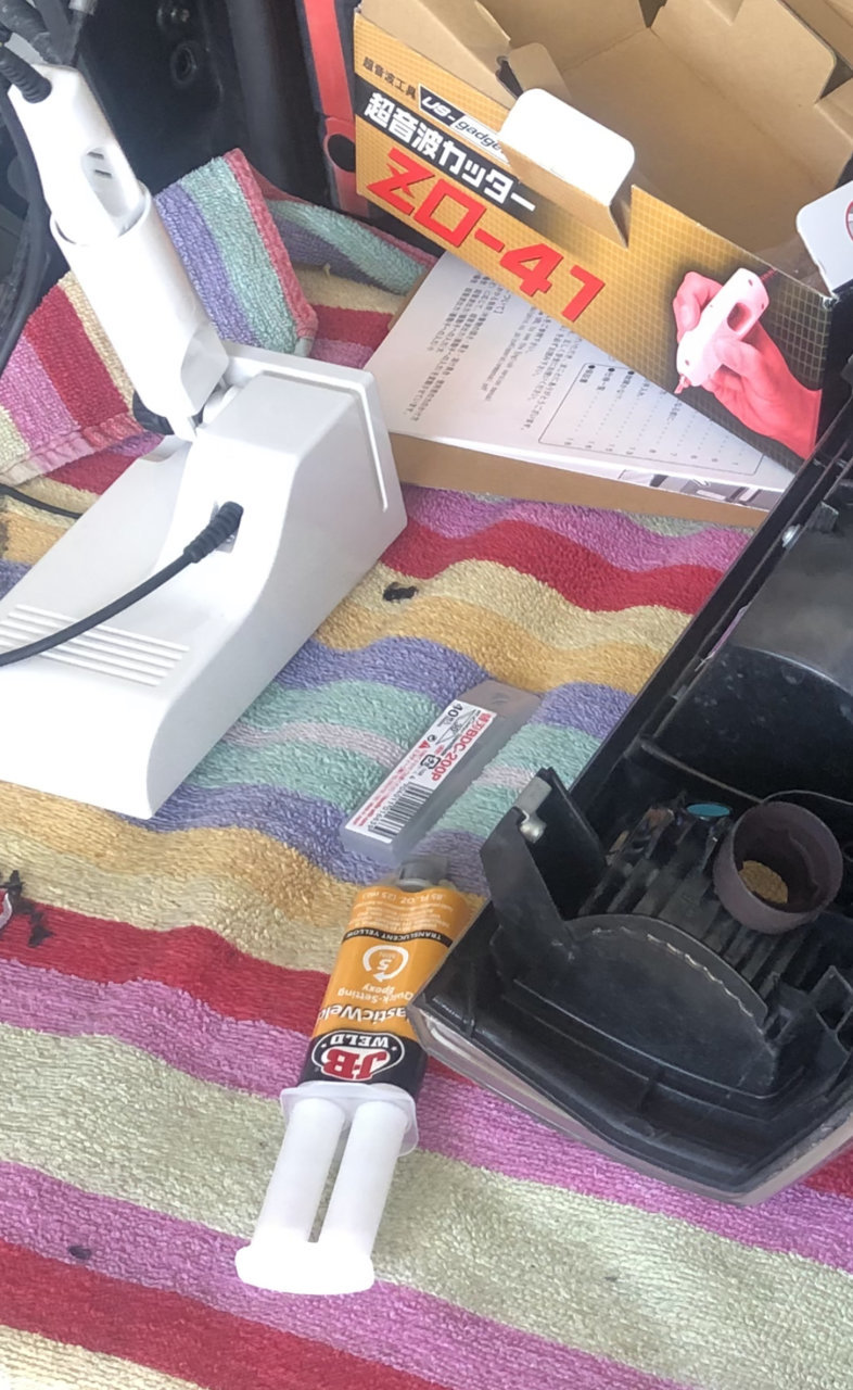

    Will this work to secure the Triton retainer?
    Inferno__Taco likes this.

    My stage 2 leds went in with no problem. I did use JB Weld clear epoxy to fasten the adapter. I did have to add the VLed resistors up front when I added the V6 Tritons up front. I used the recommended resistors from VLed when I did this and have not had any issues.

    Answered my own question. My stuff doesn't work. I'm off to get JB Weld Clear Epoxy tomorrow!
    PapaRee and Inferno__Taco like this.

    Good idea. That’s what I used.
    I had the other stuff, and it will probably work. But didn’t want to chance it with plastic.
