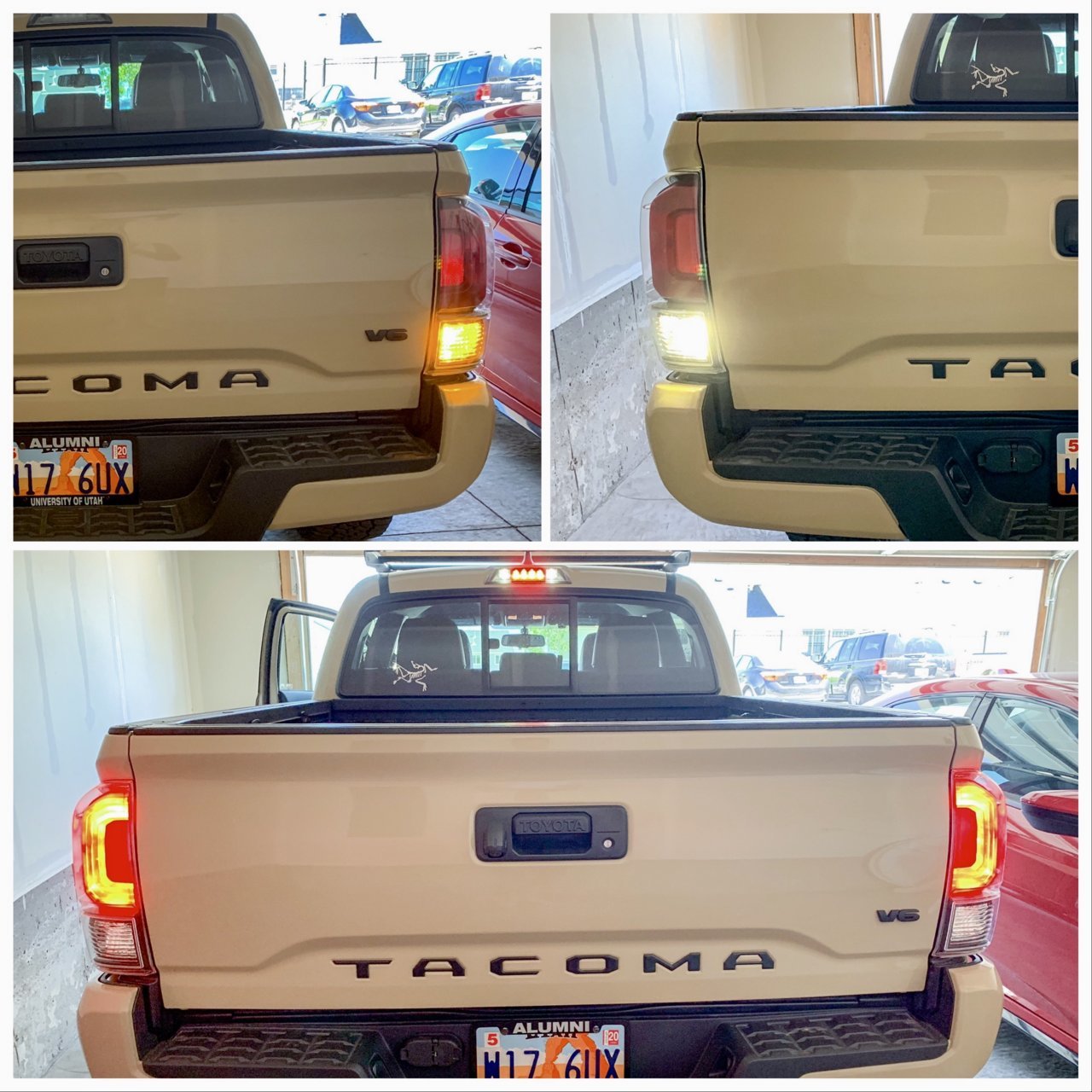

    Well, the soldering iron knife blade worked well enough, probably should have just gotten a true hotblade because this one was more of a wedge. But the tritons are in. Now, the triton bulbs came with what looks like a splice each, and there's two little coils of wire packaged in with the stage 2. Didn't see anything about those items in the videos for stage 1 or 2, do I need to run them?

    Good deal, time to button this all back up!
    Edit: Alright, it's night time and man, I'm in love. I felt bad for the people who decided to have a pow-wow in the parking lot behind my truck when the reverse lights hit em right at eye level, but hey, at least I had zero chance of not seeing them!

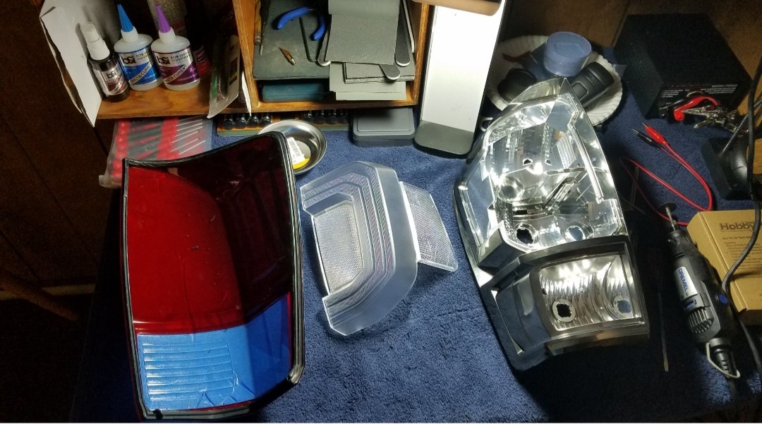

    Just messin around so cut open some tails to do blackout build for something to do. Maybe add these as a bonus.

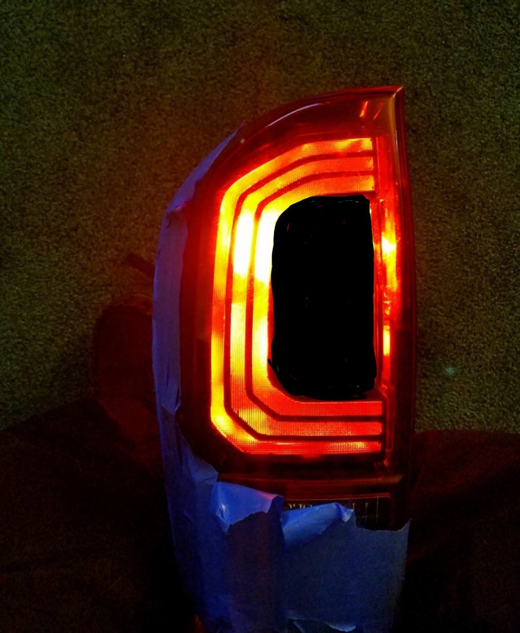

    Well, blacked out back of lens to define the 3c's. Right idea but paint bleed under tape. Hard to see in pic. It's all perferated so can't clean it up. :pout::annoyed::rofl:

  16. Aug 19, 2019 at 6:39 PM
    #3356
    Frsh2df
    Frsh2df Well-Known Member
    Jun 7, 2018
    #255772
    1,504
    2017 MGM TRD Off Road 4x4
    Looks good. How noticeable will they be behind the red lenses ? I’m sure the lights will be so bright you won’t even notice unless your looking for the imperfections.
  17. Aug 19, 2019 at 6:54 PM
    #3357
    20tacoma17
    20tacoma17 Well-Known Member
    Nov 8, 2016
    #201910
    7,079
    2017 DCLB Sport AT
    Kings, 275/70/17, a few custom items, lots of Meso mods.
    Bad lighting, it's just 2 flashlights one in each socket. :rofl:
    Hard to see on pic but very noticable in person. :notsure:
    My fault, should have used frig tape and dampened the edges first.
    I'll probably finish them over time and see how it goes.
