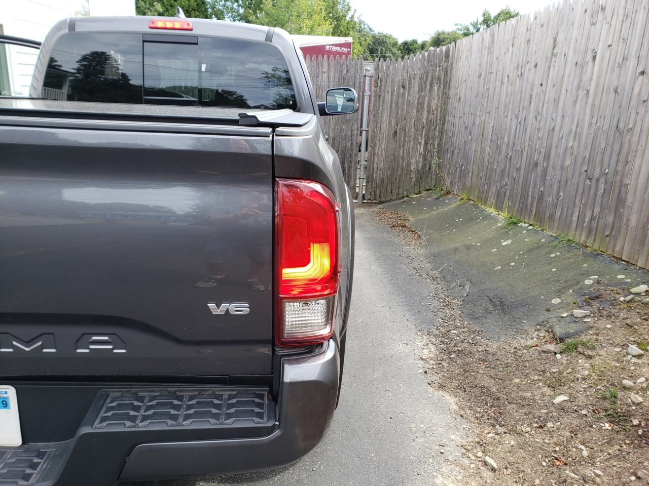

    kite_325
    kite_325 A simple human, being
    May 4, 2017
    #218142
    1,726
    North Carolina
    2017 TRDOR
    Super clean. Nice work. Maybe one day I’ll look up how to do this myself as well
    Edit: just realized we talked about this in this thread just yesterday. lol. I’m still to afraid of water leaking in later

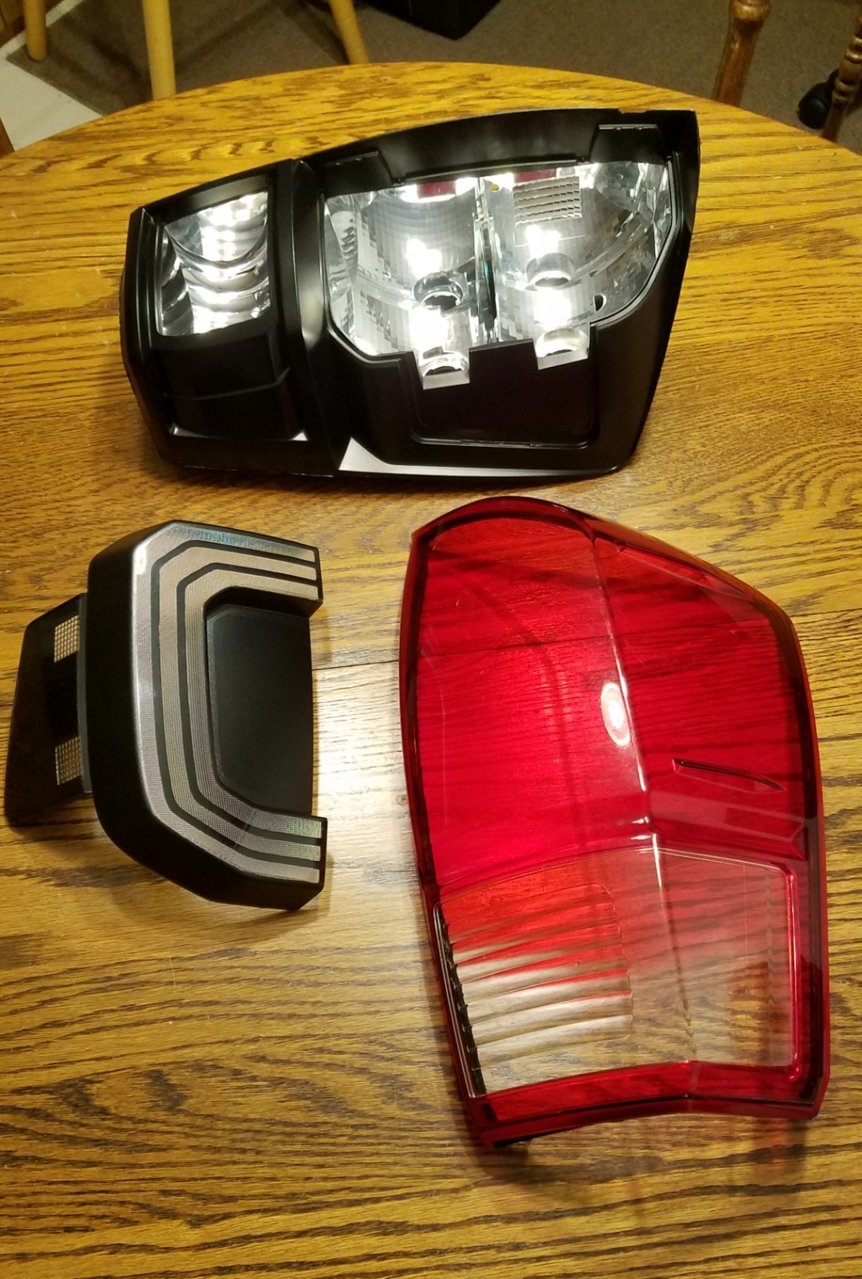

    20tacoma17
    20tacoma17 Well-Known Member
    Nov 8, 2016
    #201910
    7,079
    2017 DCLB Sport AT
    Kings, 275/70/17, a few custom items, lots of Meso mods.

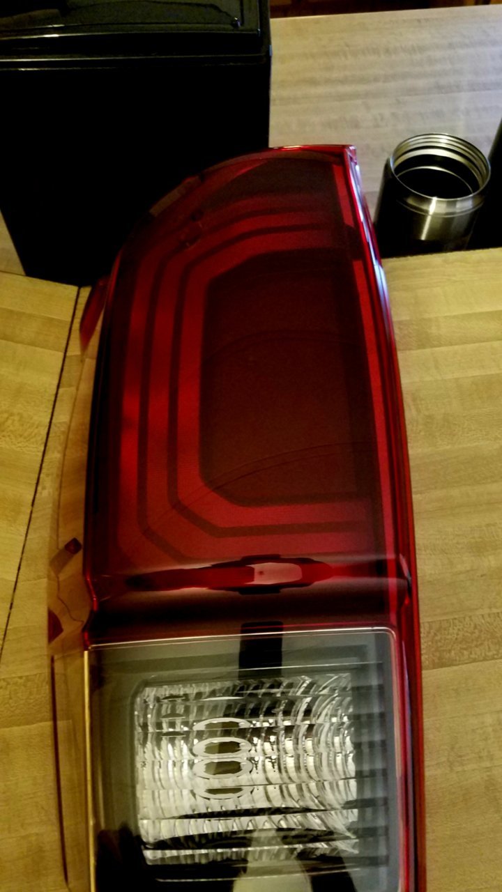

    This is all courtesy of Meso's build thread minus the custom leds. You are not illegally tinting the lens but just removing the chrome and controlling the C pattern. Here it is all apart showing chrome reflectors and unpainted lens. Also Meso's build thread.
    https://www.tacomaworld.com/threads/3rd-gen-btlm-led-retrofit.467712/

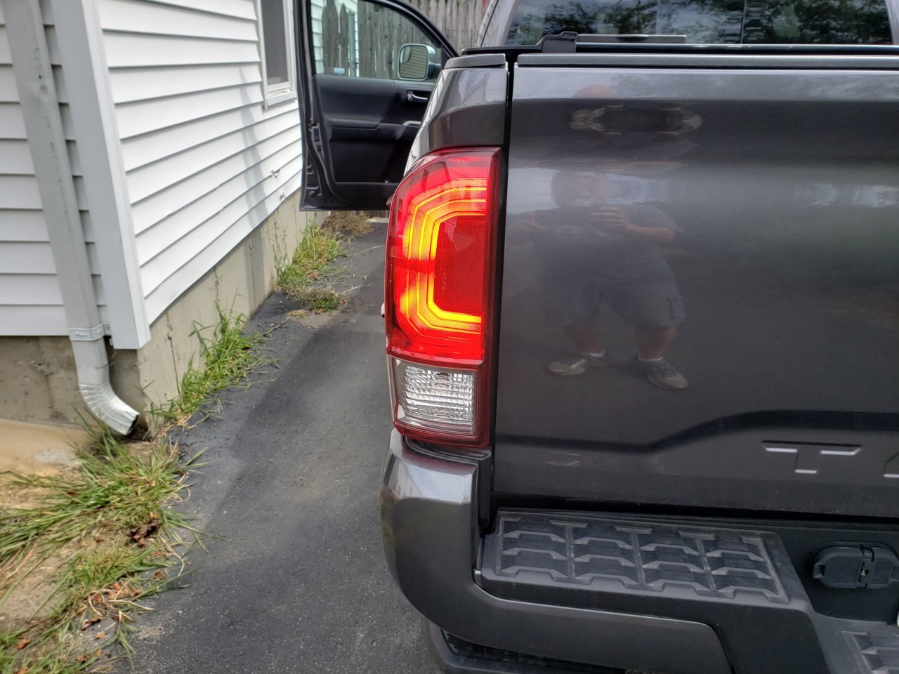

  6. Aug 27, 2019 at 9:22 AM
    #3406
    oly51
    oly51 Well-Known Member
    Dec 3, 2013
    #117807
    361
    Gary
    S.E. MA
    2017 Tacoma, TRD Sport, MGM
    Looked at my brake lights today (Stage 1) and noticed only the bottom half of the passenger side light was on.

  7. Aug 27, 2019 at 9:25 AM
    #3407
    Inferno__Taco
    Inferno__Taco Well-Known Member
    Mar 18, 2017
    #213664
    207
    Georgia
    2016 DCSB 4x4 TRD Sport
    I just had that happen to mine. Contact Meso. The top led on my passenger side was broken. The led portion had separated from the PCB.
    oly51[QUOTED] likes this.
  8. Aug 27, 2019 at 9:52 AM
    #3408
    MESO
    MESO [OP] Major Modder Vendor
    Feb 16, 2015
    #148809
    16,292
    State of Jefferson
    2016 DCLB TRD HELLCAT SWAP
    Pull the tail light out and check bulb the connection. I have had a few instances where the bulb vibrated loose from the socket and was not making a good contact. It's super rare for a stage 1 bulb to go dead(I have only had 2 out of 1,000+)

  12. Aug 27, 2019 at 10:32 AM
    #3412
    NoOne
    NoOne El Taco Guapo
    Feb 6, 2018
    #243575
    6,162
    Ø ©
    Gulf South
    2022 Tacoma DCLB OR (AT) - BC
    2018 SR5 - (Sold) 2018 OR - RIPieces 2022 OR - BluCrush
    ^^^^THIS!
    I 've had it happen a few times after washboarding. Some bulbs just like to eject themselves. (With truck OFF: you can bend the prongs in the socket to increase the tension on the bulb).

  13. Aug 27, 2019 at 11:51 AM
    #3413
    oly51
    Dec 3, 2013
    #117807
    361
    Gary
    S.E. MA
    It was a loose bulb. Thanks @MESO
    Then I got the dreaded hyperflash in that light. Turned out to be a cold solder joint on the resistor lead.

    Well this is my first set. Some minor things but learned a lot. Just waiting for paint to cure then reassemble. Next set will be easier and better I hope. Lol
