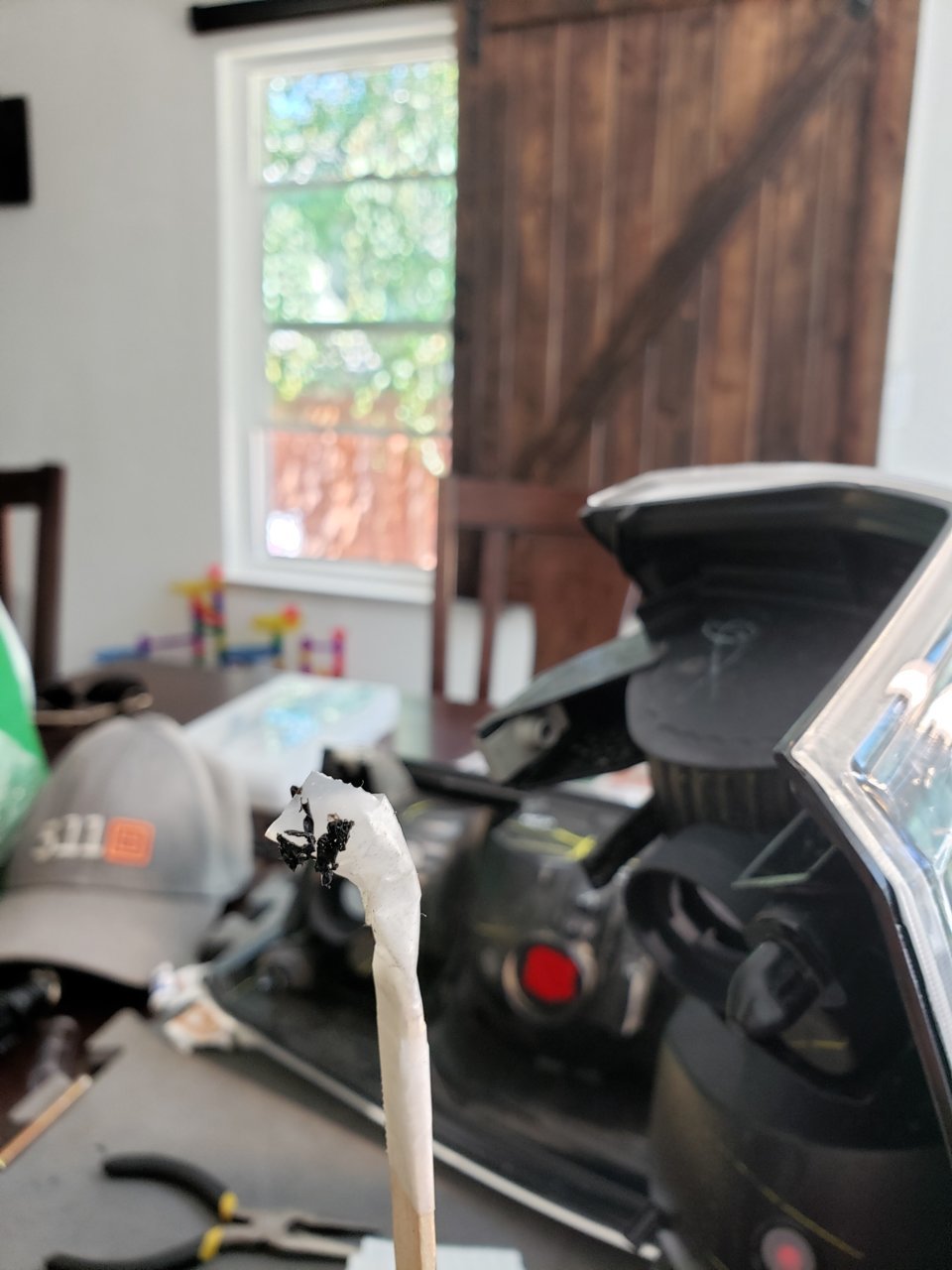

    And if those of you who had some hard to get out pieces, I used a flexible stick or a sipping straw and use scotch tape on the end . wrap it around the stick generously to make the adhesive work for you. I used a hot knife as well. I was cleaning my cut around the hole and had some pieces drop inside the housing. This work great.. try it out!! yeeeah!
