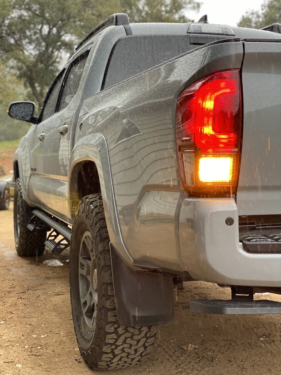

    Ennui
    Ennui Well-Known Tacoma Bro
    Jan 19, 2019
    #279904
    367
    2019 Toyota Tacoma TRD Sport Cement
    - Audio: Alpine 5-Channel Amp Alpine iLX-F309 Halo 9 Stereo Unit Alpine Tytpe-R Speakrs (F/R) JL Stealthbox - Exterior: BackFlip MX4 Bed Cover Bed Extender (OEM) Bed Mat (OEM) Bed Step (OEM) Bed Lighting Kit (OEM) Emblem Blackout Overlay (OEM) Meso Gasshole Meso Ultimate Turn Signals V4 Predator Tube Steps (OEM) Redline Tacoma Hood Struts QuickLIFT PLUS Roof Rack (OEM) TRD Cold Air Intake (OEM) TRD Pro Exhaust (OEM) TRD Pro Grille (OEM) - Interior: Center Console Divider (JDMCAR) Center Console Tray (JDMCAR) Covercraft UVS100 Custom Sunscreen Glove Box Organizer (Vehicle OCD) Meso Tacoma Coin Tray Meso Ultimate Dome Light Meso Ultimate Map Lights Taco Garage DMM Mount TRD Pro Shift Knob (OEM)
    "Whoa, amber is the color of your energy!" :)
    Relocating the turn signal and making it amber is perfect. Full horseshoe much brighter!
