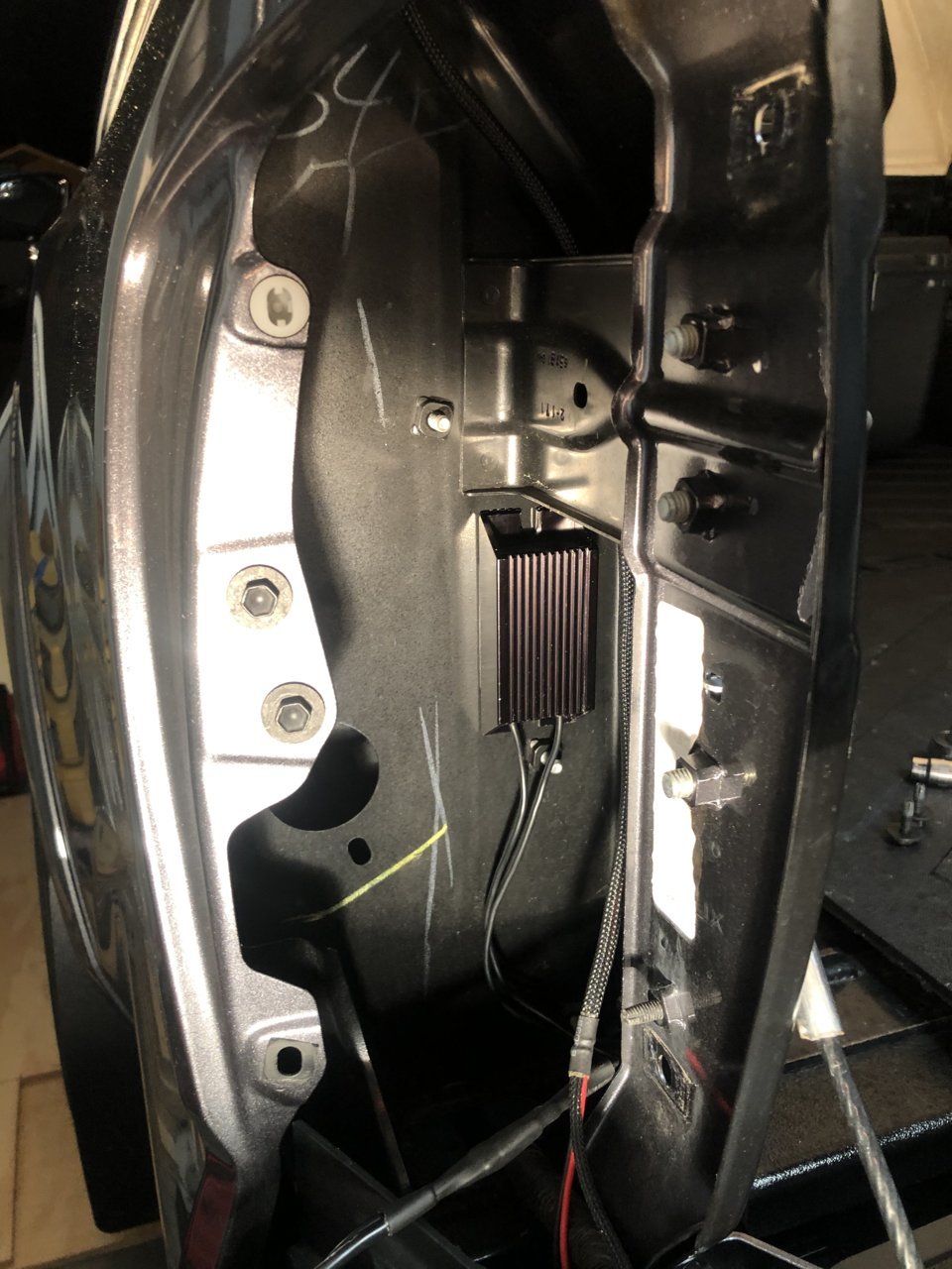

    Has anyone tried installing a Stage 1 on a 2020? I did and now I have hyperflash issues... I never had the hyperflash on my 2018, so I don't know if I did something wrong or if its just something thats going to happen... I messaged Meso so hopefully I can get it figured out but I didn't think the Stage 1 would have any issues... anyone have any tips on how to get it fixed?

    I just installed on my 2020 last weekend. It did require the resistors to eliminate hyperflash that only occurred with turn signal and reverse at the same time. Turn signals alone didn't hyperflash.

    I've been getting hyperflash mainly if I have my headlights on and use the turn signal, occasionally they'll hyperflash on their own. Thanks for the info! Where and how did you mount your resisters?

    Hyper-flash is caused by a lower than expected resistance than the "normal" circuit. If you have the Meso signals and stage 1 on your 18 but only the tails on the 20 that is likely the difference. With that said some of the trucks seem to have slightly different tolerances than others, as odd as that seems. Some trucks need resistance while others do not, even with the "same" configuration.
    @MESO will get you resolved. He stands behind his products and does everything he can to get everything working perfectly. He typically will send resistors out once you send him your order number. Best mount spot is on the metal behind the tail light, resistors can get hot.

    I did the same as BaldBeardedTaco did:

    Great, thanks! Is there something specific you're using to mount it to the metal or are there some screws I can't see? Sorry for all the questions, I'd like to try and get them installed right!

    Meso's resistors come with VHB adhesive on the back. I just cleaned the surface with rubbing alcohol and stuck them on.
