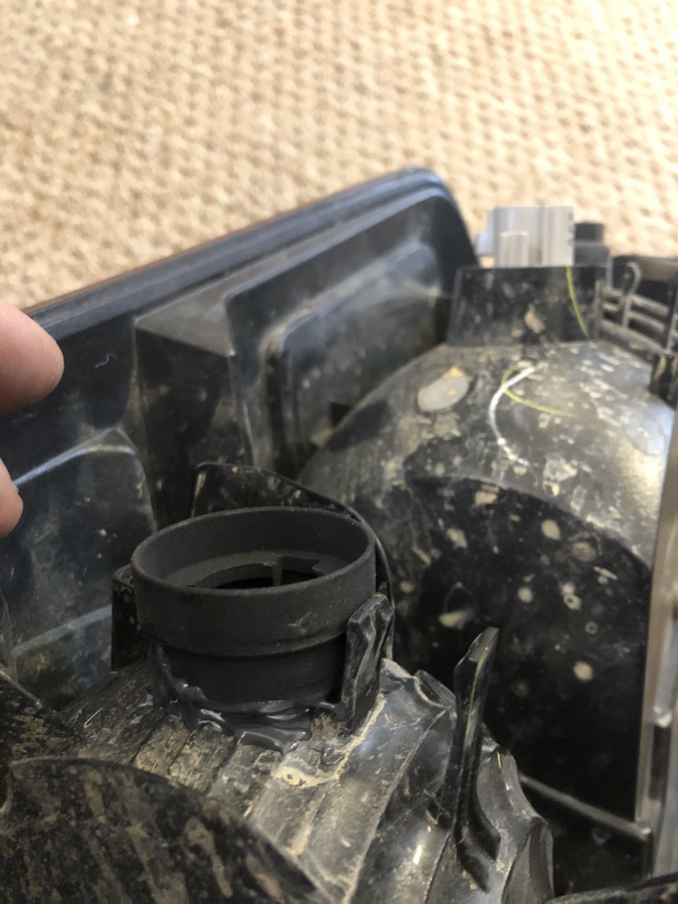

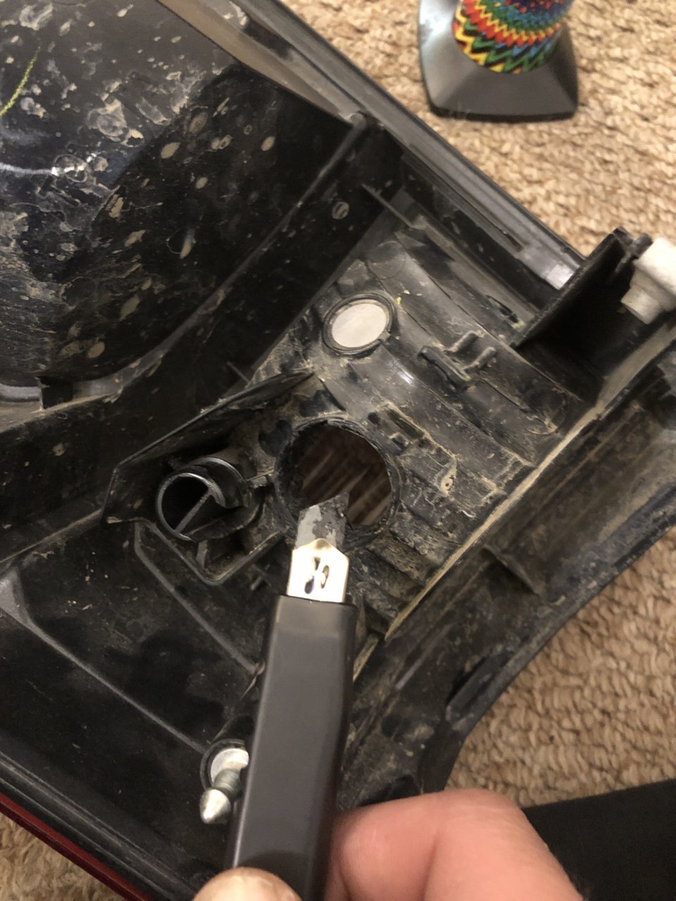

    you might want to go with a thing blade like a exacto or olfa to make the tight radius turn.

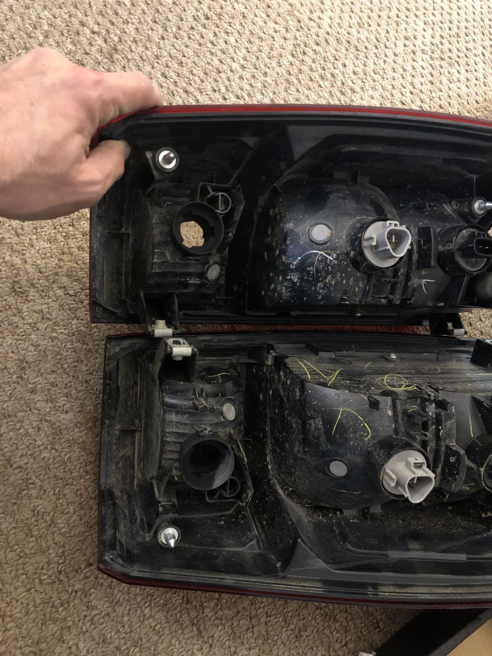

    Yup. Don’t worry about how the hole looks. As long as the adapter fits in you will never see it

    image.jpg 2 down and adapters fit perfect. Honestly the holes didn’t even look that bad. My OCD had me take some fine sand paper and smooth them out a little to make the adapter fit perfect
    UPDATE: JB weld on .... now to wait 4 hours for it to cure
