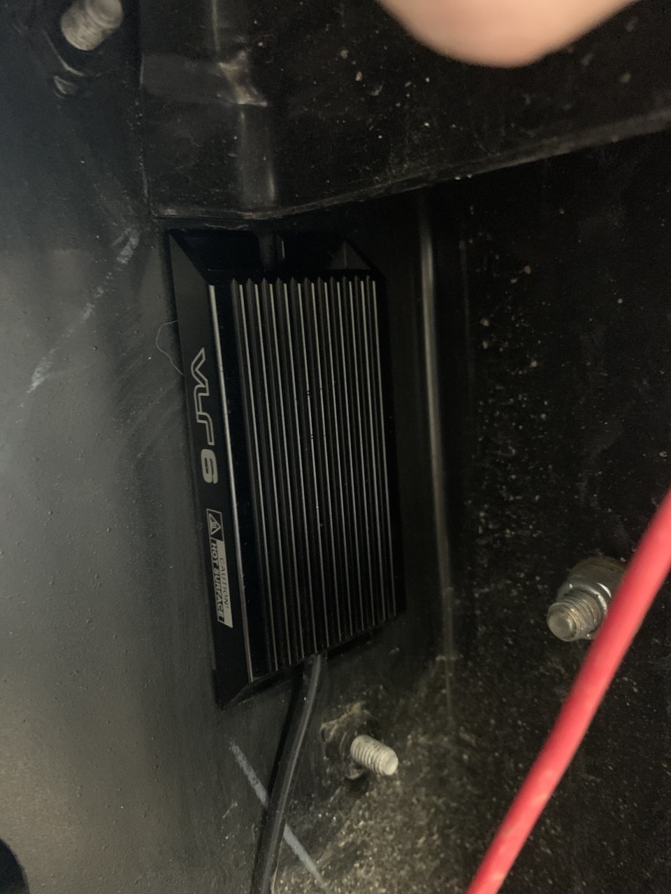

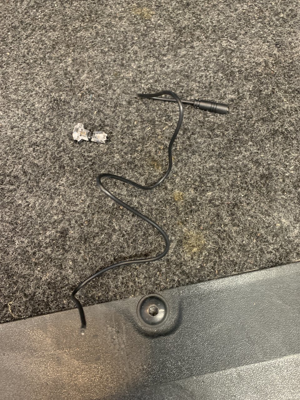

  14. Apr 15, 2020 at 4:57 PM
    #4614
    HolyReptar
    HolyReptar Well-Known Member
    Jan 23, 2012
    #71259
    1,901
    Bry
    Thousand Oaks
    17 TRD Offroad 4x4
    Some Bolt ones here and there
    Anyone with a stage 2 know what I should do?
    Just installed the kit. Signals go once then die.
    @MESO
    only thing I haven’t connected is this because I can’t seem to figure out where to connect the splice.
  15. Apr 15, 2020 at 5:09 PM
    #4615
    MESO
    MESO [OP] Major Modder Vendor
    Feb 16, 2015
    #148809
    16,294
    State of Jefferson
    2016 DCLB TRD HELLCAT SWAP
    Do you have any other aftermarket LED or resistors installed?
    CygnusX191 likes this.
  16. Apr 15, 2020 at 5:10 PM
    #4616
    HolyReptar
    Jan 23, 2012
    #71259
    1,901
    Bry
    Thousand Oaks
    17 TRD Offroad 4x4
    Just your map and dome lights. I just disconnected the driver side black box (resistor?) and that side started working.
  17. Apr 15, 2020 at 5:15 PM
    #4617
    MESO
    Feb 16, 2015
    #148809
    16,294
    State of Jefferson
    You do NOT need any resistors with stage 2. Disconnect any add ons and it will be good to go.
  18. Apr 15, 2020 at 5:16 PM
    #4618
    HolyReptar
    Jan 23, 2012
    #71259
    1,901
    Bry
    Thousand Oaks
    17 TRD Offroad 4x4
    just to confirm I don’t need these to be connected for now? ( came with the kit )
  19. Apr 15, 2020 at 5:18 PM
    #4619
    MESO
    Feb 16, 2015
    #148809
    16,294
    State of Jefferson
    No. 99.9% you don’t need them. I just included them(in the original stage 2 kits) for insurance just in case you did experience hyperflash
