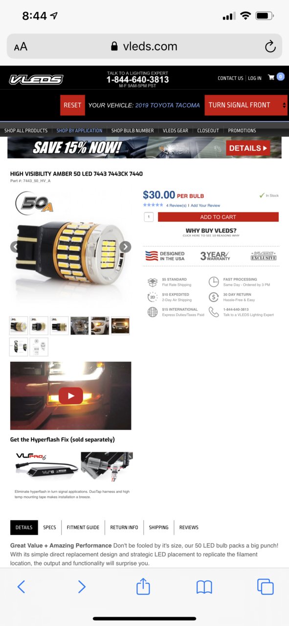

    I did my fronts the other day with matching vleds, so bright now, I actually wish there was a lower power mode for them. Turn signal switch = low power mode, hazards = high power mode.

    you went with these? Did you buy the resistors also?

    No resistors needed, yes those are the ones I got. I also did the front marker light (reflector on the side of the headlight) and license plate lights too.
    The only normal bulbs on my truck are my high beams, but I use them so little I didnt want to invest in something for them.
