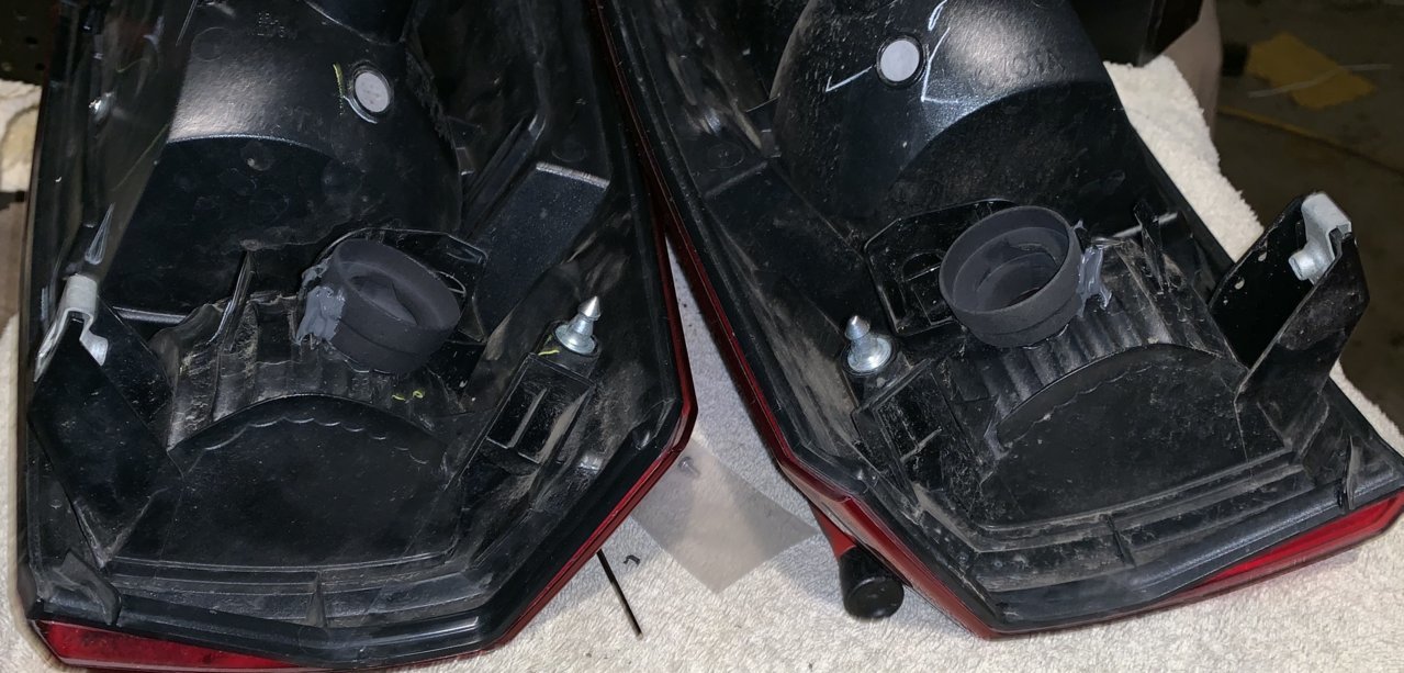

    If you have ocd, do not use a step drill bit. I could not get all plastic shavings out. Doesn’t bother me but might for some. Stage two coming soon!

    For those with the stage 2, I bought a $17 wood burning kit with a hot knife. Worked fine to cut the plastic. Hotter would have been better but it worked. My kit went up to 900 degrees.

    Interesting, my soldering iron goes up to 400* C and had no issue.

    Yeah it worked...but hotter would have been better. I could tell it was the heat not the blade that was cutting it.
