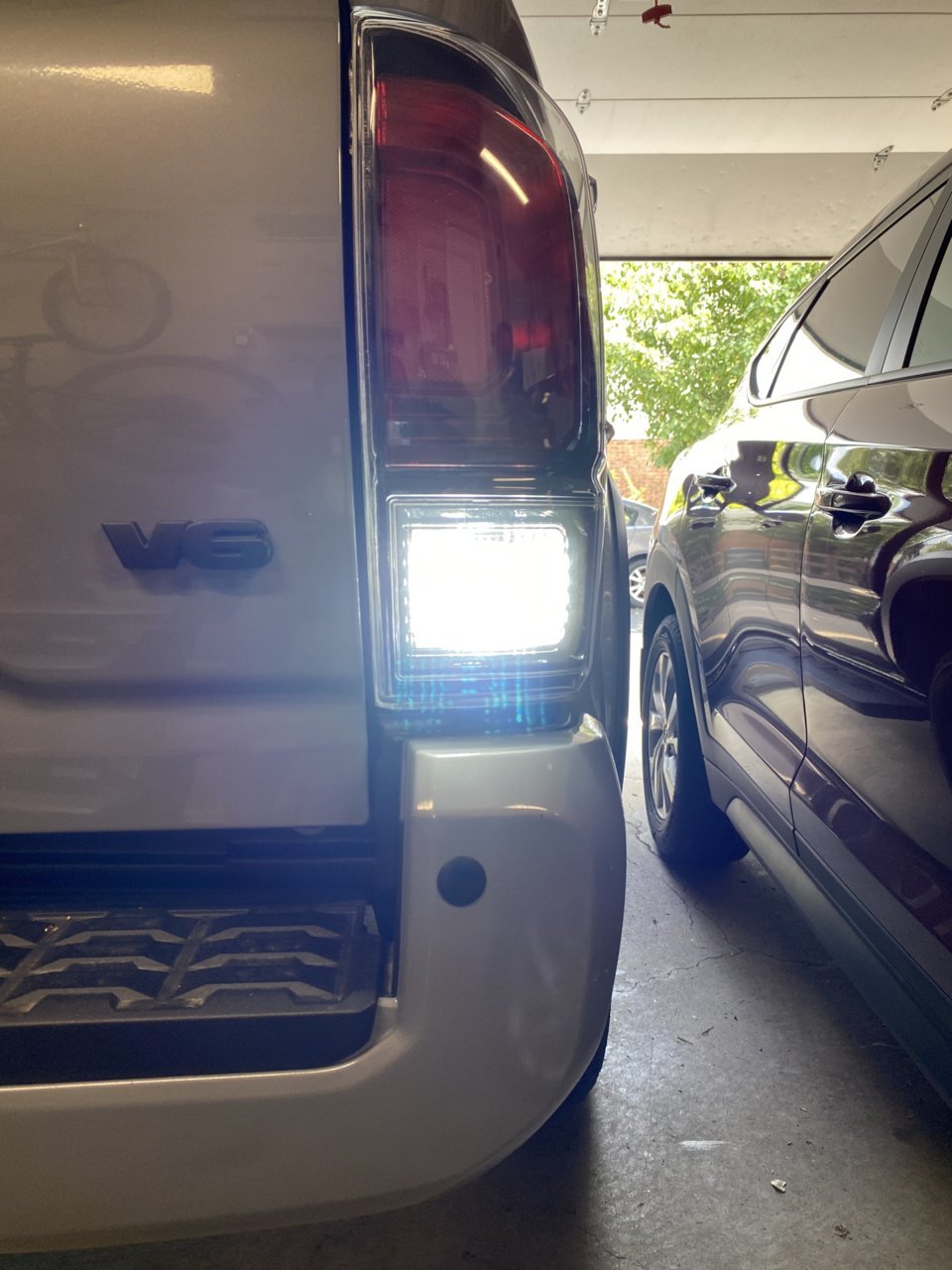

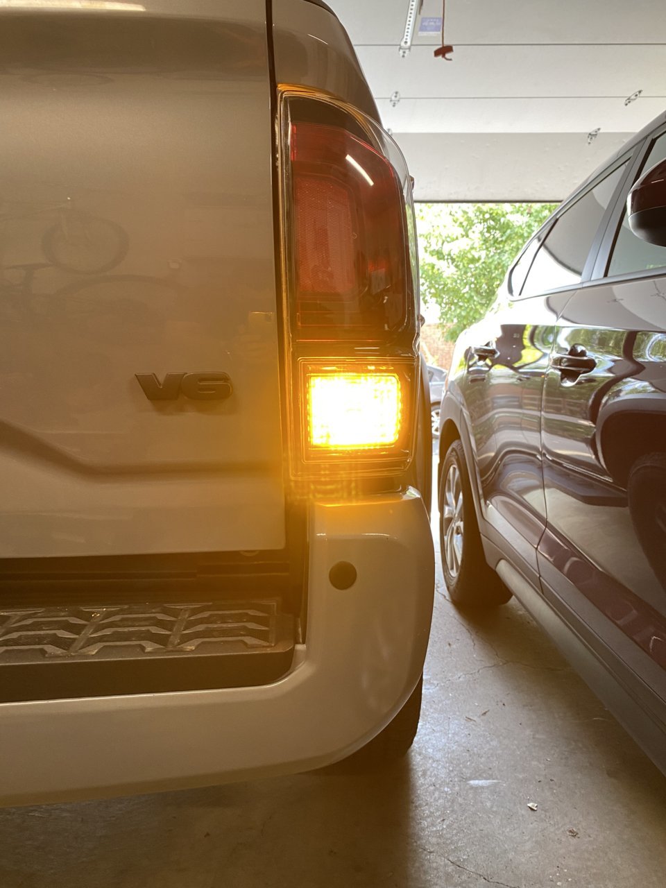

    I put the triton back in but on the drivers side this time. Unhooked the stage 1 on the passenger side to make sure different bulbs weren’t causing any issue and there was no change. Hard to show the difference using a camera without manual controls, but these pictures do enough to get the point across. You can see the difference in the center of the reflector between the triton on the drivers side
    and the stage 1 on the passenger side
    The amber is supposed to have the same output in lumens (500) between the tritons and stage 1s. But when viewed by someone behind the vehicle, the chip placement in relation to the reflector makes the stage 1s brighter to the naked eye. Seeing it in person is more dramatic than what I could capture with my phone.
    Reverse appears to be equal when viewed from the rear in the daylight but I will check those at night to see if the extra 400lm is translating into better throw and thus visibility for the driver.
    Unless reverse is substantially brighter at night, I’ll likely be taking advantage of vleds return policy.

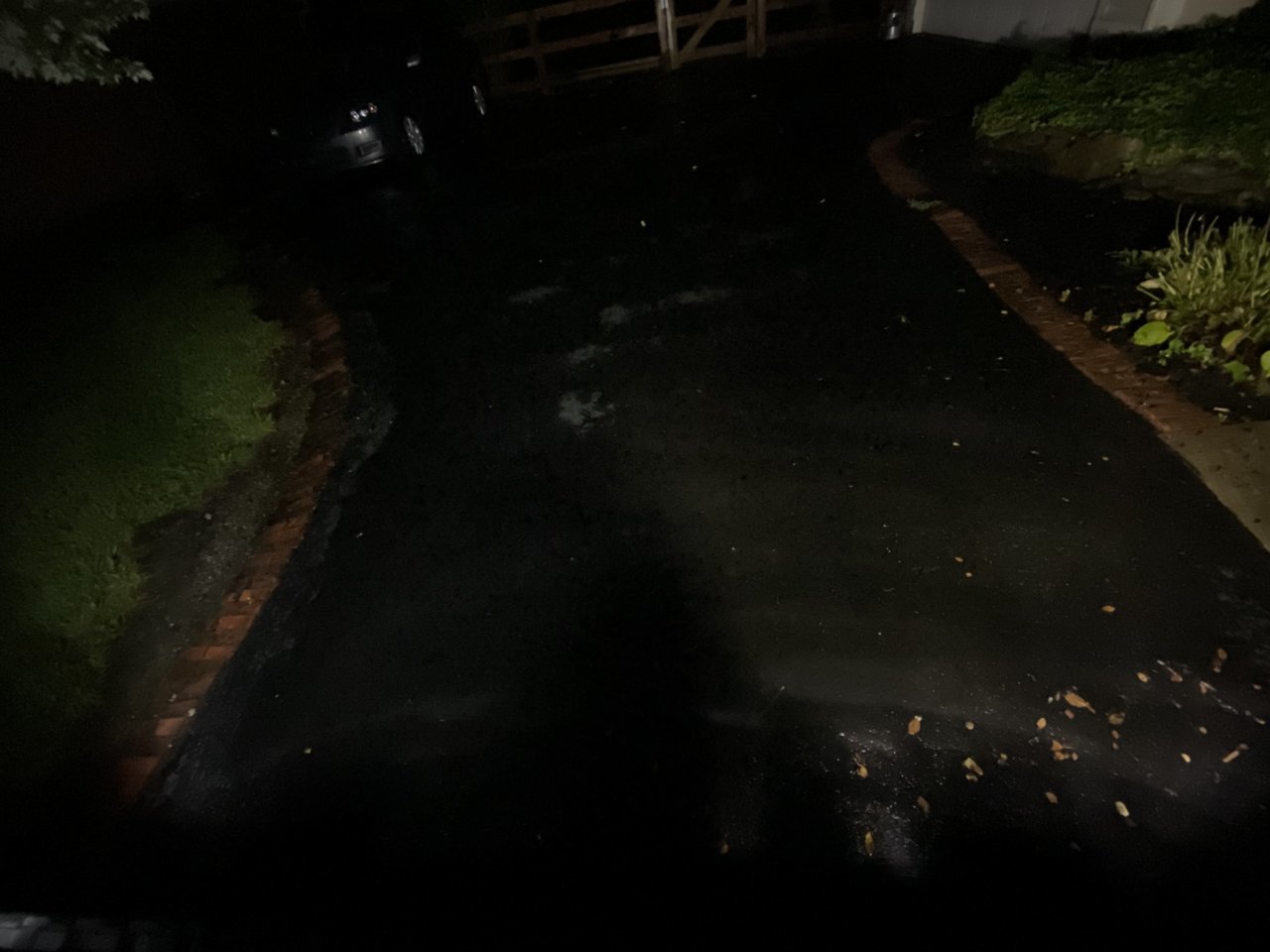

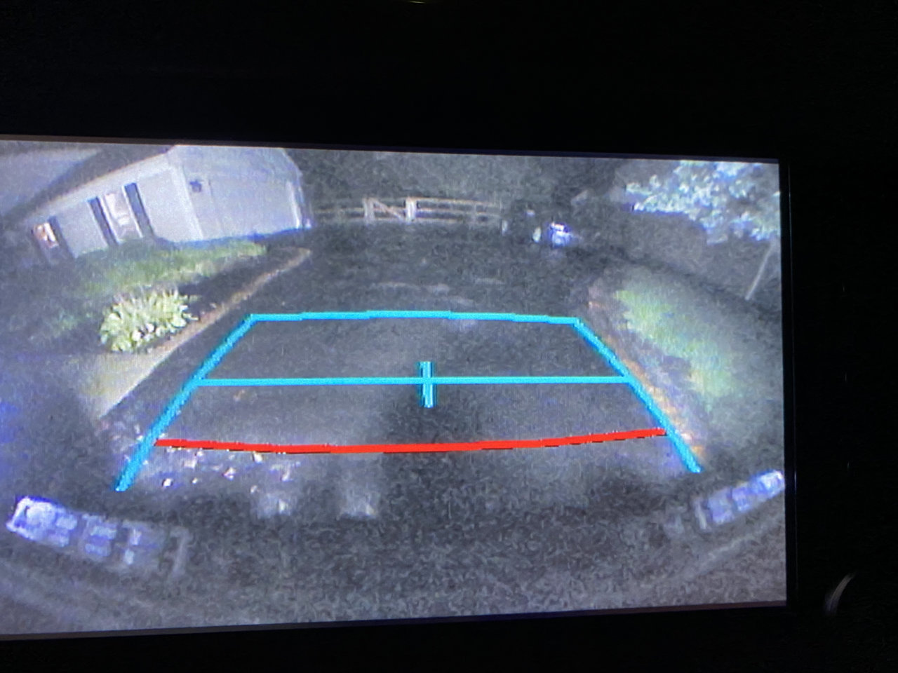

    Ok, night shots of reverse output. Drivers side is triton, passenger is stage 1.
    37E45704-604C-462A-A721-CC8EDADD3BD5.jpg 3B107261-A05A-4E3A-9F63-AA961454546B.jpg
    the triton is definitely a bit brighter (especially to the naked eye, but the backup camera makes them look much closer). for me it’s not enough to justify the cost. Especially when you factor in the lower output for the amber. I’m going to contact VLED about returning them.

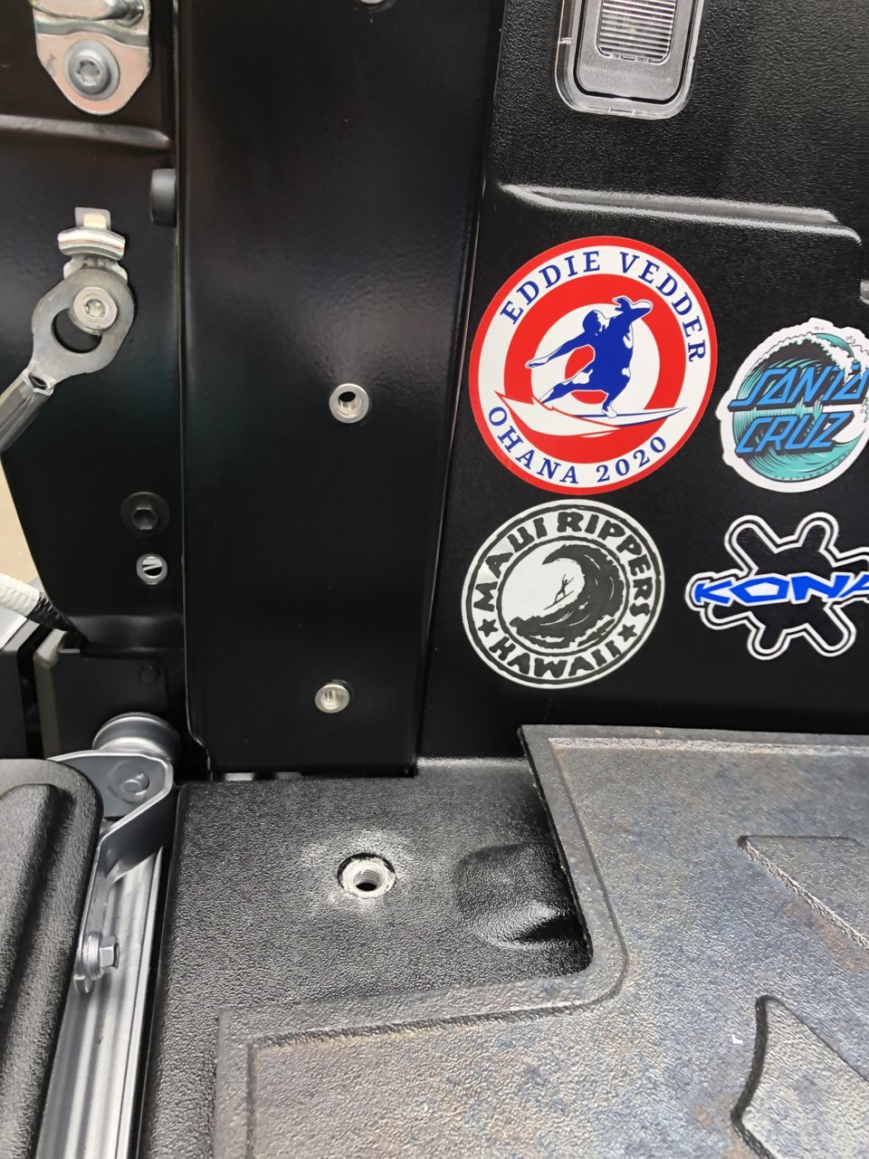

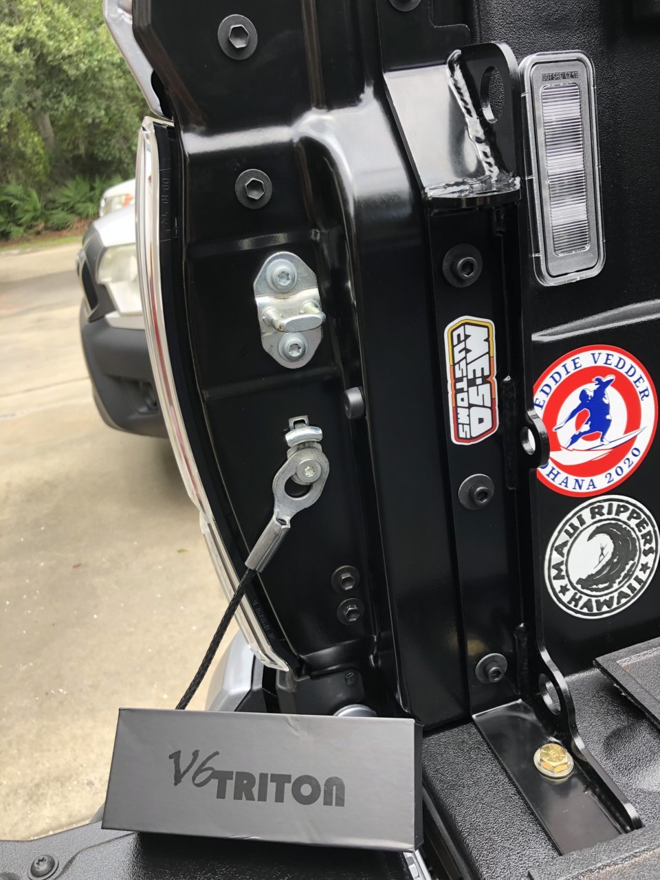

    Switched out the switchbacks and all is good.
    I went ahead and removed the Bed Stiffeners, and put in Stainless rivi-nuts and went with 5/16” -18-1” cap screws for the vertical mounting Hardware.
    As far as the 921’s go, there plenty bright and like I mentioned it’s a clean look with the lens.
