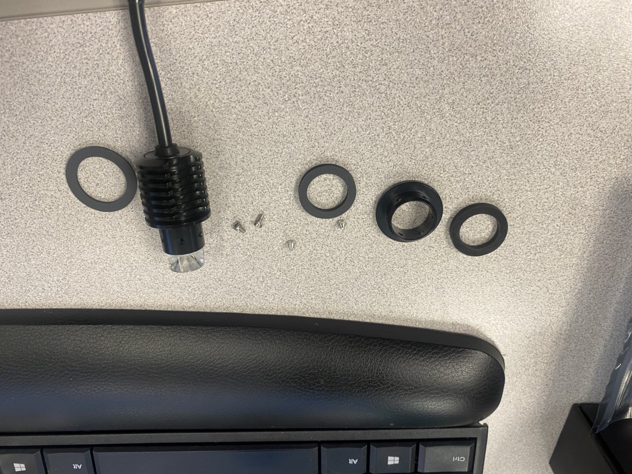

    Pic of the VLED Bulbs with the newer Stage 2 below.
    My VLED I purchased through this thread look totally differently
    tclavell and FishnTx like this.

    Yeah, they come with different attachments for different applications. On post #5413 you can see how I had mine when I used it. Just used one of the round rubber seals
    Edit: That's also the 7443 bulb for the stage two. Those are different compared to the 921. The 7443 are longer and wider used with the VLED adaptor. :sawzall:

    The MESO stage 2 uses the 7443 Tritons, that require drilling out the tail light housing and gluing on an adapter (black part above the bulbs). The one you got is a new 921 Triton that fits in the tail light without modification, with some sacrifice in brightness due to size. It is still compatible with the wiring. If you still have the stock reverse bulbs you can play with the rings to position the 'filament' of the Triton in the same spot as the filament of the reverse halogens.

    I bought the Stage 1 Tails for these VLED's what are the screws etc for? Sorry but zero directions for anything.

    Thanks guys, hate when places don't give you shit for install. Not everyone knows how to do stuff without help or directions?

    Screws are for the twist in application when installing. For the 921 bulb i just used two screws on opposite ''ends'' of the bulb to twist into the socket. The Triton 7443 bulb I used three screws placed ever other screw hole

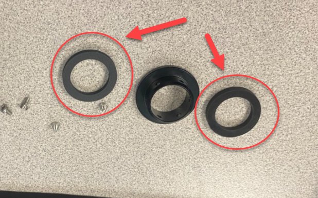

    As for the grommet. I used one of these. Can't remember which one.
    I think it was the one on the left, medium thickness one
