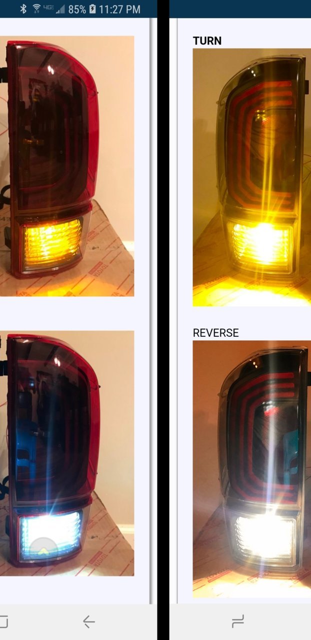

    The 7443s are about 220lumens *each* so x 4 , significantly brighter. I think the stage 2s twice as bright

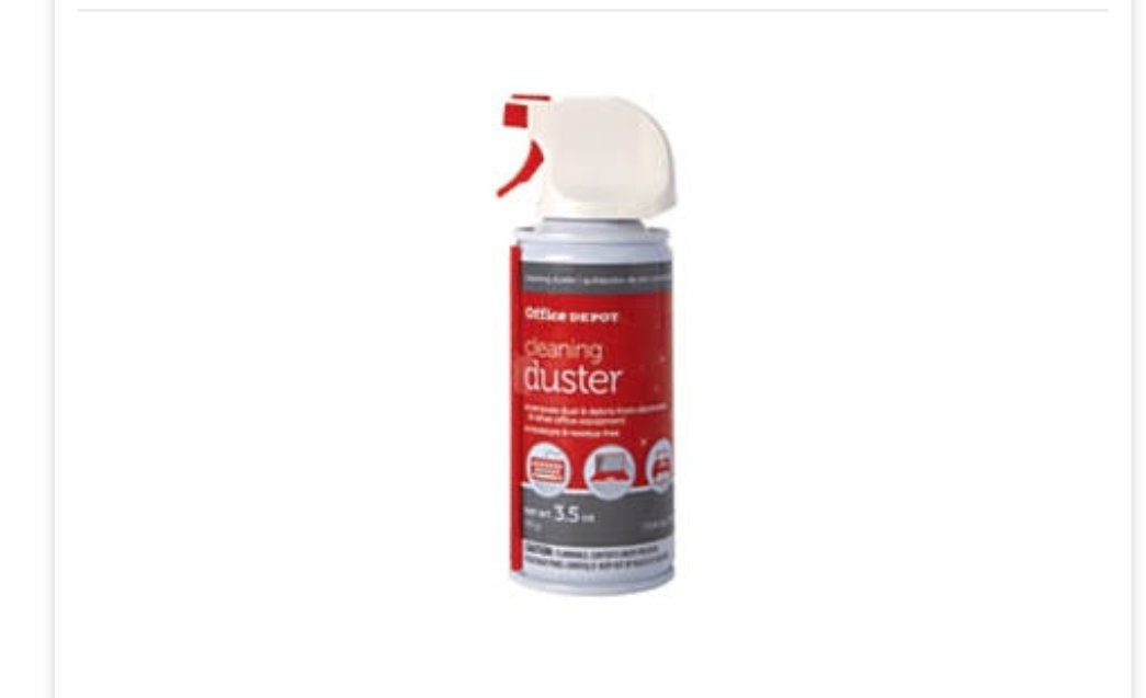

    Trick is having a clean cutting surface. Heat - cut - clean. Plastic will melt and glob on the knife but easily clean off when cooled. This duster comes in handy in case tiny pieces refuse to come out.
    I keep this handy cause the wife likes to snack when on the PC . :annoyed:
