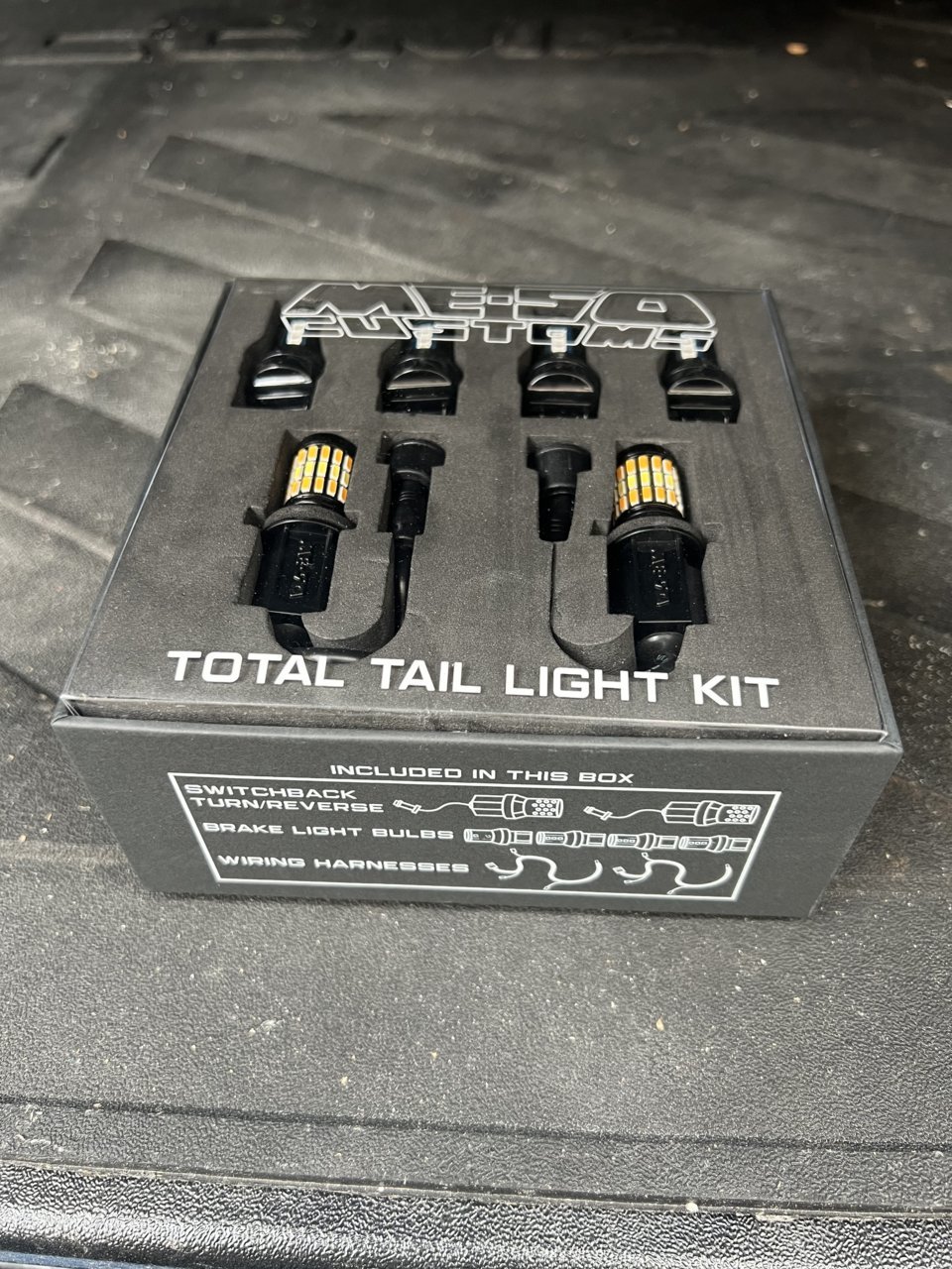

    Look what came in the mail today @MESO 44B6EB13-E1AA-40B4-9A18-9D98EA5BD39C.jpg
