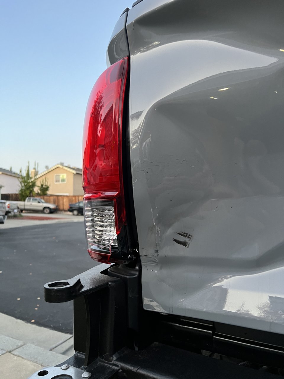

    @MESO any update on production for the vled triton bulb adapters? I was recently involved in an accident and need a new tail lamp; I want to swap my stage 2s over but need new adaptors.

    You'll have to wait for 3D printing to open up again.
    I have a spare set just for this reason. I had to wait a few months last year when I did the same.
    I bought some VLED 921 switchbacks in the meantime while I waited

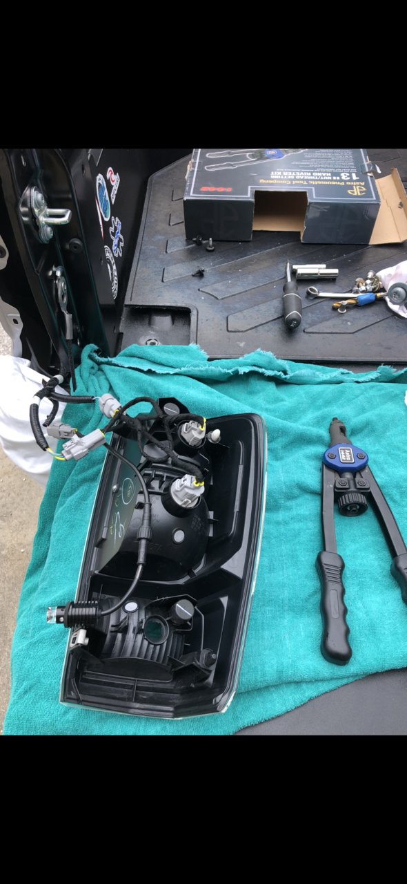

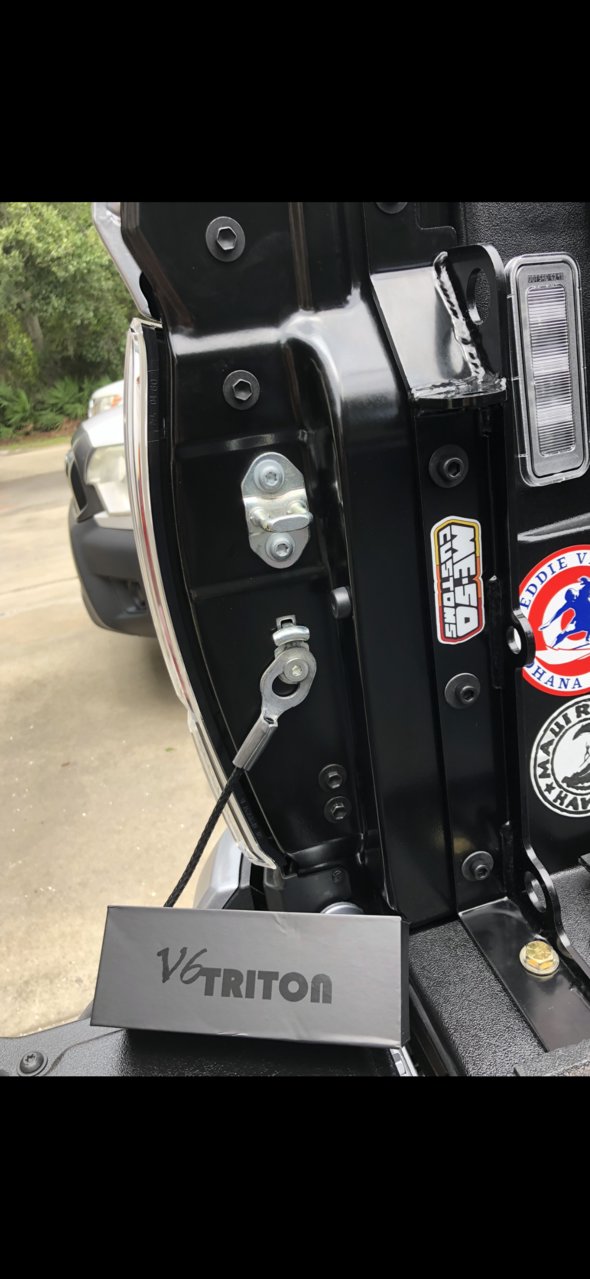

    I think I’m having a Senior Moment.
    My Stage 1’s are upgraded to the VLEDS red Brake and Tail Lights, and I also installed the V6 Triton Switchbacks last year.
    I remember needing a small rubber washer that came with the switchbacks to install them into the Light housing.
    I’m confused why I actually didn’t need the Meso Triton bulb adapters thats necessary for the Stage 2 Kit. It’s been awhile since I added the Kit haha.
    Anyway all is working well and I just snagged a spare pair of VLEDS Red 50’s to keep in the console for backups from their B/F Sale, 15% off.
    Also I added @daveeasa License Plate light shut off in reverse mod which works great.

    You didn’t need bulb adapters because those are a smaller 921 switchback. The Tritons that come in the stage 2 are are meant to replace a larger 7443/3157 size bulb so they are larger. Then, beyond those, if wanting brighter you can get the V6 extremes that will fit in the same bulb adapter that the stage 2 supplies.
    I tried that 921 switchback and found it was dimmer than the Meso switchback so I kept the Meso. Now that VLEDS has their tail kit, they supply a switchback that is very similar to the Meso switchback (they designed it for Meso). So I now run those and the 50 reds. I returned the 921 V6 switchback since the brightness was relatively dim in my experience.

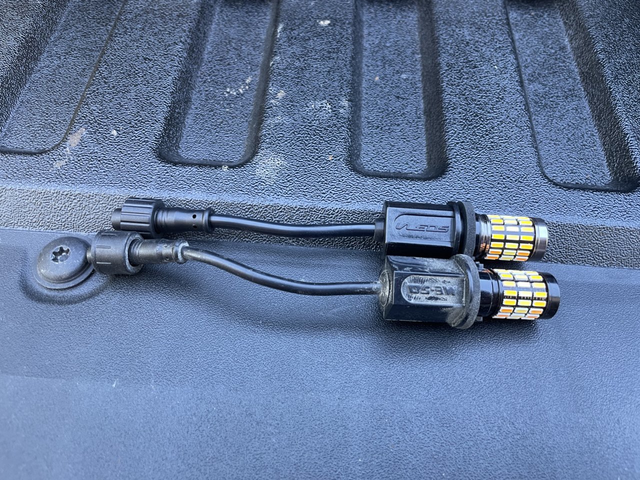

    Sorry I spent your money. Maybe this will help you feel a bit better :)
    Meso on left, VLEDS on right
    About the same brightness but the VLEDS is instantly on.
    This is a Meso thread, so I should probably cease most of my discussion on this, but at least wanted to share
