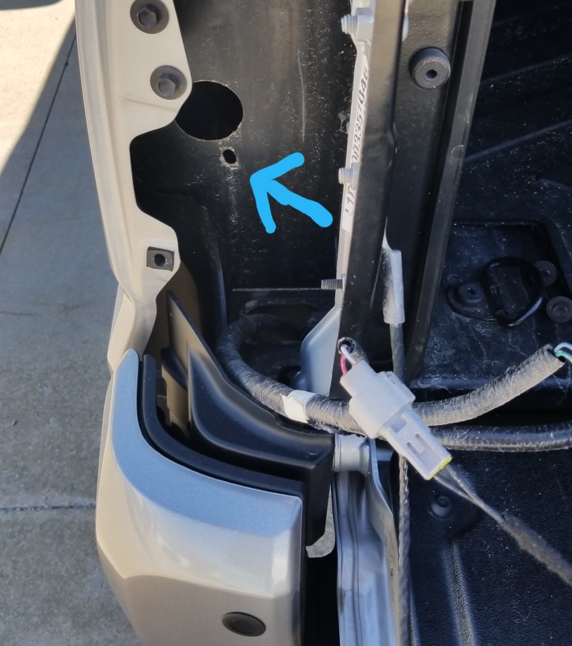

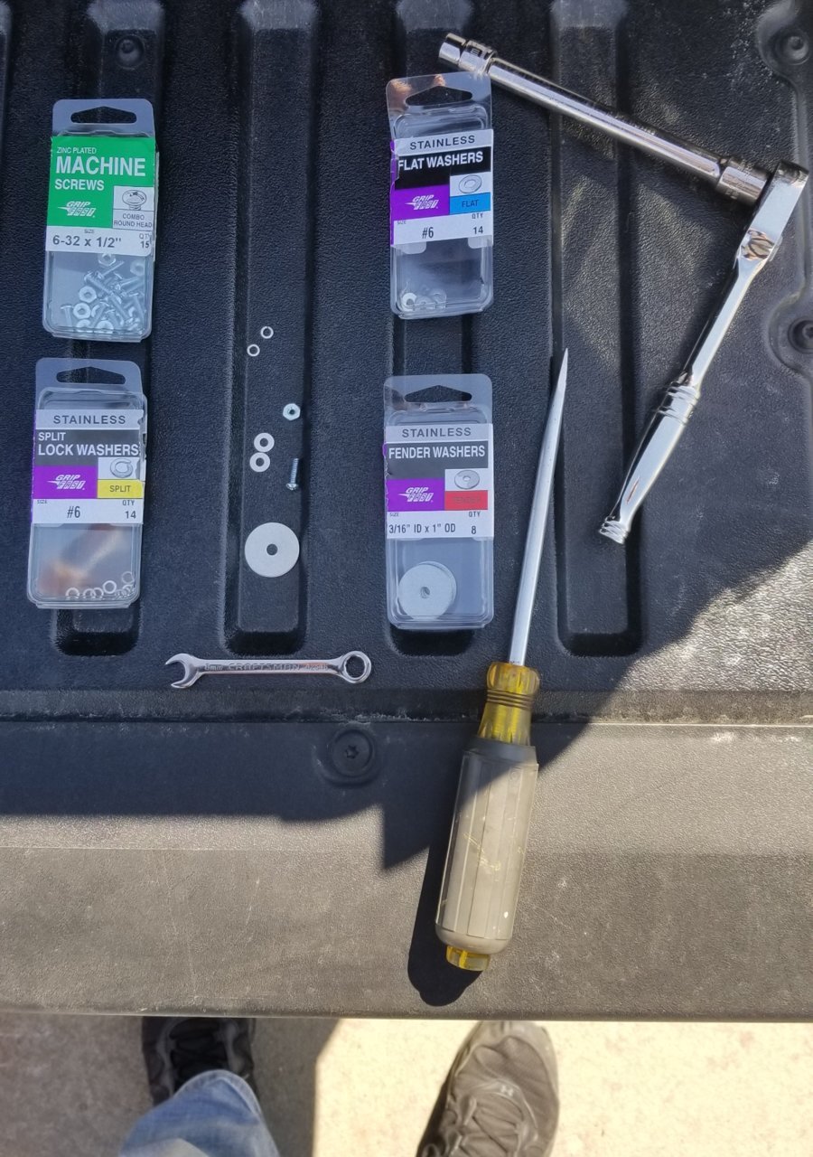

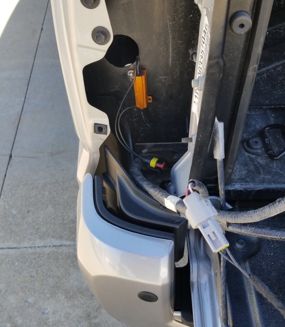

    So today I decided to mount the resistors using a hole already behind the taillights. After hearing that they get hot I thought this would be a good idea since i had them zip tied to the wiring. Probably not an issue at 40° like today but on a 90°+ day the resistor may get hot enough sitting in traffic with the blinker running for a long time.
    Here's what i used
    Here's the hole I used to mount them

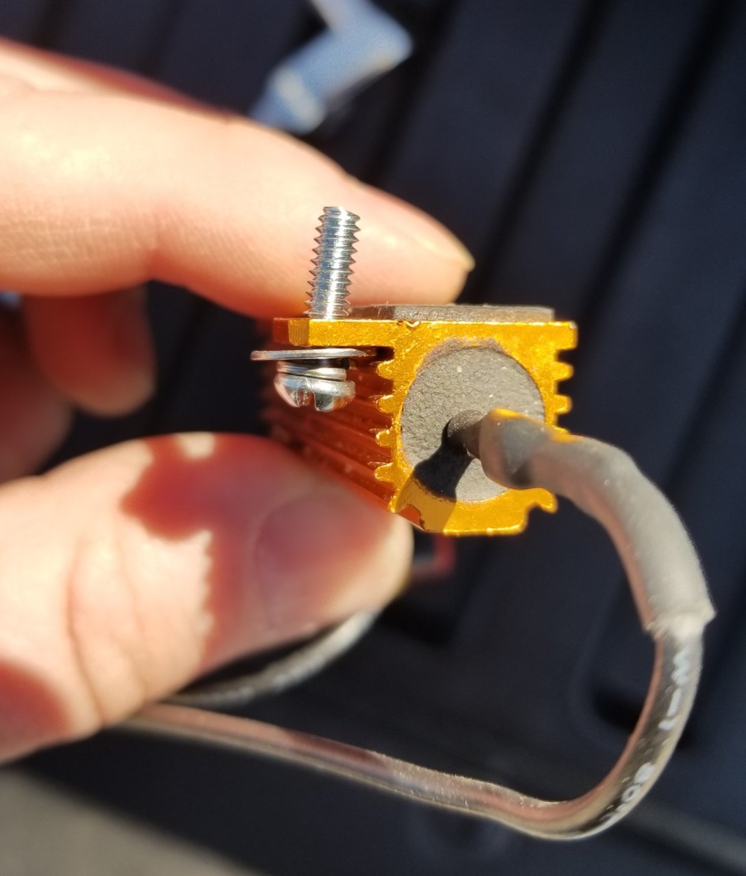

    I used little lock washers with #6 machine screws & larger washers on back side
    From under the truck it's easy to stack on the washers & hold the nut with a small 8mm wrench while tightening up the screws on the other side. I really didn't want to use self tapping screws that would eventually cause rust issues so I went this route & should hold the resistors in place well.
    Hope this helps :thumbsup:
