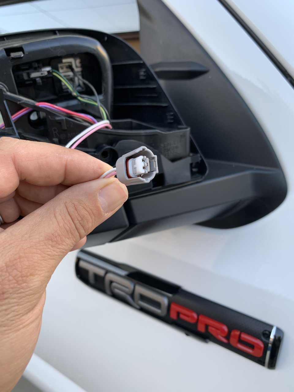

    I installed turning signals the left side was a piece of cake but on the right side I was having trouble with the connector. Wasn’t able to install guys I think I damage the pigs tail plug. I’m not sure what actions I should take. My right side turning signal doesn’t work either front and back. Please advise Tacoma world.

    How did you damage the plug?

    I think Forcing it in.

    front and back? that does not sound right. Check for blown fuses. Always disconnect the battery when working on anything electrical.

    So you tried plugging your stock turn signal back and it’s not working anymore? is the plug “fully seated?”

    Yea bud I did install the stock back on and no luck.

    Try the flashers and if only one side works probably a fuse. Sounds like you may have bent the little wire pins in the turn signal housing. If not too bad you can straighten them with needle nose pliers.

    Since neither the Meso or your stock isn't working, can you put a meter to it & confirm if you're getting power there? Maybe the issue is between the fuse and the signal.

    How do I send pics my friend?

    I wonna show you something

    Yeah I see your picture. So it wasn’t a blown fuse? I’m in LA
