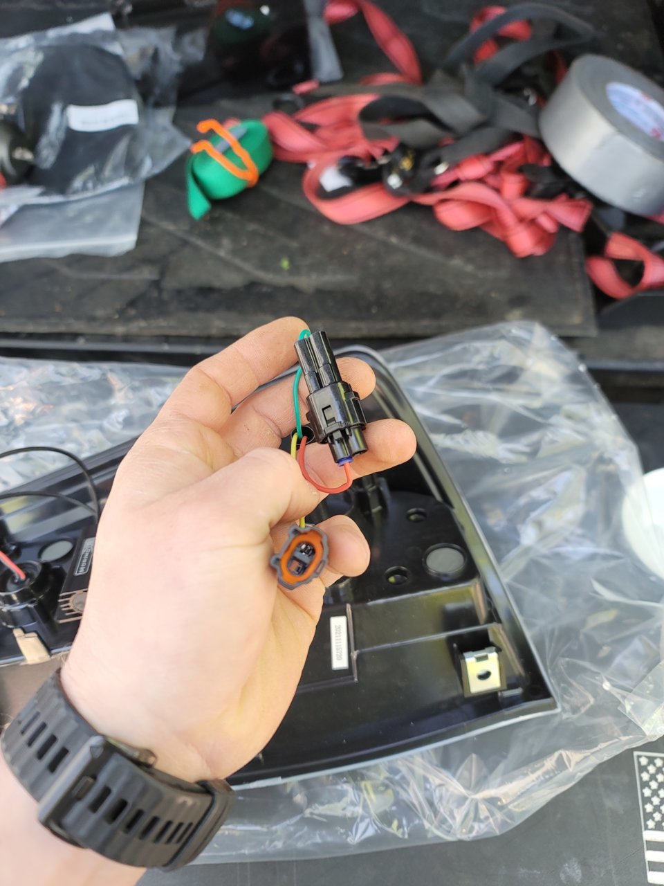

    Does anyone know where this guy plugs in? I have 3 connections coming off the truck and 4 coming off the light.

    I think those plug into each other. They’re basically jumper plugs that select which style of turn signal you want. I think anyway.

    Following. Only the top two connectors even go together for me. Bottom one doesn’t fit plug-n-play on my 2020 OR and that one in your pic I have zero clue what to do with

    I got all three plugged in. I think these might be for the break lights but I have no clue.

    Yeah idk what’s happening but the bottom connector doesn’t plug into what I have on my truck. What year do you have?

    You're right. I switched them and they are for different types of turn signals.

    The 3 connectors from the OEM (truck) side are
    Triangle 3: Brake (blue), Parking Light (green), ground (white w black stripe)
    Straight 3: Turn (Yellow on one side, not sure about the other?), Parking Light (green) and Ground (white w black)
    Straight 2: Reverse (red) and ground (white w black)
    All 3 of the OEM side connectors are female (sockets).
    I don't have a set of these tails but I can try to help more with more photos, I know the OEM connectors a bit too well.

    Yeah the straight 2 is what isn’t plug-n-play for me. I’m about to just strip the connector and tap it into the truck wiring instead

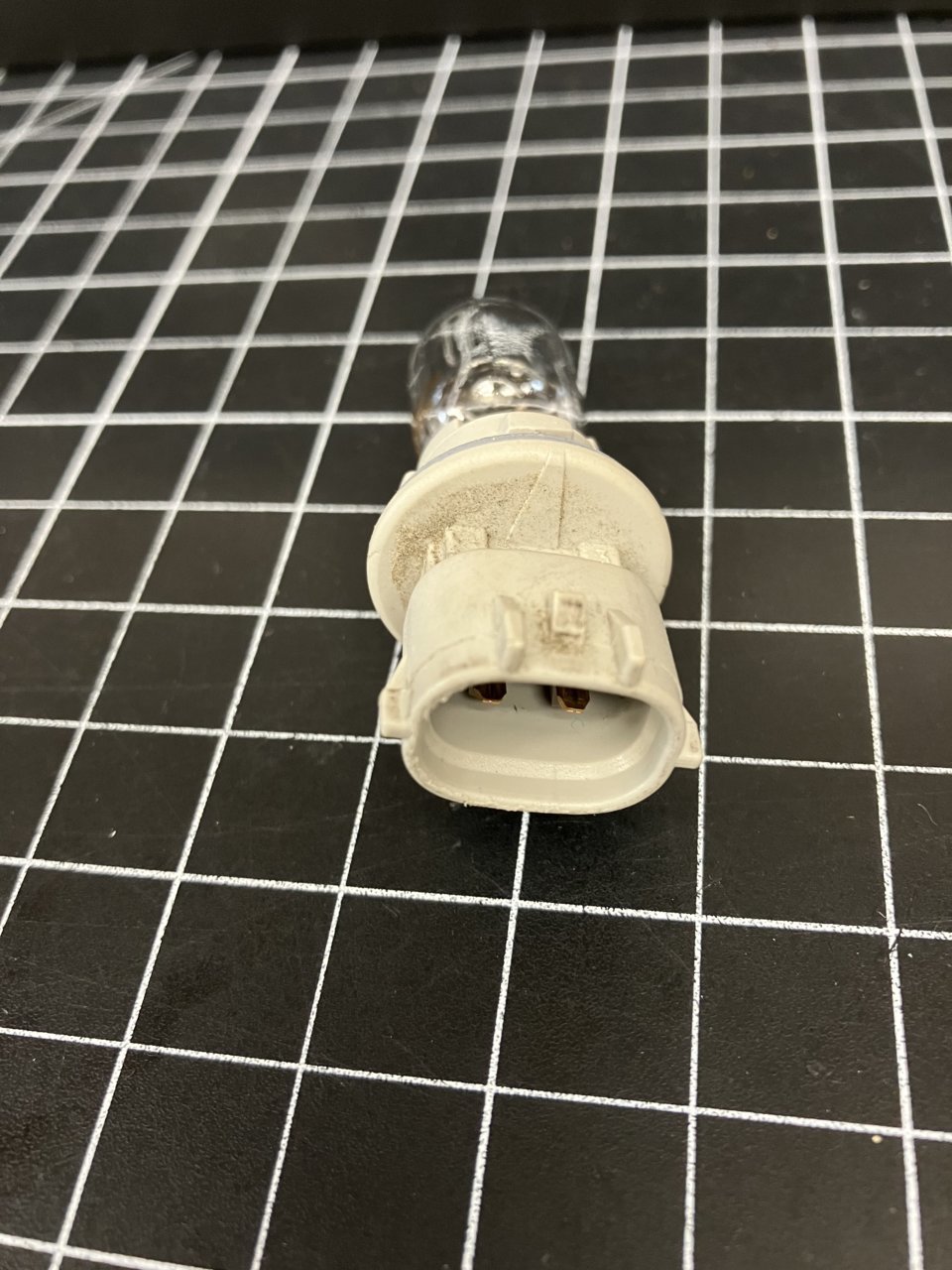

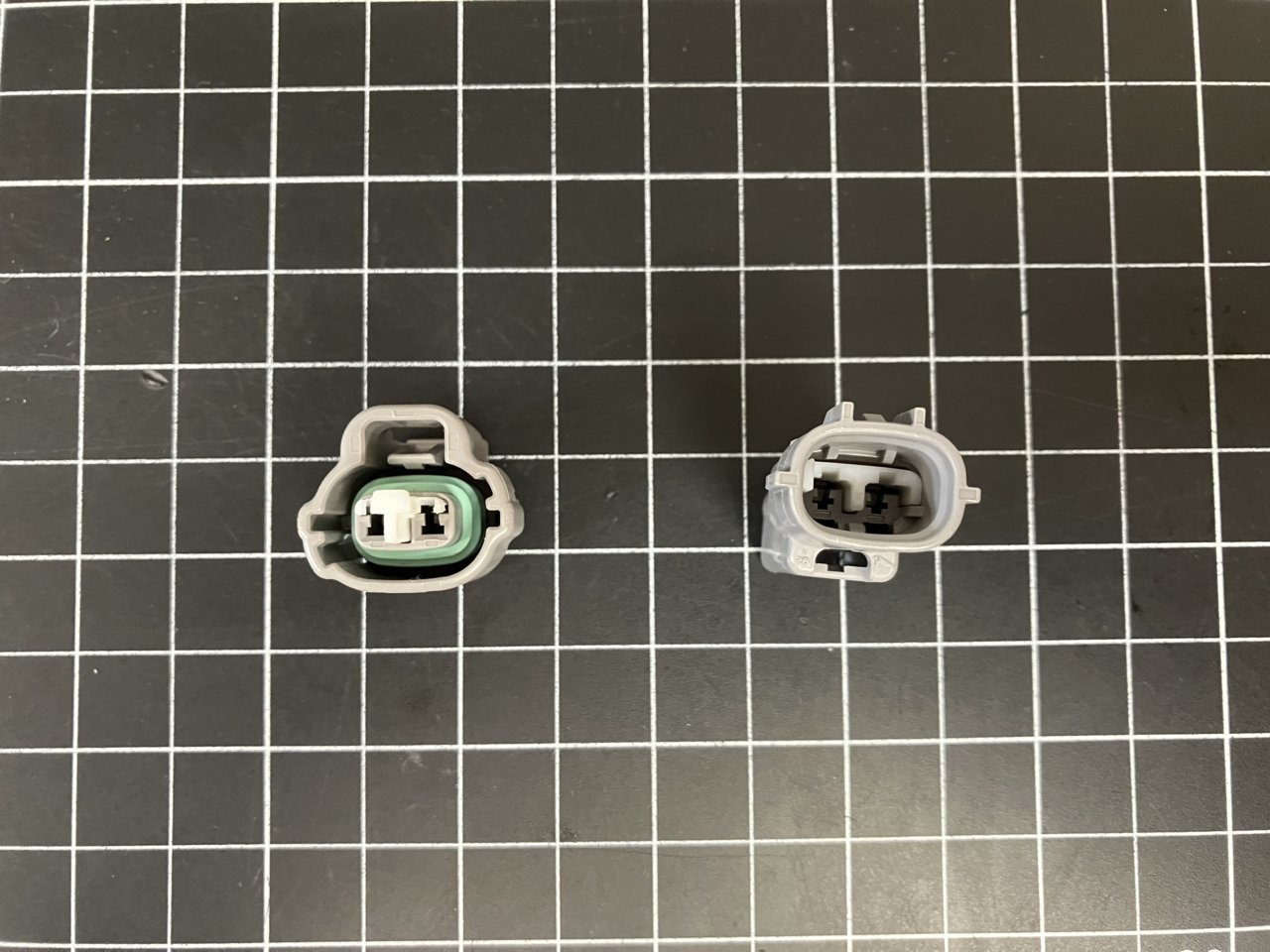

    Photos of the reverse connectors from every truck I’ve ever seen. Female is OEM, male is a bulb from the factory.
    EA7D3085-2D7A-4F55-823D-9B873354D40B.jpg B8348F7F-DFB4-40EE-8D93-3D5D1BF38BC3.jpg

    This plug is for selecting either solid or sequential turn signal.

    The straight 2 took a bit of love to connect for me.
