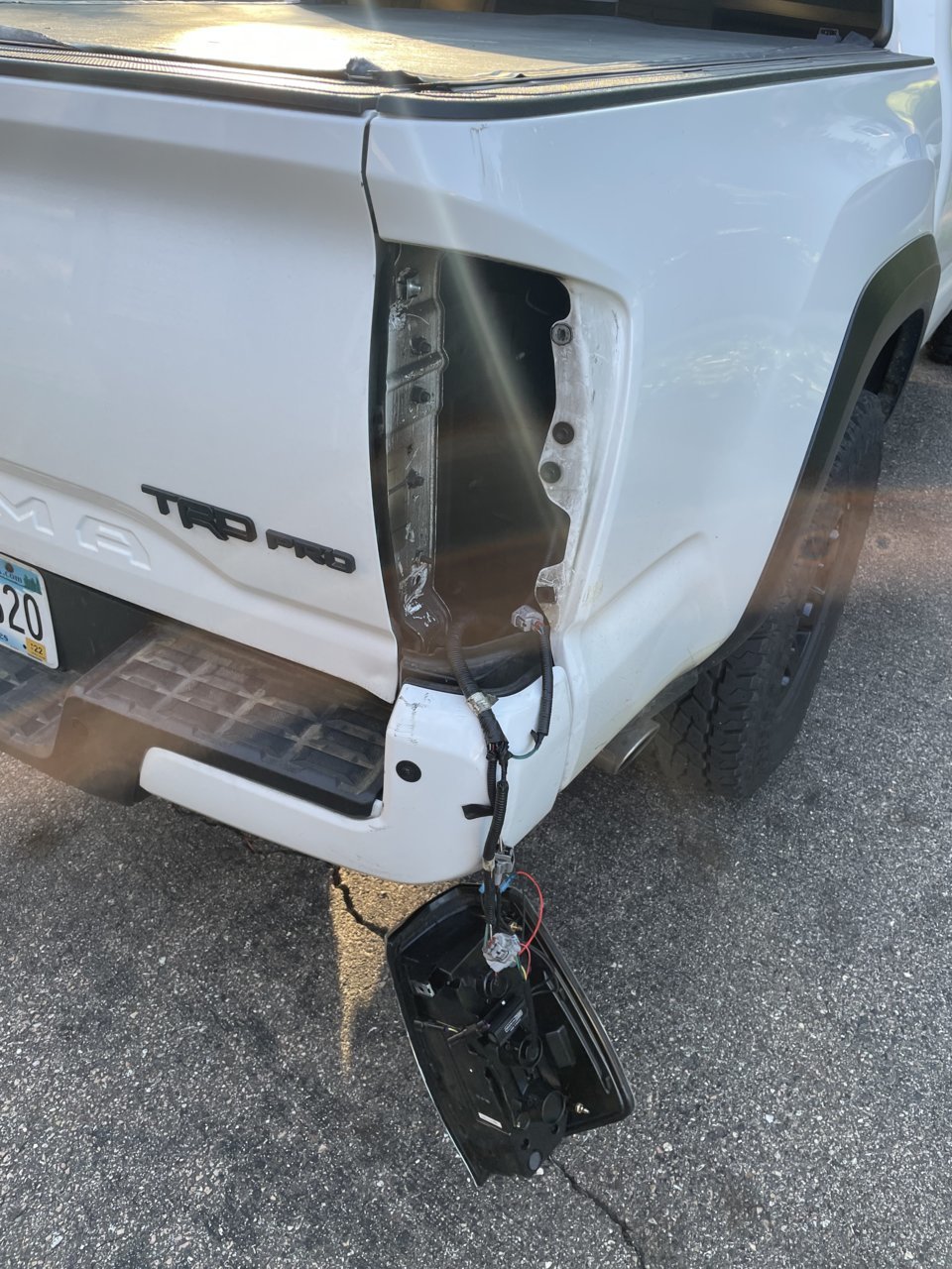

    Didn't get around to checking the passenger light and had to run around the corner yesterday to a gas station to pick up ice real quick..... got there and the passenger light had fallen out. Same snapped tab failure.

    Damn dude that sucks. Meso addressing the issues? I mean they are a first run. I’m assuming that they would offer to fix them or get some monies back?

    Haven't heard back yet but I have high hopes they'll sort me out

    I'm guessing that the damage there on your bumper is from where they fell out also, which is a pretty hard double bummer.

    Fortunately that's just grease that was on my hands.

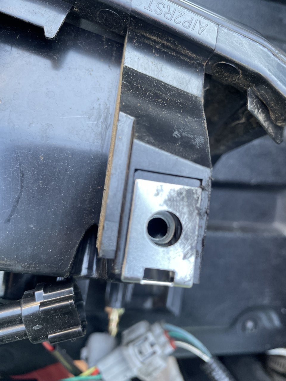

    @doublethebass, do you think this could have contributed to the failure? Looks like the bottom screw never actually threaded in...

    I thought that too, but it actually stripped on on that bottom screw. Kinda hard to tell in this pic.

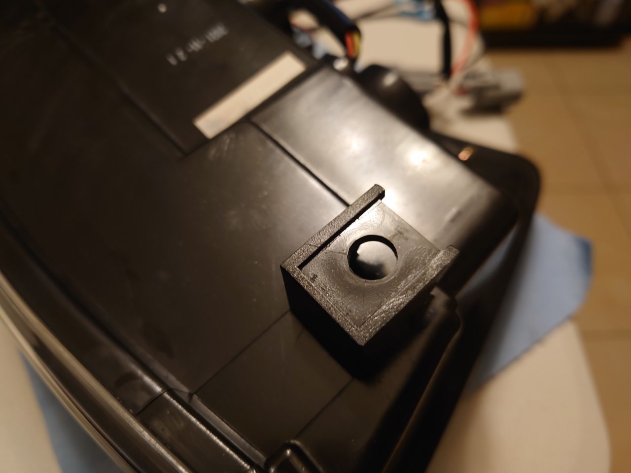

    I took my passenger out so it won't dangle and scrape against the bumper cap. Which happened on my Driver side, leaving gouges in the paint.

    How was the condition of the top post? Was it like a clean break? I personally feel that the plastic is a little too hard that it is brittle, mine basically disintegrated into pieces.

    One of mine was a clean break and the rest kind of shattered.

    The tails have been a great product. There were a few quirks on the very first run, But we are getting everything ironed out. Nothing is perfect, and that's what evolution and improvement are all about. Some minor changes for next production;
    1)Packaging. The stryofoam they were packed in was too thin. Luckily we caught it after some shipping damages and started double boxing them. But next they will be packaged a little more beefier.
    2) Turn signal output is being increased. The amber output was pretty good before..But I wanted more. Worked on it with morimoto and it's about double the output now.
    3)Mold modifications. Little plastic tabs on the back that served no purpose other than breaking off will be removed. Along with a few other tweaks but you will not notice them from the outside.
