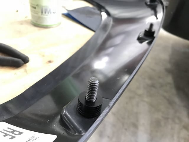

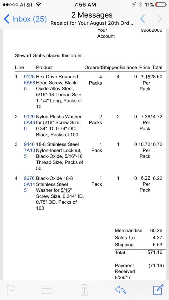

    Wanting to hard-mount my Bushwackers as well. Where did you get the hardware to do it? cant find anything with a large enough head...

    Here’s a list of hardware from McMaster. Warning: don’t get black oxide like I did.. use same bolt specs but get stainless. Mine started to rust after a month.
    Also, the nylon spacers are needs to close the gap between flare and fender like this
