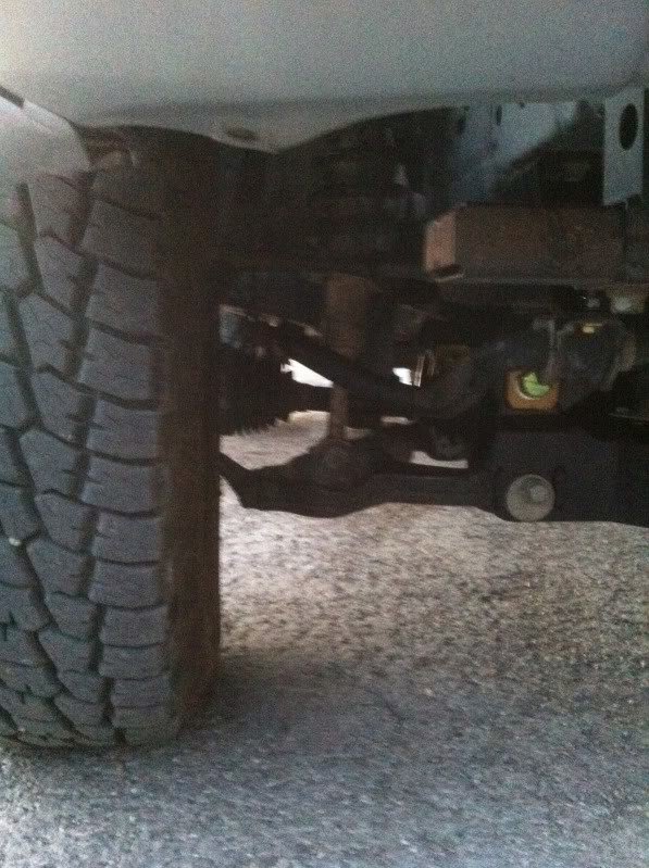

    had my 6'' procomp lift installed today and im positive they did it wrong!!!the installer told me that i didnt need the coil spring spacer or the spring isolator because i had aftermarket pro comp shocks but im pretty sure he was wrong this is what it looks like let me know what yall think.

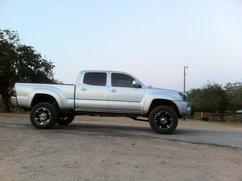

    front looks low..looks like a 3in lift kinda

    I know it looks bigger in person but it pisses me off

    that definetly doesn't look right, and the minute any shop told me " you don't need a coil spacer" or anything that came with the kit. i would be taking my truck to another shop. I hope you get that resolved fast with no problems.

    Do the aftermarket shocks add lift up front like the 5100s do at different settings?

    take it back and tell them to put the damn spacer on...they're just too lazy to use a spring compressor :rolleyes:

    I'm tempted to not even take it back there and just rent the spring compresser at autozone and fix it myself.. I'm so pissed at that place right now it's prolly not a good idea that I go back there

    No I just added the procomp shocks when I bought my truck cause the oem ones seemed shot

    Okay just making sure. From the pics it looks like either the LCAs are in line with the bracket or they are slightly going upwards. I'm pretty sure the LCAs should be in line with the bracket or slightly going downwards. I'm not completely familiar with the procomp lifts though.

    what size tires r those? either way, it doesnt look right. Ur axles should be angled down, not up

    285/65/18.... I should of never takin my truck there just thinking about this makes me sick to my stomach

    Hate to sound dumb but what do u mean the alignment cams are upside down

    This is a pic from the driver's side of another tacoma
