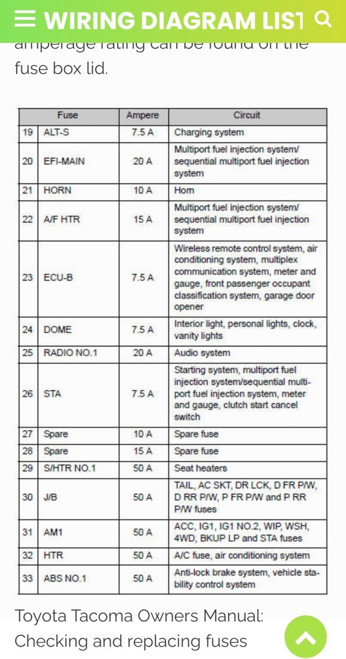

    I was changing my interior lights to LED ones and now none of my lights are working. They were just a few minutes ago til I tried changing the back one. What have I done?!

    Probably did. Didn’t think about that from it just working. The manual tell me which one?

    I think so. Didn’t think about it till someone mentioned it. Already found the fuse box & which one to change out lol

    Did this on my last vehicle. None of the interior lights turned on after. Was just a fuse, swapped it with a spare that was already in the box and everything worked fine.
    Fuse could be in the engine bay or the interior fuse box. Finding out which one will be the most trouble, but not too bad.
