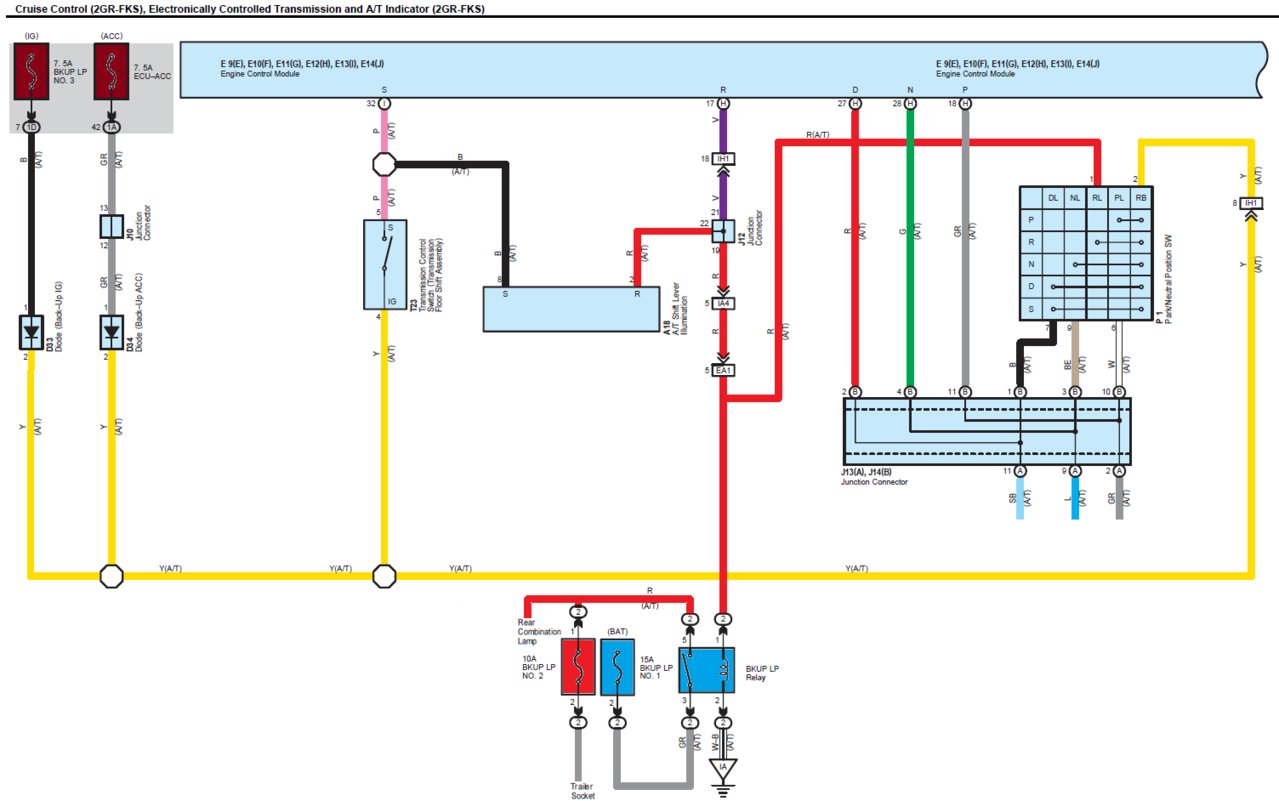

    It's not thus my friend. It's poor design :annoyed:
    Unlimited assets and can run a separate circuit for dash and trans communications is perhaps lazy

    You don't run an entire circuit dedicated to 2 simple switches. More cost, but more importantly that many more pieces/parts to fail.
    Cant speculate why they chose to use that particular ckt, but it seems to work for at least 99.9% of these trucks on the road.

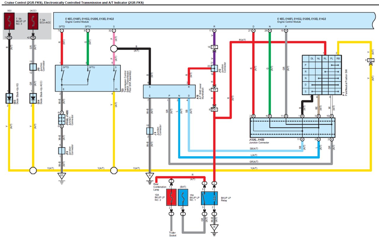

    it was in the service manual. that's how we figured it out.

    In my world you do, but I work on other electrical systems.
    Costs and stuff above aren't thought about, it is what has to be done to be right, even if more parts are required.

    Anyone willing to remove the same fuse out of their 3rd gen to see what happens out of curiosity? Lol.... Same result?

    Wonder what engineer labeled that fuse "backup lamp" as it does crazy things to the tranny.
    I can see the prnd light not lighting but not the mechanical issues.
    Lesson learned check all fuses when having an issue and don't rely on labeling.

    But it didn’t cause mechanical issues. When the ECM does not know the gearshift position, due to no inputs from the range sensor, it does not operate the shift solenoids in the transmission valve body as needed for smooth shifts. But it will still shift, albeit harshly and likely limited to 4th gear.
    It’s not just a 3rd gen thing either. Pull the same fuse out of a first gen with an auto and give it a whirl.

    " it does not operate the shift solenoids in the transmission valve body as needed for smooth shifts. But it will still shift, albeit harshly and likely limited to 4th gear."
    I would at first think that is a mechanical issue and not a fuse.
    Had a Jeep with a tranny mechanically going out and acted just like that. Dropped the pan and shavings all over.

    It was a figure of speech. Yes I did see it in the diagram.
