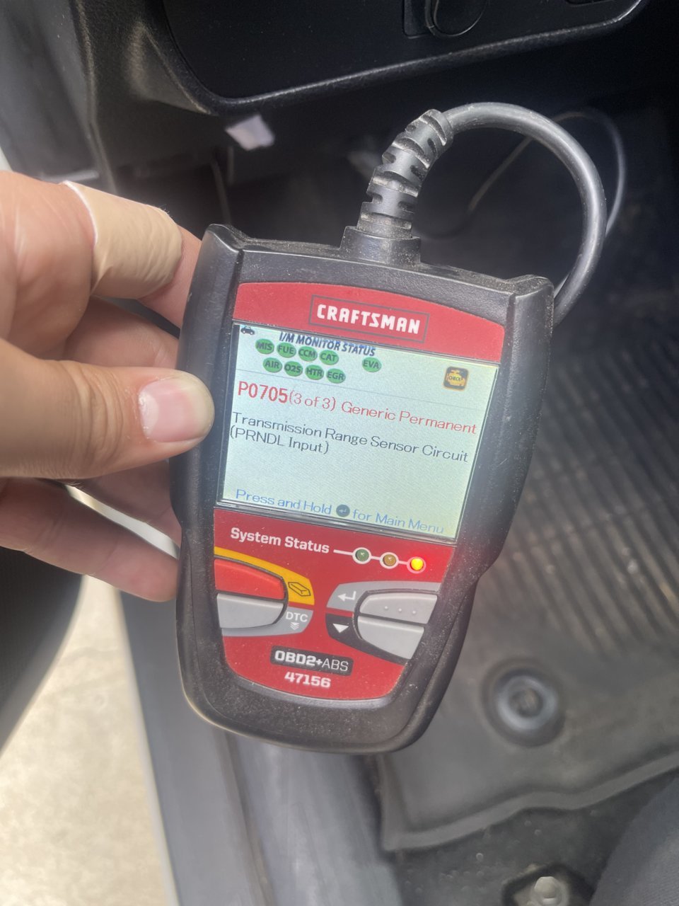

    Yes. After some research im starting to think its just the sensor. I guess one of the symptoms was also a jolt from P to R. Which is what im experiencing

    Your code reader says "3 of 3"...
    What are the other two?

    Just noticed that too, and was wondering if there was and arrow or scroll buttons on the code reader to scroll to the first two code pops.

    It's a generic code reader.
    I could see popping two P0705xx codes for the transmission range sensor, but three...?
    A Toyota specific reader would appear as P070513 or P070562.

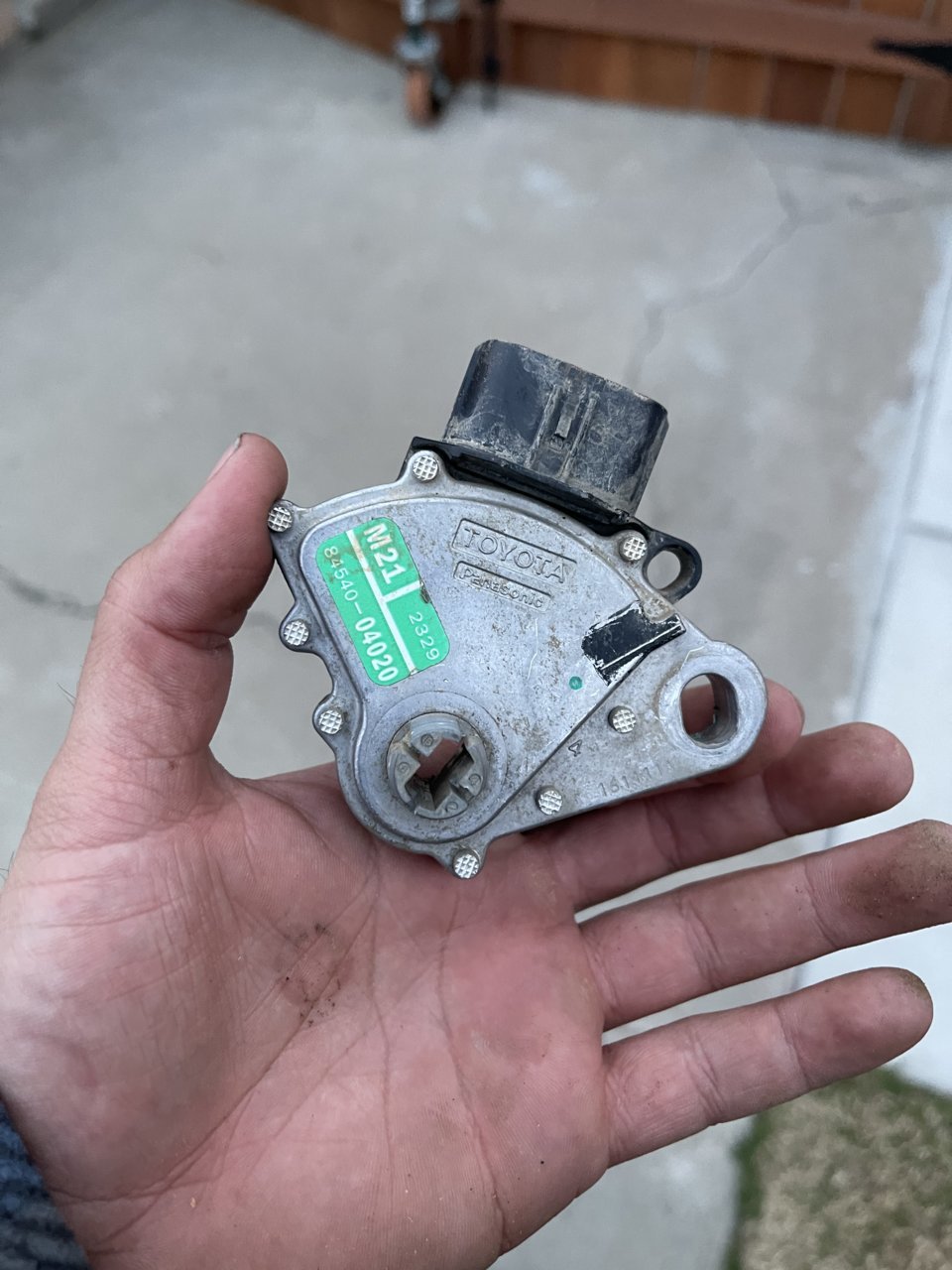

  15. Feb 11, 2023 at 6:18 PM
    #55
    LilTexan22
    LilTexan22 [OP] Well-Known Member
    May 30, 2017
    #220272
    1,136
    2017 Tacoma
    Well i got the sensor out. It was a pain in the ass to remove but hopefully when the new part comes in it solves the issue.

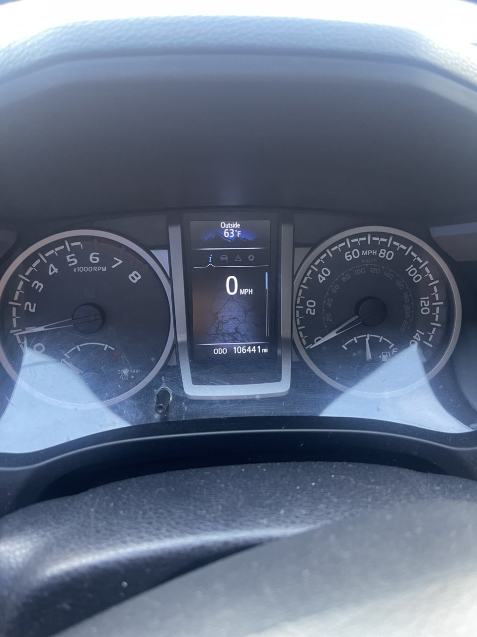

    I also noticed my PRND indicator on the dash screen is gone. Also a symptom from this sensor i guess. It only shows the mileage. I appreciate the help from everyone.
