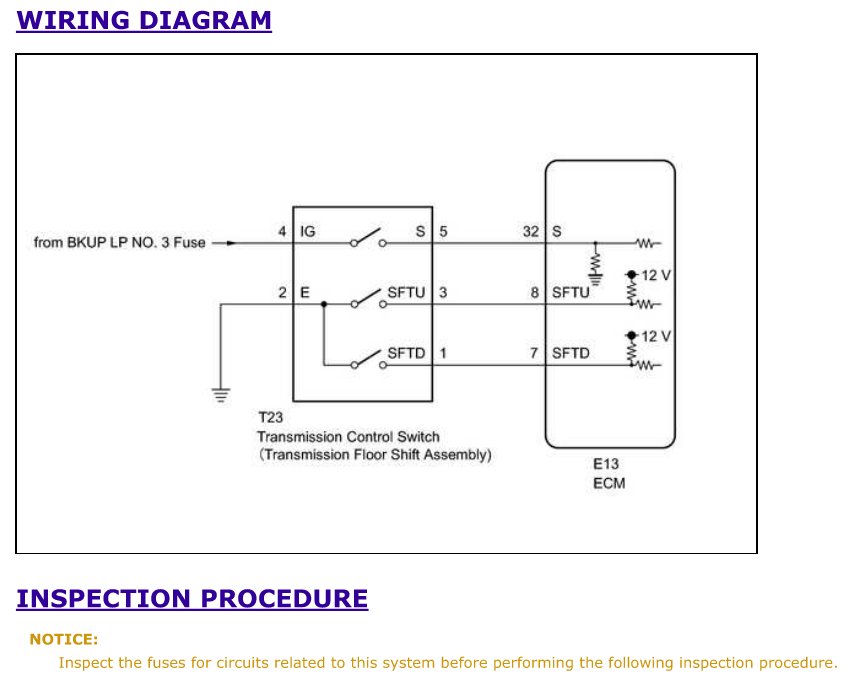

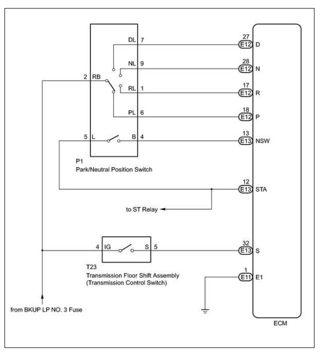

    Have you checked fuses? I can’t remember if the back-up fuse is the only source to the range sensor, or if there is another. Maybe someone can post a wiring diagram. Or turn the key on, and test all fuses in both fuse boxes (under hood and in dash left side) with a test light using this method:

    this guy had the same issue and it ended up being a fuse for the backup lights i think
    https://www.tundratalk.net/threads/p0705-transmission-range-sensor-malfunction-code.233177/
    "Thought I would write that in case anyone else comes up with that code. Check to make sure anything connected to your reverse lights and if you have a camera (mine is on the rear view mirror) make sure it is working. They all get signals from the park/neutral switch. More than likely the fuse is blown."
    the fuse is located in the cab by your feet.

    Well shit that makes sense. Kind of. If the fuse was blown obviously there would be no power from that point fwd. But it does provide a direction to start as that seems to feed both shift switches

    That tidbit makes things even more puzzling because they work and then don’t, but a piece of the puzzle for sure. Check if there is a circuit breaker instead of a fuse in the back-up slot.
    It may well be a corroded connector or wire too.
    100% the electrical fault needs to be fixed here first. It may well be the only issue. Your transmission symptoms are consistent with what happens when an electronically controlled transmission is operating in fail-safe mode as only a hydraulic / mechanical transmission.

    Service manual calls for inspection of the floor switch, park/neutral switch and the harness. May need to replace some parts, including ECM.
    Take it to the dealer..
