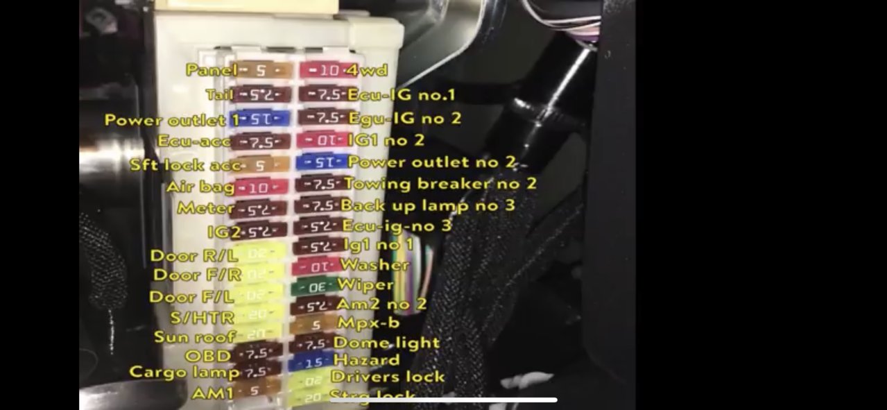

    A big thank you! I got off work and was driving to the Toyota Dealer to drop off the truck. Remembered what you guys were saying about the fuses so i pulled over in some random parking lot and thought id check before i go. I started pulling fuses under the dash and found a broken one. Plugged the spare fuse in started the truck and everything worked again! All the shifts are smooth now. Check engine light gone. Doesnt shift hard into reverse anymore. Crazy that a fuse was causing my hard shifts

    It ended up being Back up lamp no 3 fuse

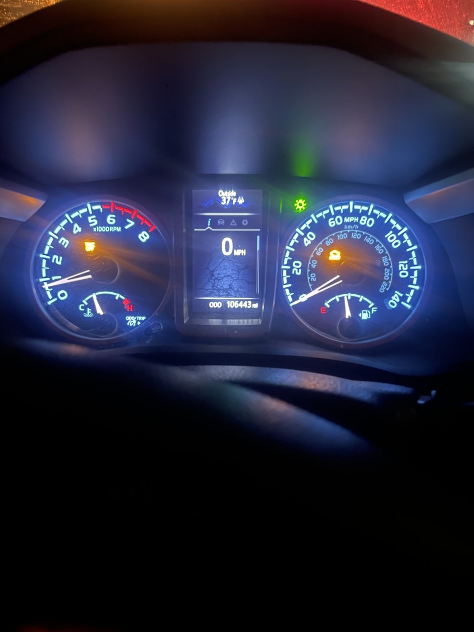

    This was a photo i took on my drive to work this morning before I fixed it.

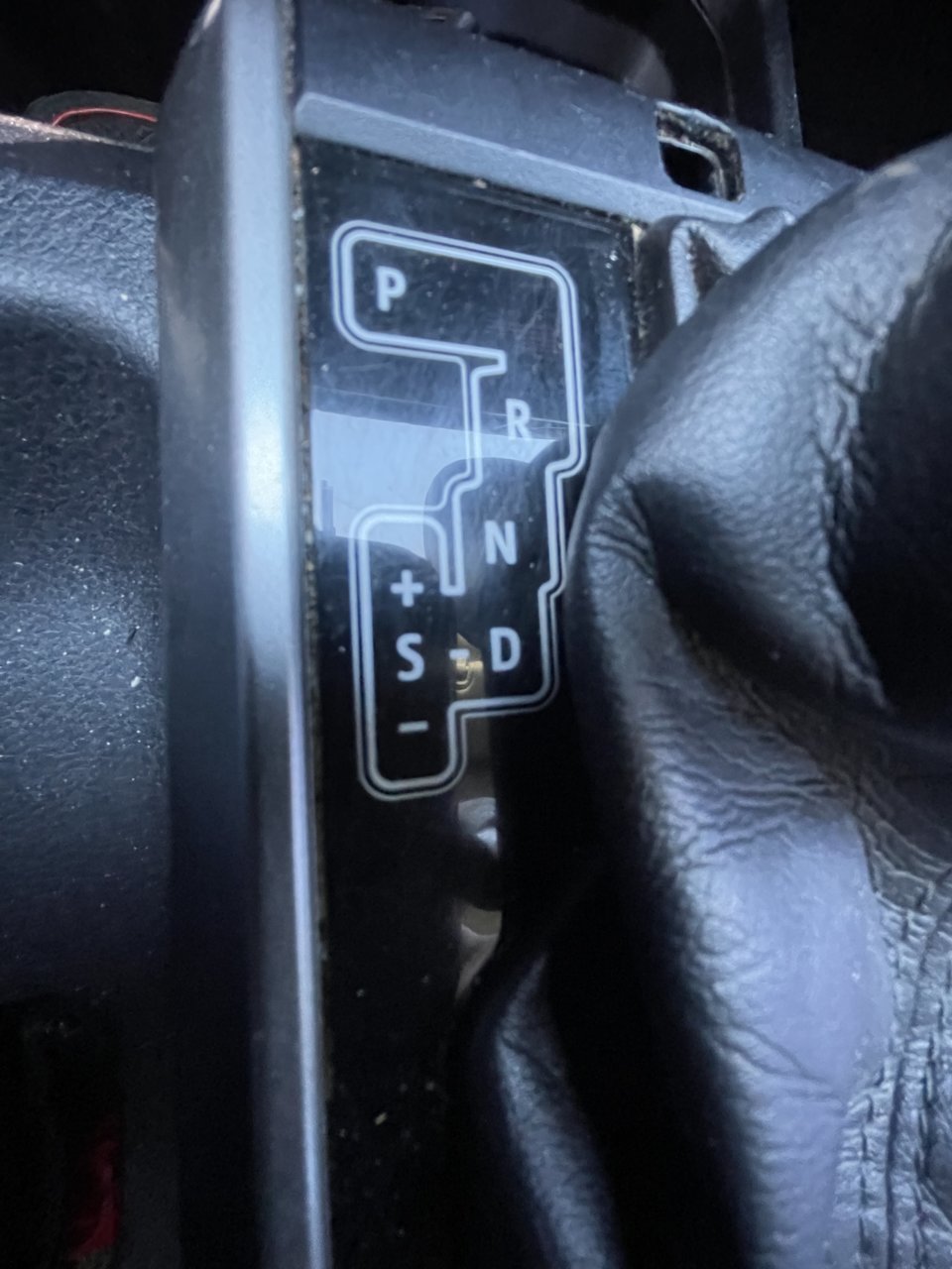

    8A5AC7EA-B6DE-4644-BAB6-52E662307EE7.jpgThe lights on the shifter werent even working before
