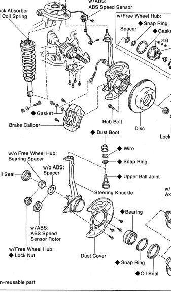

    This is how it's suppose to go together. Auto hub. Bottom of pic.
