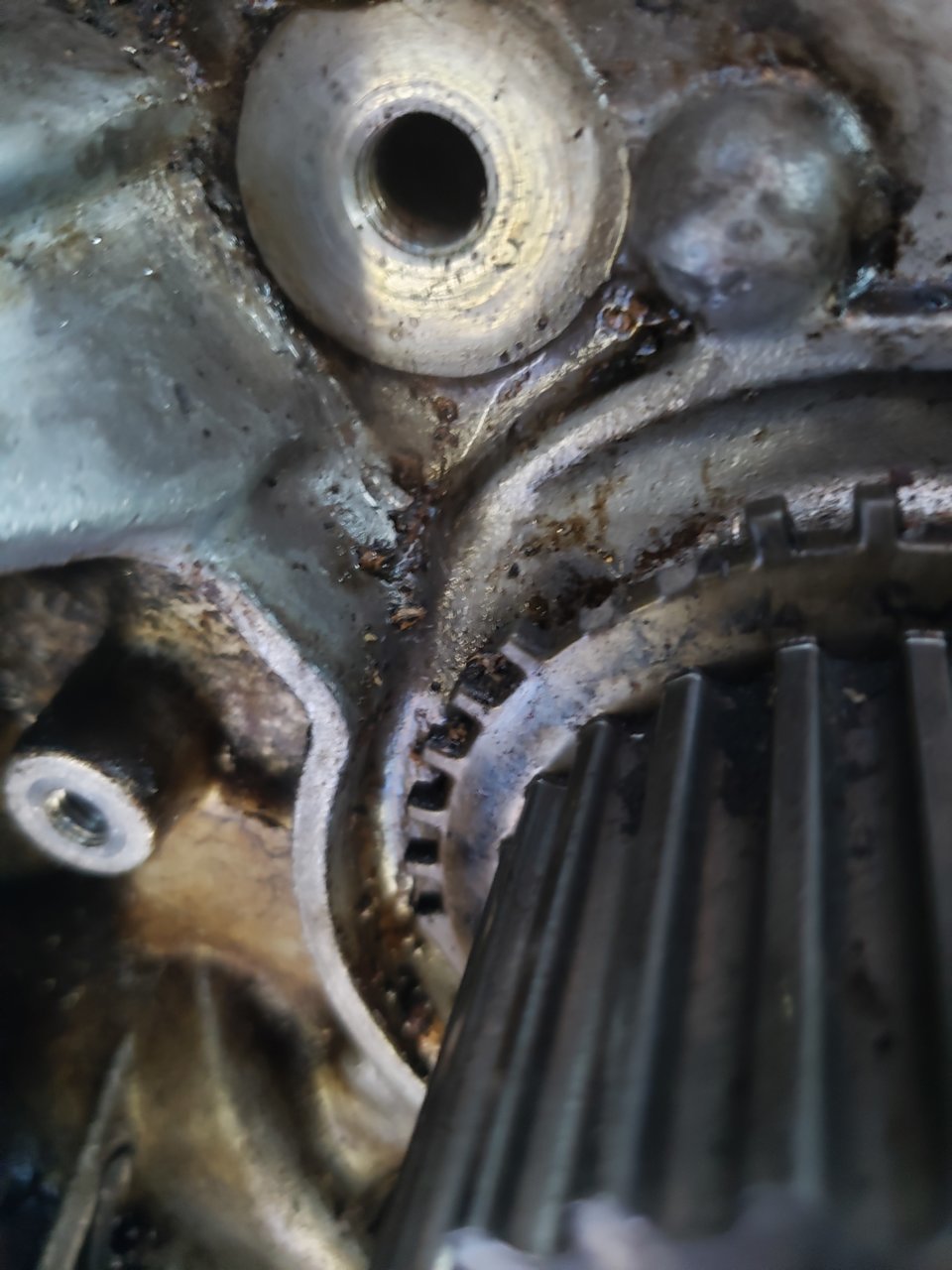

    How bad did I mess up by breaking these two teeth?

    I cant get it off, it how I broke It. An recommendations? Every video I hav seen but hey should just slide off

    You will need a puller. Autozone or Orielly's will loan you one.

    And I guessing it wont run right because of the cam sensor being off.

    Make a run to a local Toyota shop to see f they or any surrounding dealerships have one.
    Part# 13521-62031

    Well, I did get the pulley off and the seals all done along with most of it put back together. I just need the pulley, belt, and balancer all on. Once I get that part I should be done quickly. Thank you again.

    Local salvage yard had one for $25. Luckily I got there as they were pulling it off and stopped him from using a srew driver to pry it off lol. I am back in business. I'm about to put on all new belts and hoses the I should be done.

    All back together with all new belts, seals and tensioner. Plus I replaced the radiator hoses and flushed it. Next weekend ill do the valve covers, spark plugs and spark plug wires.
