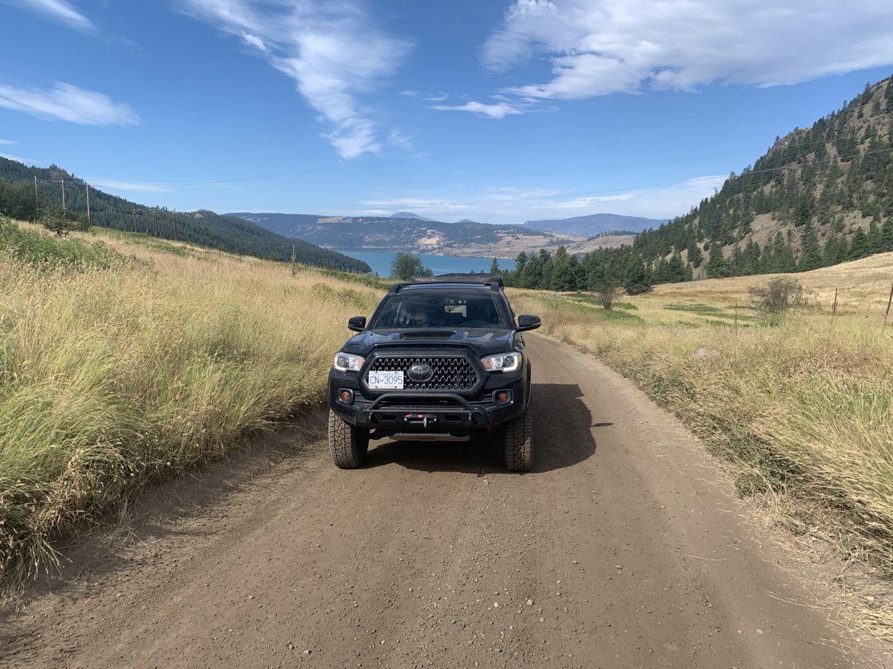

    I do have an aluminum stump bumper that weighs about 45 pounds, I’m on 887s. The front dropped maybe about 3/16s-1/4” . I also installed a winch and steel sliders at the same time. Running 255/80/17s as well. I think you will be just fine with just the steel stump bumper.
    Hope that helps.

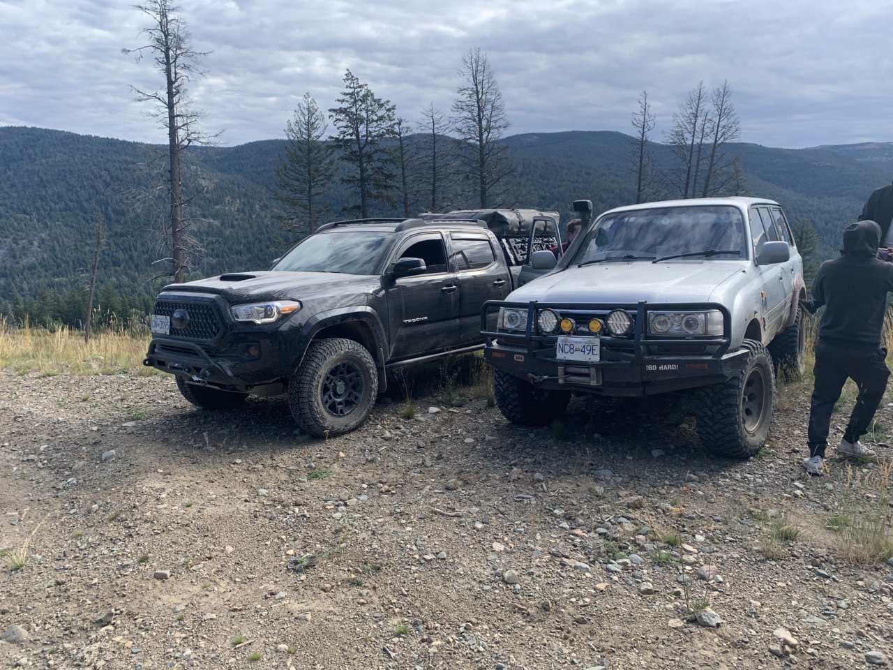

    Pretty sure @Stocklocker is running 888s, winch and steel stump bumper.

    It dropped about 3/16s or so once I installed bumper, winch and sliders. Front of truck looks the same as before to me.
    I honestly don’t think you will notice anything with just the bumper. 887s are for stock or light loads so you will be just fine.

    Yes I am. Works great. Sagged about 1/2” in the 1st year and went up one notch and is now stable and good.

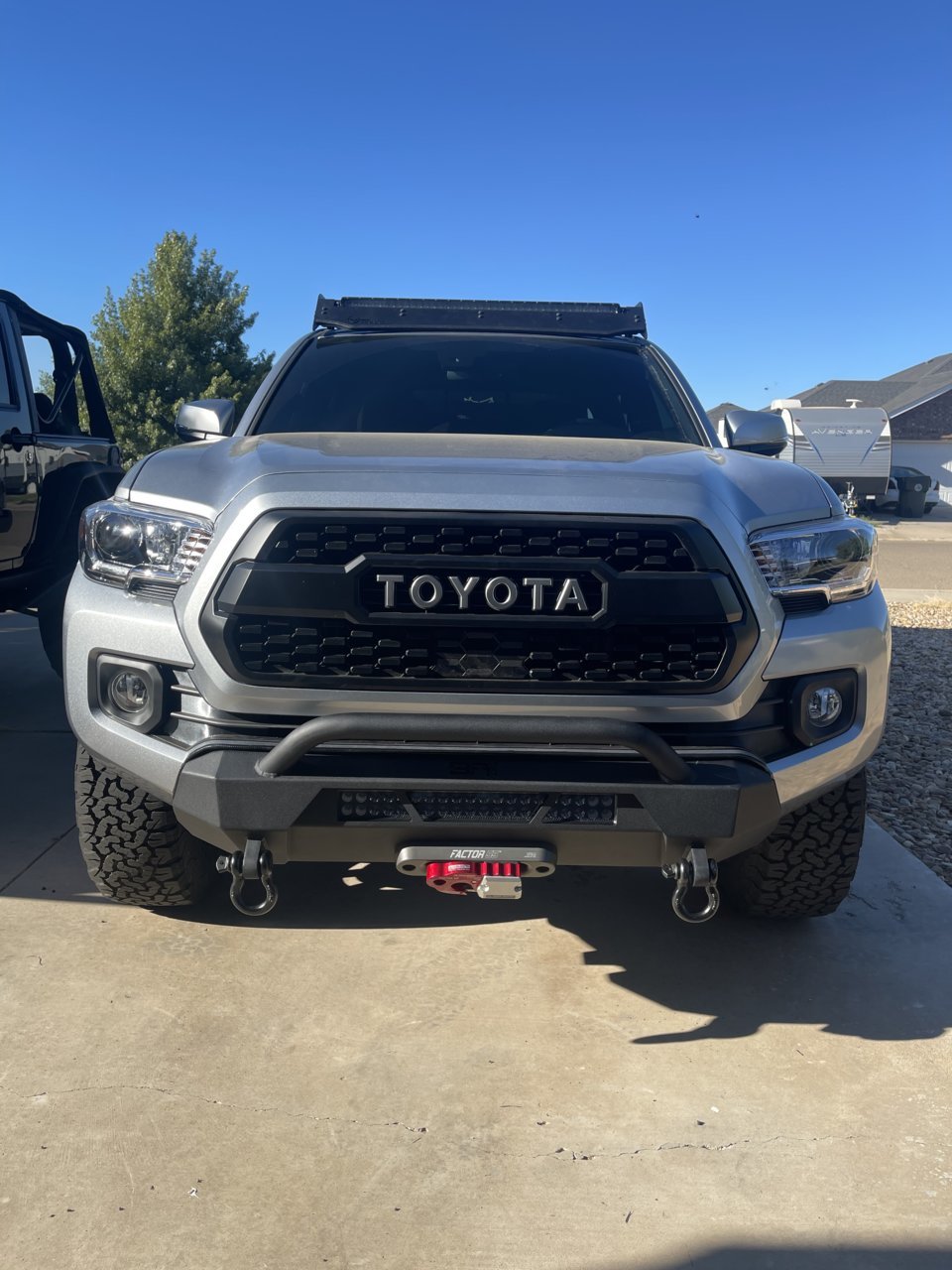

    I just put an ARB bumper (no winch) on my 2nd gen access cab with 887s on nitrochargers, and really no sag so far, but it's only been on there for a week or so. The truck definitely rides much better with it on than it did before, though
