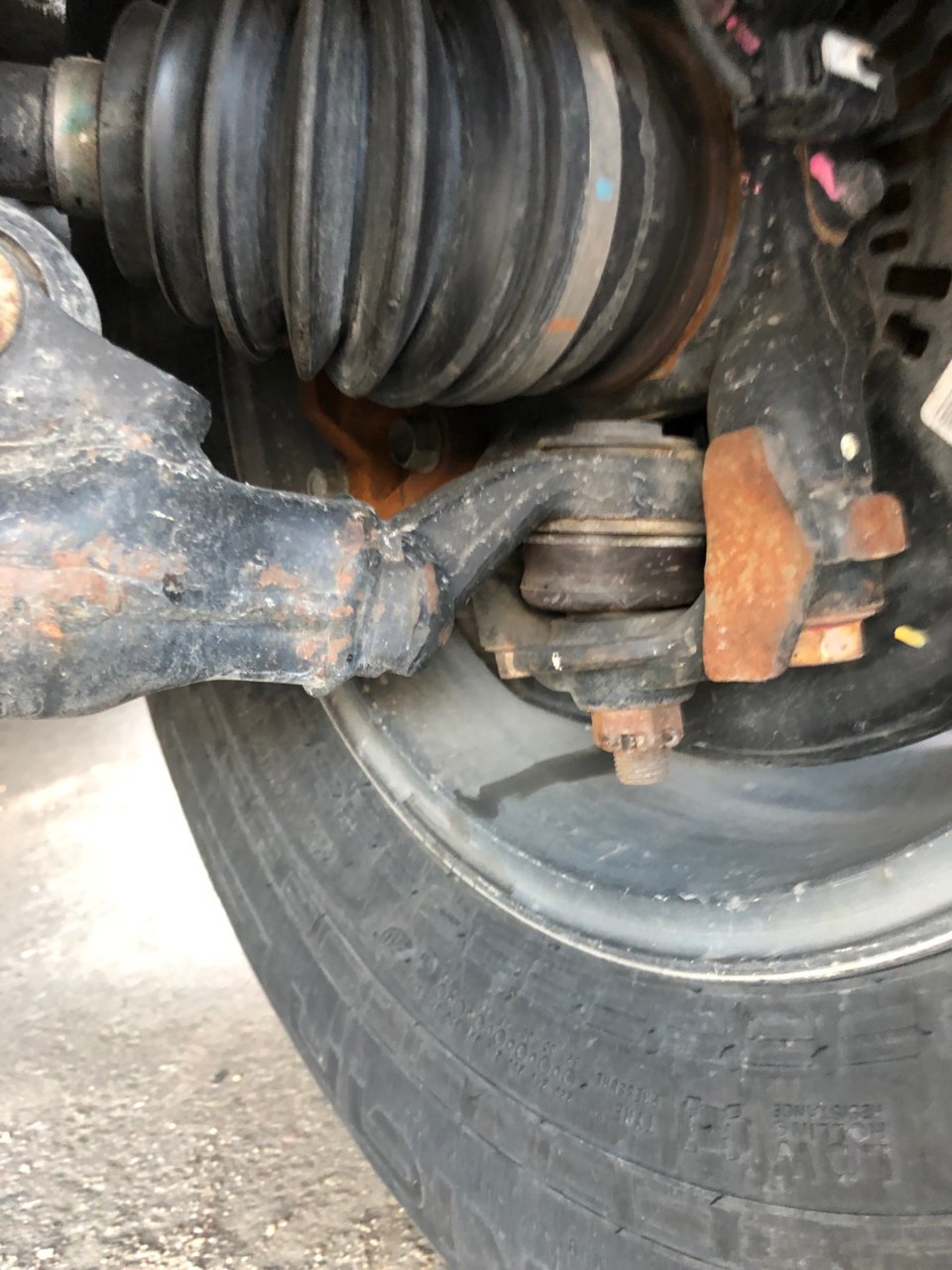

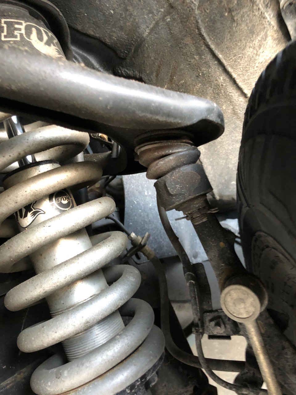

    So I've got 2018 Tacoma with 36,000+ miles, there is Fox 2.0., with 1" lift installed right away after purchasing the truck. I have this metal clunk (can hear in the video) for the past 30,000+ miles, finally I decided to find the cause... :anonymous:
    So the metal clunk appears when I turn wheels stationary, moving slowly or breaking from super low speeds, also when hitting pot holes at low speeds. I think this could be steering related, as the clunk appears the most notable when I steer the wheel. I lifted the front wheels and the clunk is gone when I turn the wheels.
    I checked CVs, steering rods, steering rack, ball joints, wheel bearings and nothing seems to be loose and looks visually good for a one year old truck. Any advise about where to look or what else to check will be appreciated, or should I just continue cranking the radio up? :rockband:

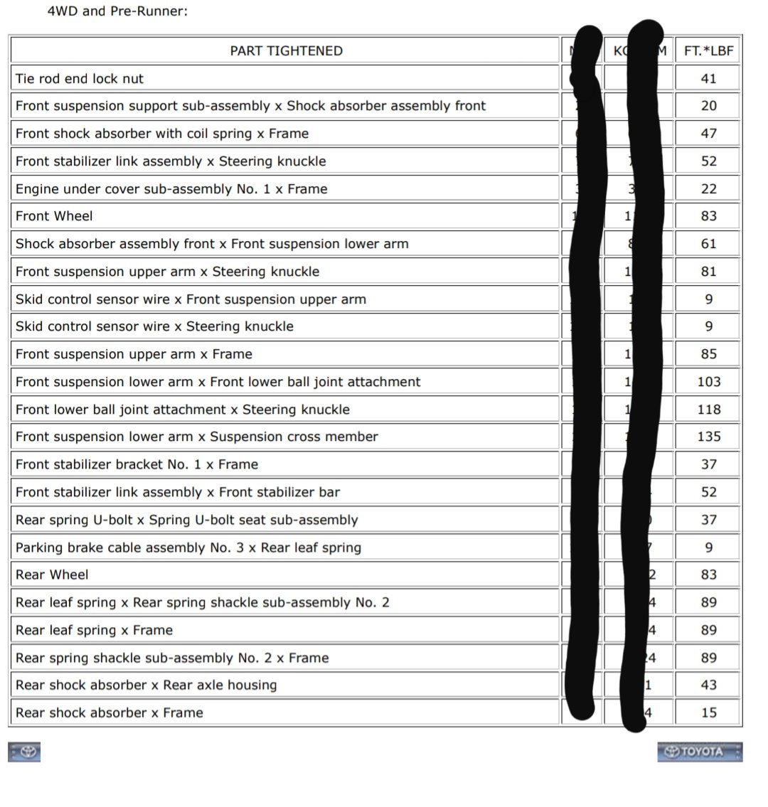

    So next time when I have a moment I will:
    1. check the steering rack bushings and torque the bolts
    2. re-torque the lower arms
  12. Apr 24, 2019 at 4:04 AM
    304_Taco
    304_Taco Well-Known Member
    Aug 8, 2017
    #226250
    962
    Curtis
    Morgantown, WV
    16 TRD Sport DCSB MT
    @Norilsk this is from the 2016 service manual

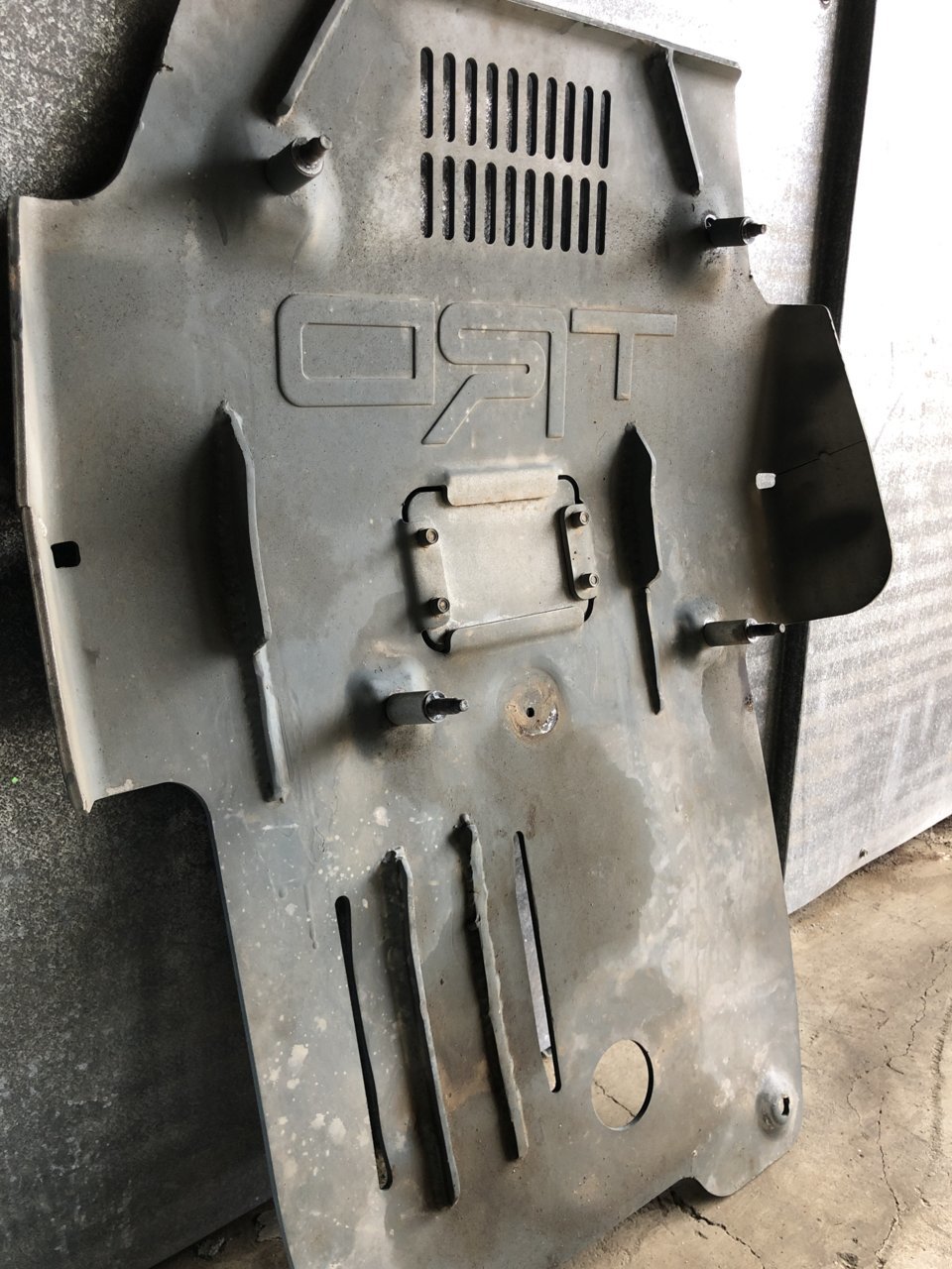

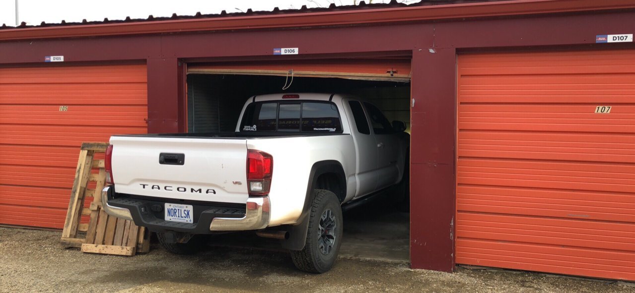

    Update:
    oh boy, working out of storage unit is not fun :anonymous: anyways, everything got checked for torque and everything was properly torqued.
    I then removed TRD pro skid plate, and the clunk is gone at turns or any kind of slow driving. So I would guess something was rubbing against it, but I don’t see any markings :notsure:
    so for now I would blame on the skid, it is been reinforced at few points so it is most likely to rub along those lines:sadviolin:

  14. Apr 26, 2019 at 5:42 PM
    Bastek
    Bastek Average Member
    Jun 6, 2017
    #220876
    4,305
    Seb
    SI NY
    '17 OR dcsb
    KDMaxP10, plastidip
    If you look in the middle where skid touches the lift/jack point (whatever it's called) it seems it rubbs over there. Frame flexing and rubbs skid across that part. Try putting some kind of isolator between them. Maybe some rubber?
