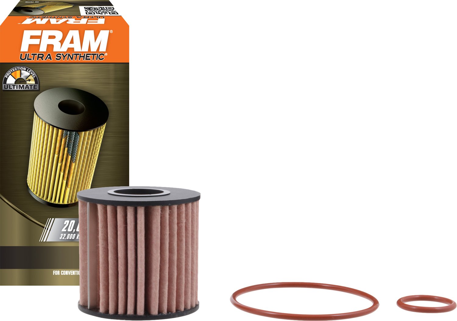

    I did notice the FRAM XG9972 uses a plastic topper which adds a tiny bit of height compared to the OEM which was filter media. Does that cause an issue don't know. But Amazon reports good reviews on the 3.5 Siena engine same setup as our 2GRE FKS

    People have been bagging on Fram canister filters for years....with or without good reasons. But the cartridge filters are a different story. You can actually see the media and the construction of the filter. Absolutely nothing wrong with the Fram cartridge filters.

    As you can see the plastic top differs from Toyota OEM.

    They all differ a bit from brand to brand and even within the same brands. But don't fret over it. I use the TG which has an even thicker top portion. No issues.

    Sweet. Sounds like you have a bit more experience with the XG9972 than I do. Truth be told it was my first filter type other than doing canisters for years. Pretty bizarre experience. I made sure both filters fit into the housing. Seemed like the Toyota filled it width wise a bit more. But the FRAM XG9972 fit in and was virtually the same height as the Toyota OEM. I thought maybe the plastic top would cause an issue. But your personal testimony says otherwise.

    I'll also add....I actually like that the Frams have the plastic end caps. IMO, it tends to hold the media in position. I've seen a few OE filters as well as a couple of Purolator filters with open ends where the media was either twisted or partially collapsed when I pulled them out. I never seen that with any Fram....from the TG on up

    I'm familiar with the XG line. But for the most part I use the TG line. It's affordable and available just about anywhere.
    This is the specific one I use on the Prius. Only applications where the filter housing points downward is there a drain plug requiring a second o-ring....like the 2GR engine. The Prius housing with parallel with the engine...so no housing drain...there for, one o-ring.
