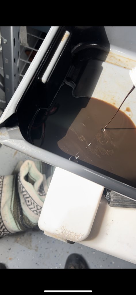

    Here’s a screenshot of the video, can see one of the bigger pieces

    WTF? Is that erl?

    I honestly don't like the color of that oil. I'd fish out the pieces and if you have any oil left, that is one I'd send to a oil lab and have them run a metals check on it along with any contaminants like antifreeze. Money well spent. Antifreeze is hell on lubricated engine parts.

    That oil looks like what came out of my engine after I did a crankcase flush. If that's from a typical oil change the engine is running really dirty internally.
