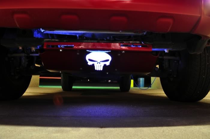

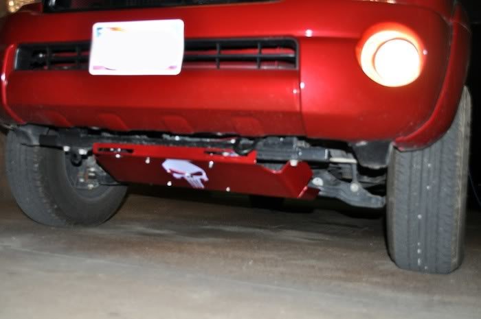

    So I had custom ordered a skid plate from Metal Miller with the Punisher skull cutout so it would match my emblem. Here's what I did:
    • Painted skid plate Barcelona Red
    • Clear coated skid plate
    • Wrapped entire skid plate in 3M clear protective vinyl
    • Cut out a section of 1/2" plexiglass
    • Sanded the back of the plexi and then painted the back Super White
    • Left the front of the plexi clear
    • Applied 3M clear protective vinyl to the front of the plexi
    • Dremel'd out mounting slits on the left and right sides
    • Inserted 4.8" white LED strips into the slits
    • Drilled holes and mounted plexiglass to the back of the skid plate using similar stainless bolts/washers used to mount skid plate

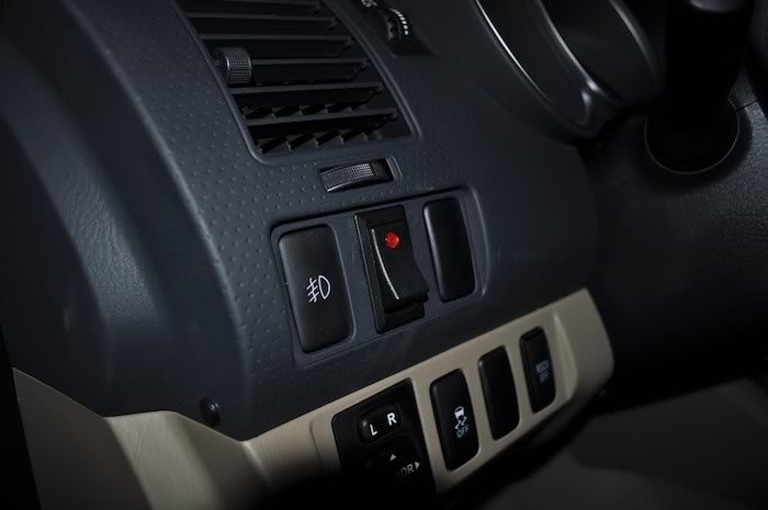

    • Ran wires and mounted a switch in an empty switch block in the dash
    During the day the skull looks white. At night, it glows. :cool:
