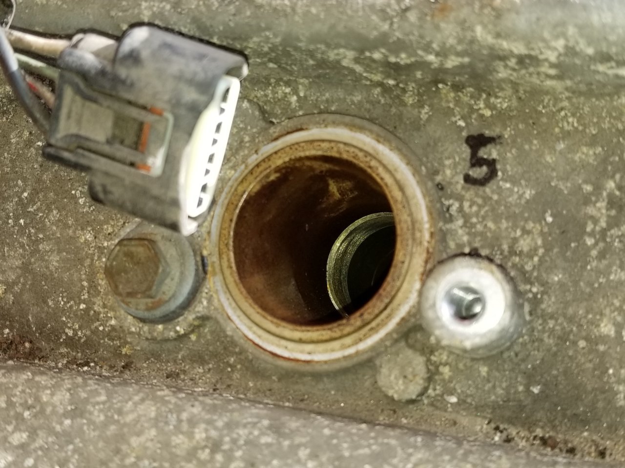

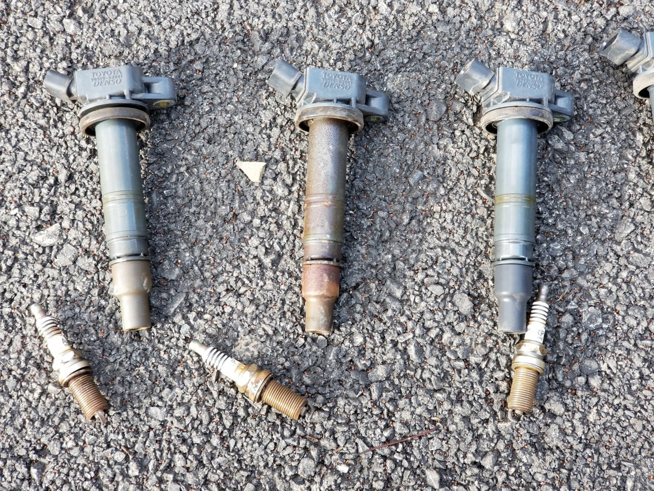

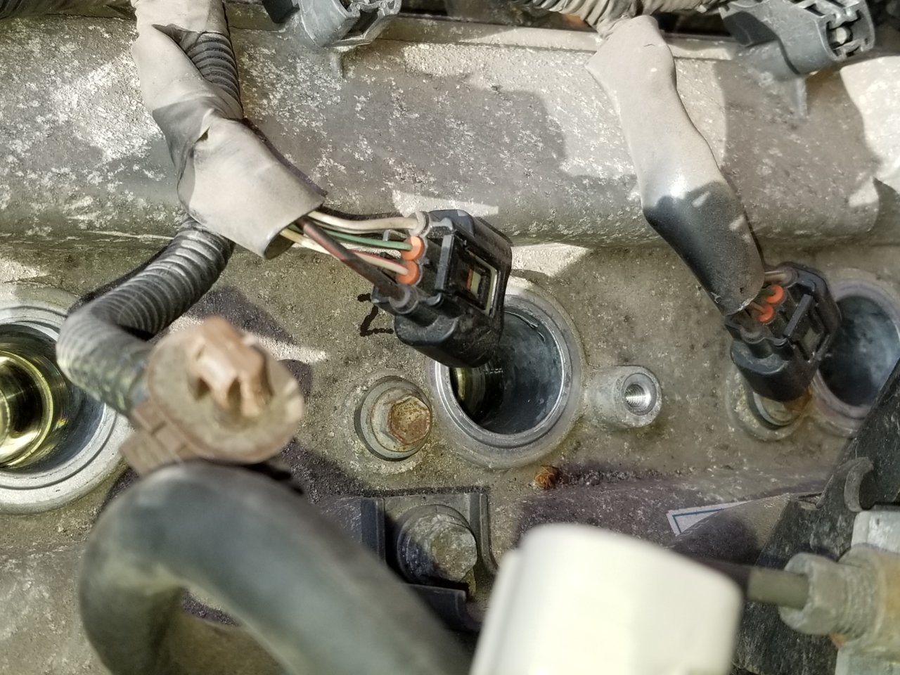

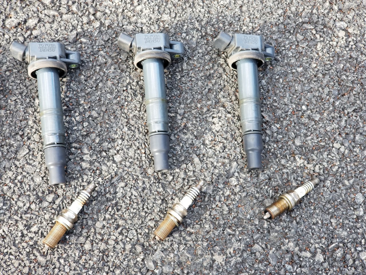

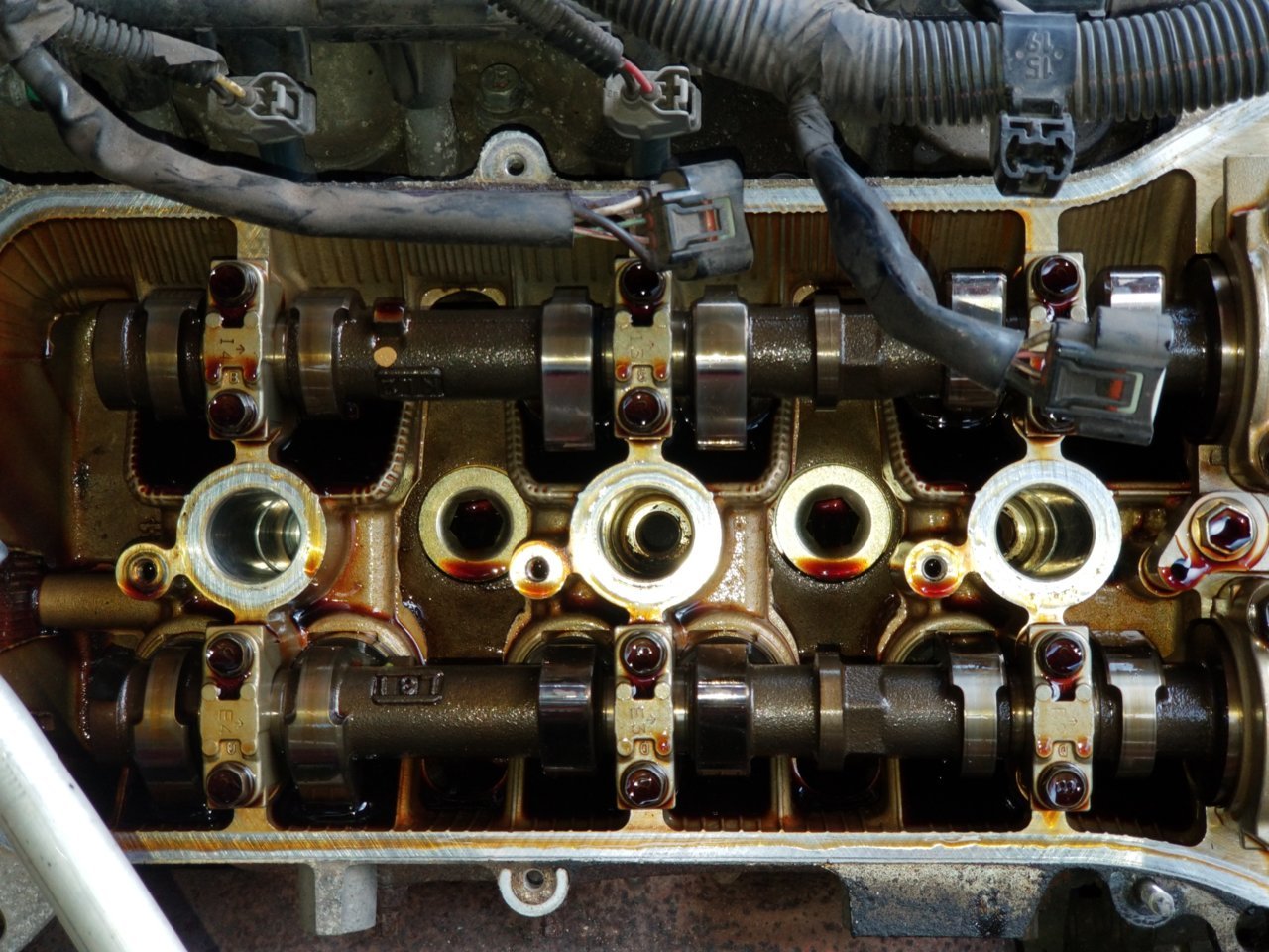

    So here is where I am at now.
    Pulled spark plugs and valve covers. Spark plugs were definitely replaced and not happened correctly. Almost all were .050 and above, two were abover .060. one cylinder looked like it had a lot of residue and that was the one with the spark plugs and gapped at .063. not sure what else to look at while I have the covers of I didn't get a picture of the other side but it pretty much looked the same aside from that one cylinder looking rusty.

    So after replacing my spark plugs and taking the valves covers off to check everything (even replaced my gasket since I had the covers off). I am still getting that noise. I can not for the life of me figure out what it is. Maybe a failing oil pump?

    Dang, can you get a video/sound clip? To me, that one coil pack/spark plus looks dodgy. Try a compression test maybe?
    You could try and put a thinner oil in it, there are so many thing that could be wrong have you tried taking it to a decent shop?

    The cylinder head looks good. How many miles? Mine makes a tapping noise for the first mile or so on cold start ups then goes away.

    I do think that one coil pack and cylinder looks grungy because my valve gasket was failing and oil was getting in there. The old gaskets pretty much flaked apart when I removed them.

    So could lifter still be a potential problem?

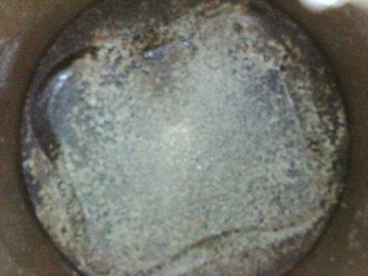

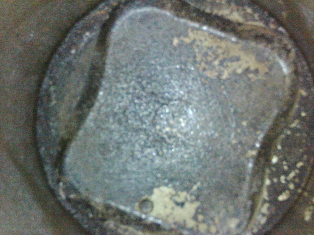

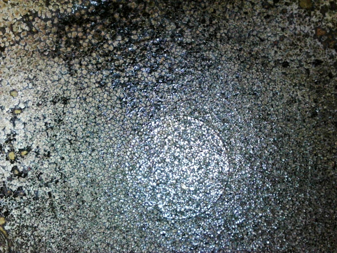

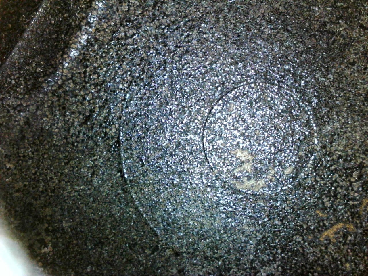

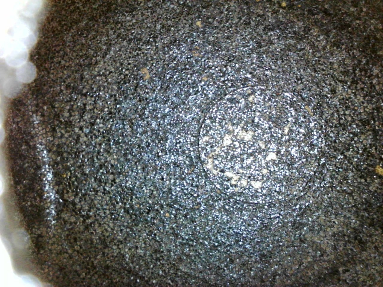

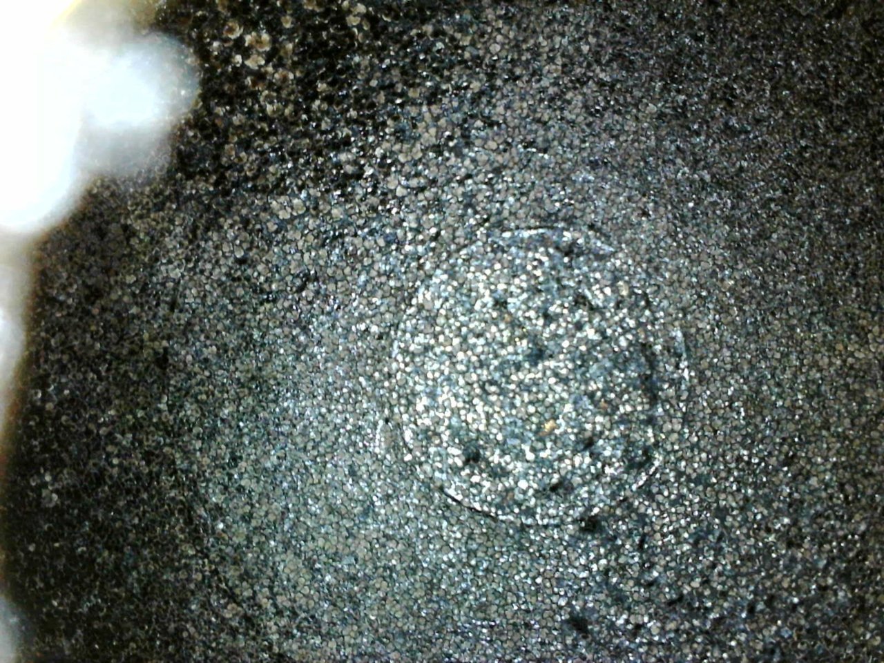

    Ever ran fuel system cleaner like Techron concentrate, Redline SL1 or Amsoil PI? You could use a bore scope to look inside the cylinders to eliminate the possibility of a head gasket leak.
  18. Dec 27, 2018 at 6:40 PM
    #78
    ARB1977
    ARB1977 It’s a beaut Clark
    Feb 12, 2009
    #13537
    1,574
    North Texas
    15 DCSB Prerunner 4.0L Blue Ribbon Metallic
    Black TRD Fj Cruiser wheels, TRD catback exhaust.
    743F0430-7EAB-47E4-A2C7-F85655942D0F.jpg 25235568-207C-4C44-AE05-74716E12E5A3.jpg 13130A49-14DF-443B-83CB-AF5723A9A54C.jpg A2B096BF-2303-4710-9B2C-BE84B092C7C5.jpg CA84C397-E2C2-4488-99EE-01E5D7898DBE.jpg 59555765-6E27-41A9-BE81-86AF03723ACB.jpg This is with a 50.00 bore scope and a smart phone app. 60K when I took these pictures.
