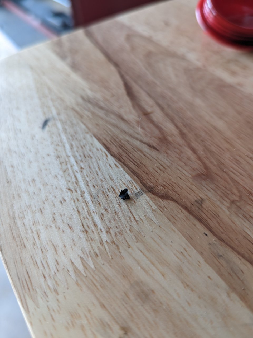

    While changing my rear diff oil today I noticed this metal shaving on the plug.. How screwed am I?PXL_20230402_182049597.jpg

    Shavings a plenty on rear diff are usually normal, chunks... not as much. If you are mechanically savy, removing the cover and inspecting the teeth will help determine the severity of the issue. If not, prob would recommend bringing it in.

    I wouldn't sweat it. Unless the thing is groaning / whining it's almost certainly fine

    Hard to see in the pic, but even at your mileage this could be metal left over from the original machining process, if this is the first fluid change. I’d clean it off and give close inspection, see what you think for peace of mind.

    Was the fluid otherwise decent looking? Unless the oil came out looking like a silver glittery paste I'd be surprised to see a diff failure. It's certainly possible, but very unusual.

    I just experienced a diff failure this past week in Moab. If the fluid looks clean you should be fine with that little bit. After a complete cleaning and 1000 miles on a new diff I got more debris than that when I changed the oil today...
