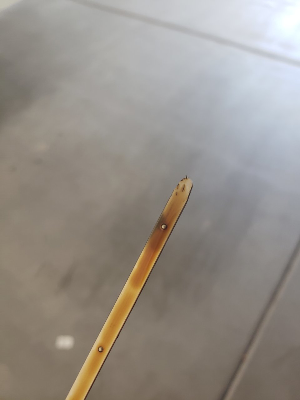

    Hi all,
    2018 TRD OR, with 8000 miles. I pulled out the oil dipstick today and noticed a bunch of metal shavings on the tip of it. Of course I wiped it off before taking a picture of that instance. I put the dipstick back in and pulled out again and more shavings collected on it. Just curious if this is a common thing or something to be worried about.

    Any part of the tip of the dip stick razor sharp to the point the tip of the stick it’s self is shaving metal from the tub when you push the stick in?

    It definitely scrapes while going back in but not sure if its enough to make this happen. Possible though ?

    Stone the shap edges off the stick tip. Clean it. Insert it and see if the shavings disappear. If your oil filter cartridge has shavings you have concerns.

    Make sure you ask to see the filter cartridge before they clean it up during first oil change. A small amount of shavings as the bottom of the cartridge housing is normal and will clear up after the first change. A thick sludgey layer at the bottom would be very worrisome.
    I've never seen shavings on my dip stick.
    Like others have said, round off the edges of the tip of the stick. I has to snake around quite a bit to get in to the sump. Hopefully, and most likley you are shaving the inside of the soft tube.
