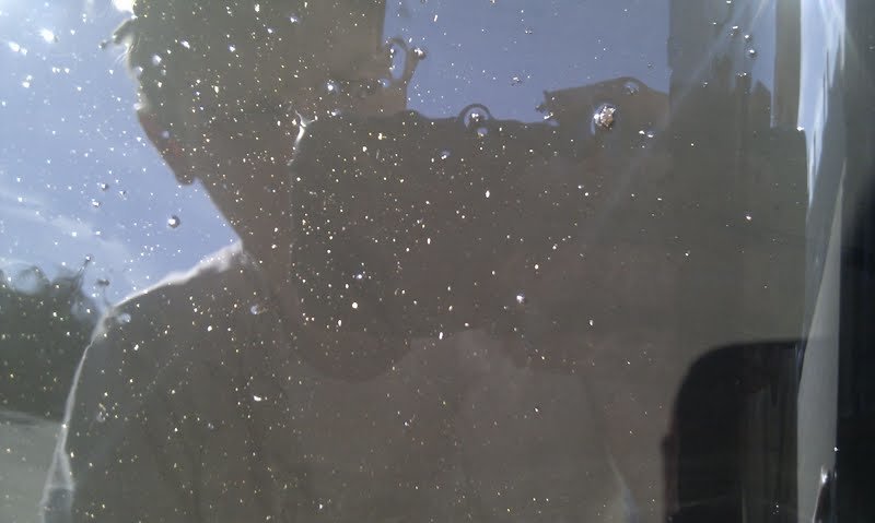

    @Fearthisbeard For reference, I would say my filter housing looked something like this pic off of the web. With a flashlight, the very bottom was covered in metallic glitter. No metal specks were noticeable on the filter element itself.
    Hope this gives something to compare to.
