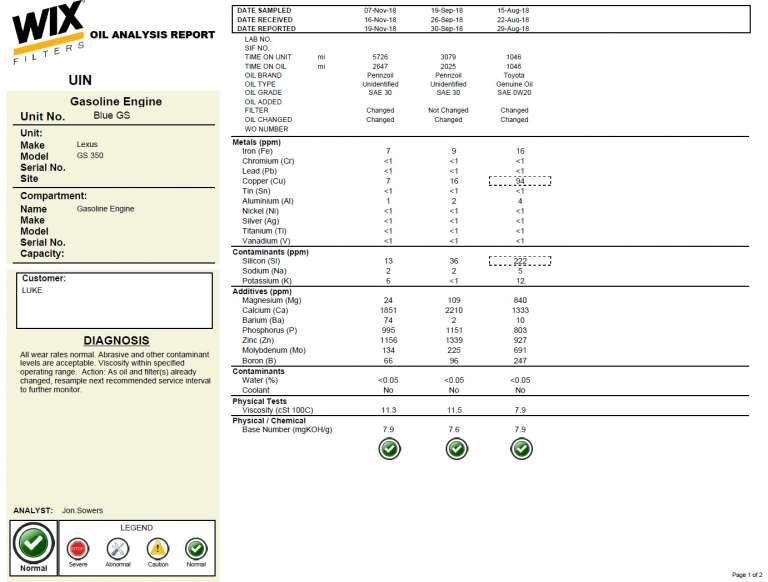

    Not on Toyota but on my 2014, 2017 Odysseys and 2016 MDX I sent in a samples to Blackstone and the Moly content was extremely high (over 600ppm). I am planning on sending a sample from my Tacoma when I hit 5k but that will probably take me a year, lol. As far as Toyota, I just go by what other people posted on BITOG and some other sites. Here is one for example.

    Yeah Honda runs a breakin oil that is high in moly. As far as I know Toyotas dont leave the factory with anything special. Only ones I know for certain are 2nd gen tundra(2010) and FJ(2014) as I bought both new and tested them pretty quickly. And moly levels were comparable to standard toy branded 0w-20.
    I will be testing a 2019 Tundra early next year and will see how its initial fill matches my other tests.
