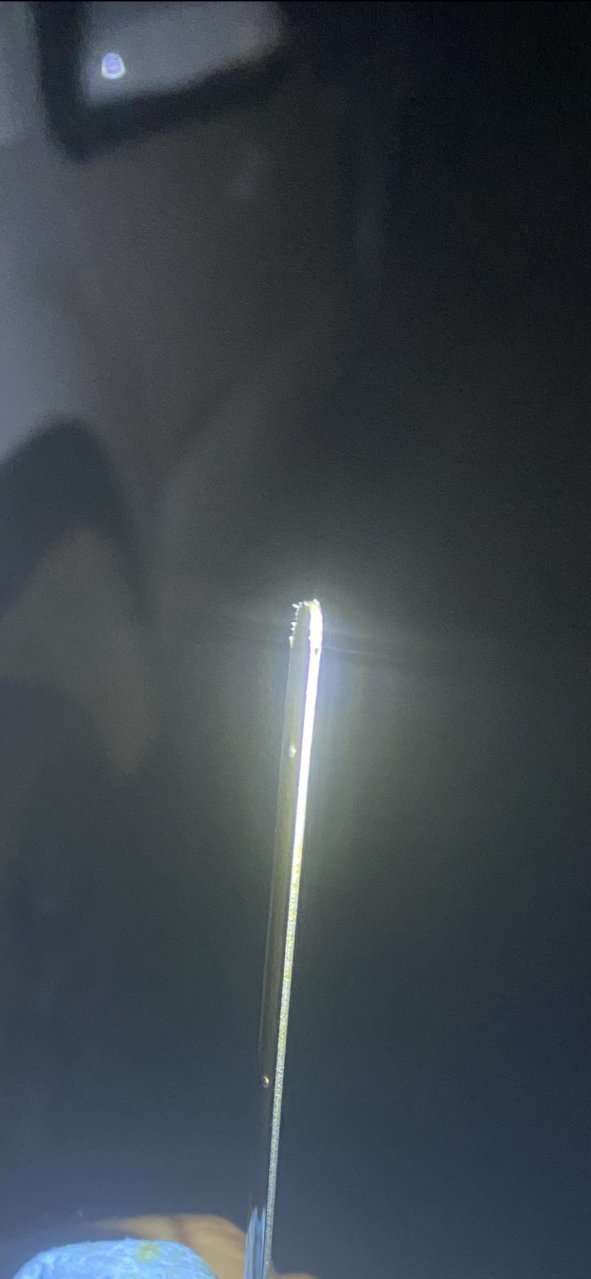

    Update: Got the dealer to change the oil, inspect the filter, etc. They found no metal shavings. I have the old filter and can’t find any shavings on the filter. I picked through the filter piece by piece and only found a few pieces of trash down in the creases of the filter (pic 1), which none of look like the shavings I found on the dip stick (pic 2). When I first posted about the problem, there were more shavings, now not so much. There were no shavings on the stick this morning pre-oil change, now post-oil change I can see a few shavings. Leads me to believe the stick is scraping the tube.

    Agreed. I saw these threads but both refer to trucks with less than 10k miles. I was/am still worried since mine has 71k. I’m probably going to do an oil analysis when I get a few miles on the oil. Maybe it’s just the tube and metal isn’t circulating.

    Your engine is fine. Metal particles from bearings in a motor will be much finer than that.
    It's your oil dip stick scraping metal off the tube, mine does the same thing when you push it in to fast.
    The cure? Slow down dipping your stick in and out. That's what she said.

    Get a file or sharpening stone and dress the the dipstick edges.
    I had a drill press that was chewing up belts. I saw that some of the pulley grooves were bent. Probably from sitting in a production bin with other pulleys thrown on top. I took a file and bent them back and filed them smooth. No more chewed belts and smooth, quiet operation.
    Just do it. I had shavings at 400 miles. I dressed the dipstick because the sound it made coming out was not nice. Maybe it wasn’t the dipstick…but it does sound better now.
    If I remember correctly, it was the tip of the dipstick that was ground roughly. But my guess is that the debris is in the dipstick tube and not in your pan. This would be why each time you check, there’s less debris.
    These are just my guesses.
