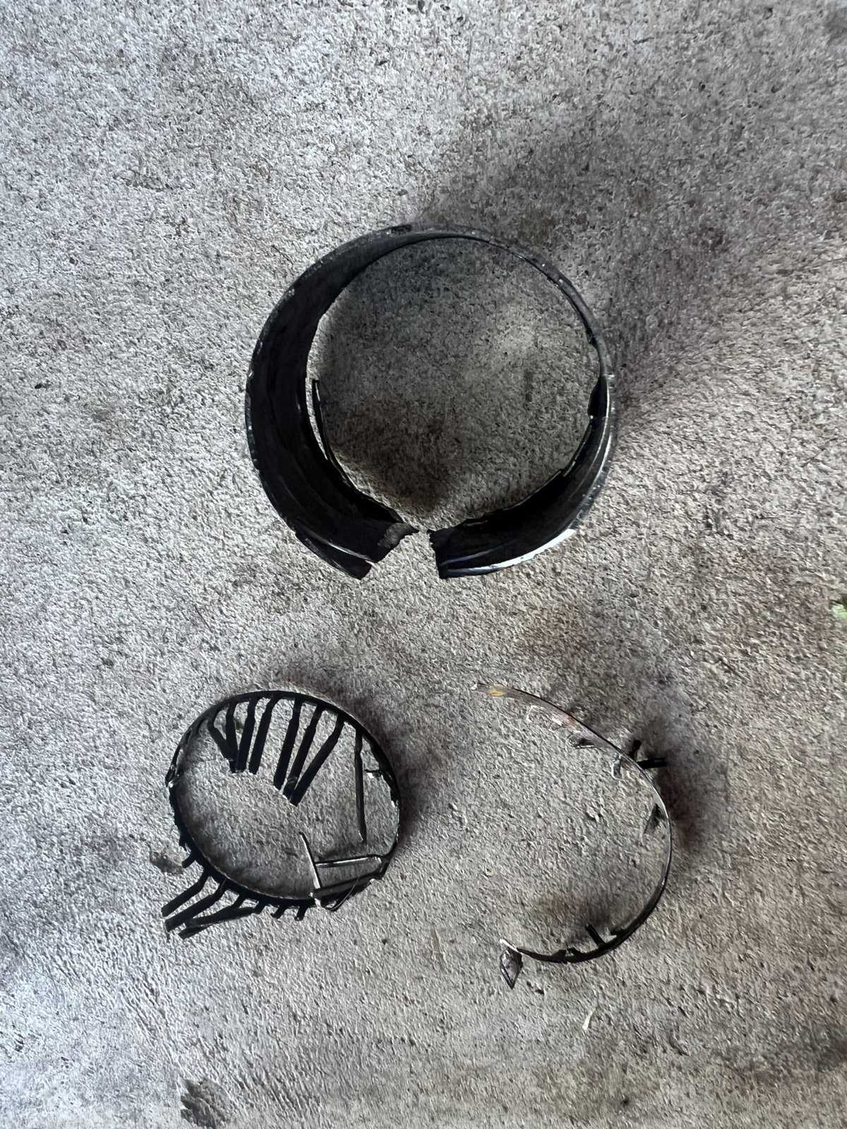

    Just wanted to add: it's not your fault....you didn't do anything wrong. Needle bearing imploded as they are known to do.
    Take your time and remove all the debris in the diff with a telescoping articulated magnet tool or equivalent. Clean the plug, fill the diff, and give it a gentle run up the driveway and back. Check the plug and do this until no more debris is collecting. It's worth doing this procedure as if you were a meticulous brain surgeon. The diff is stupid expensive if you have to replace it.

    Man that looks awful. Hopefully you can get them all out and salvage the front diff.

    Needle bearing

    I immediately knew what he was talking about before pics
    So…success? Did you get it all out?

    Yeah um.. please take this to a professional for repair.
