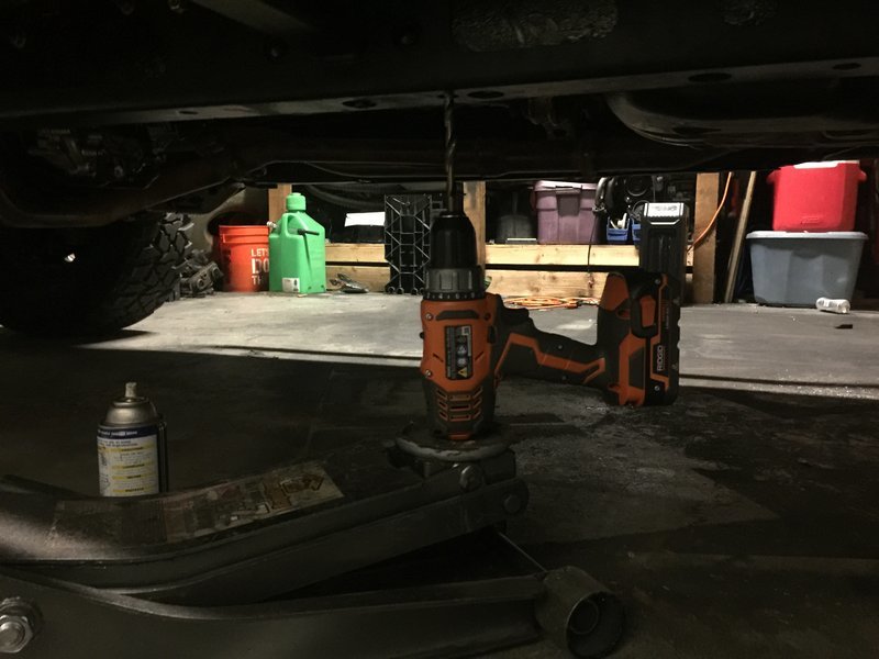

    Not like there will be a next time, but next time you have to drill those bottom holes...
    The eight holes I had to drill took me about 15 minutes and almost no effort. :)

    I saw that photo before and thought about them as I drilled.
