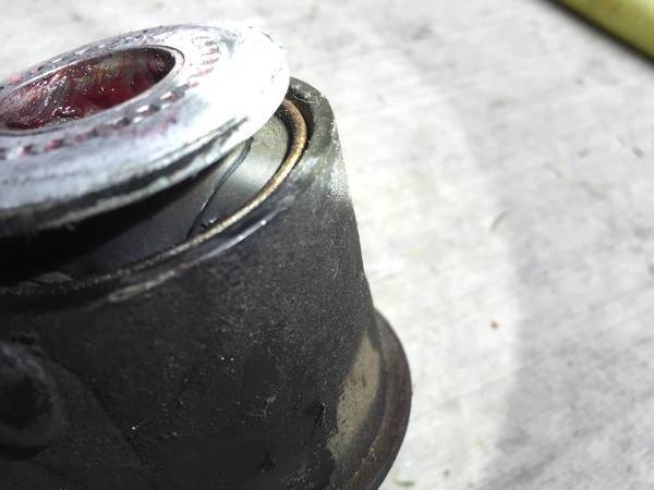

    Do you think this could cause the noise I'm hearing?
  6. Feb 24, 2015 at 6:25 PM
    adanfon
    adanfon [OP] YNWA
    Dec 3, 2011
    #68101
    1,906
    Adán
    Hanford, CA
    '11 Tacoma DCLB 4x4
    Well looks like that was the noise. I replaced the passenger lower control arm, drove it over the speed bumps out to the street and nothing.
    The noise never went away over the last couple years and finally on Saturday, after a coworker pointed out the noise on the way to lunch friday, i took the passenger side suspension apart and thoroughly looked over everything. The only thing that drew my attention was that bushing. I was able to get both lower control arms covered under warranty and I just installed the passenger side today, the driver side is still en route. I put everything back together, torqued the control arm bolts to 100 ft lbs, and no noise. Prior to this I really had to tighten the control arm bolts to well over 100 just to make it quiet. If I torqued it to spec the noise was way worse. Now that I found the source I feel like I should of caught it earlier. Anyway I hope this helps someone in the future.

    Wow good job. No bs fix. That's how its supposed to go. I was gonna say the aluminum inner bumper flexing

    Hanford, CA
    '11 Tacoma DCLB 4x4
    Well turns out it wasn't the LCA's. It was the shock. I used a chassis ear and the noise was so loud on the pass shock stem. Replaced them both, no noise whatsoever. It's been about a month now and all is good!
