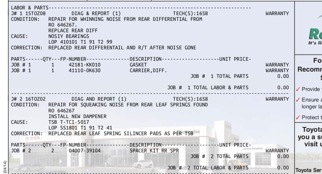

    I had exactly this sound. Sort of a metal on metal scraping/whining type noise. It was especially noticeable with the rear window down. It also changed with speed. New rear diff (maybe rear diff hangar) coming from Toyota. Warrantied, no questions asked. They must know it's an issue.

    Finally just got it fixed, took Toyota weeks to get the leaf spring pads, and a week or so for the diff to come in.
