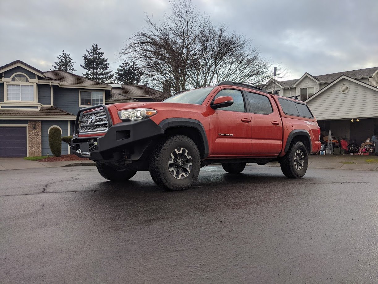

    Well, after doing some deep research on which fab company to buy my bumper from I always came back to MT. They are cool people, always had good customer service, and they are somewhat local, nice tax break if you are willing to drive the 120 miles. With that said. the main reason why I went with this, is because it is a 100% no drill, no cut bumper, all bolt on. they are pretty keen on that for most of their products like the rock sliders and rear bumper I bought from them as well. The only thing that had to be drilled was the inner wheel well plastic. and a little from the outer plastic fairing. The bumper is 100lbs heavier than stock.
    Now. Pulling off my old bumper was easy. many endless plastic tabs and clips, for me It was easy since I had a body armor hi-line that had be installed and trimmed accordingly.
    Once the bumper was off in the kit came two large 1/4 plates, they mounted to the frame using 2 each side grade 9 1/2 bolts. They even provide a wrench for it. reaching back with this 2 foot wrench was a major pain in the ass I.E lighting. these plates mount to the "winch"plate" as it is labeled in the 2 page directional PDF they provide online. Once those were loosely tightened, I placed the winch/plate support over the existing bumper support bolts, washes and nuts on loosely for adjustment. Lastly, metaltech provides these weird "fins" one is drilled 1/2, and that's it. The directions were very vague at this point. The bumper did not fit right. it sagged down , would not mount up flush. I was a bit frustrated due to the vague install instructions.

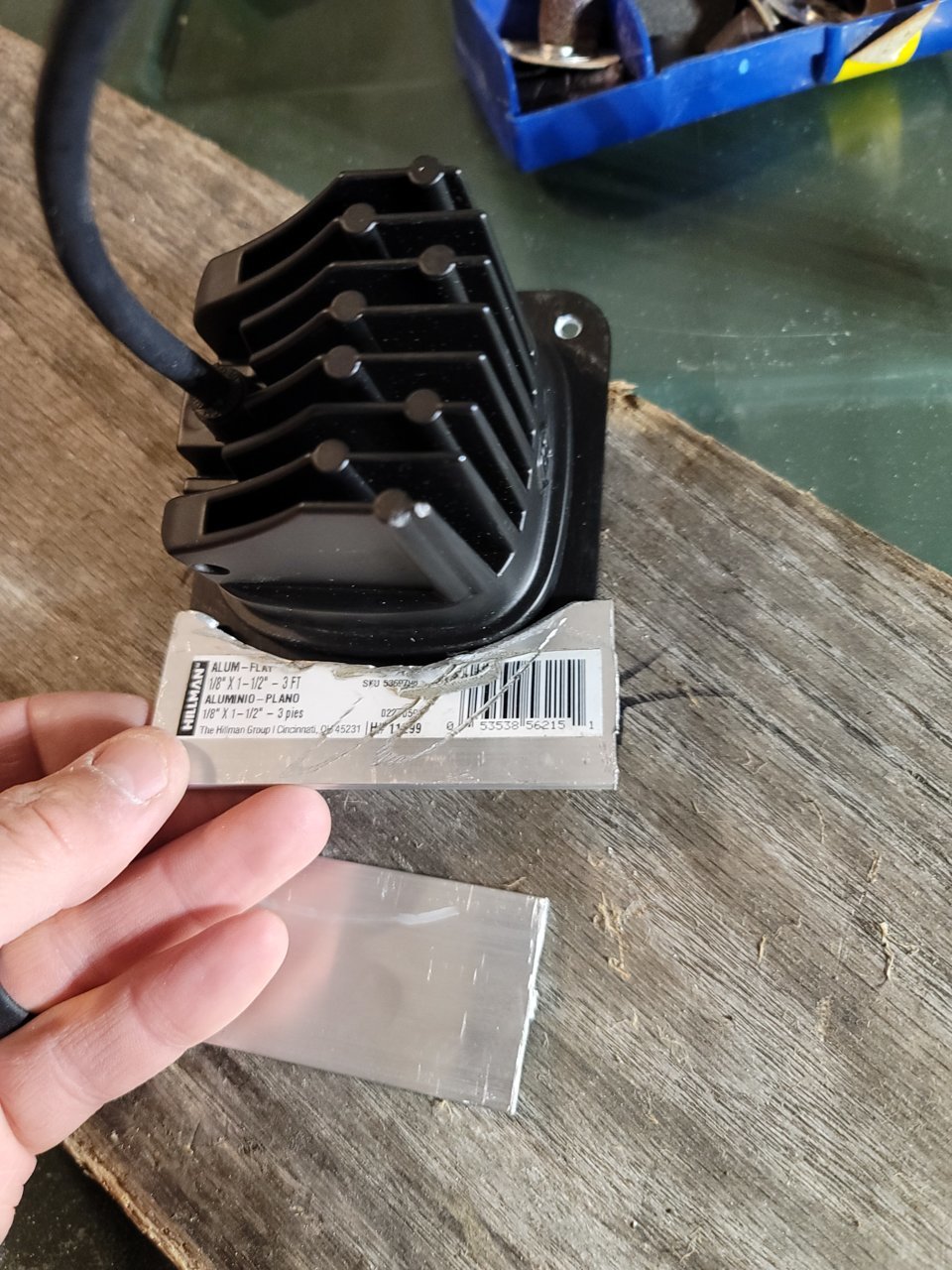

    We made a little cutting drilling, and used the BD mounting bracket as template. BOOM, worked like a charm.
    second frustration

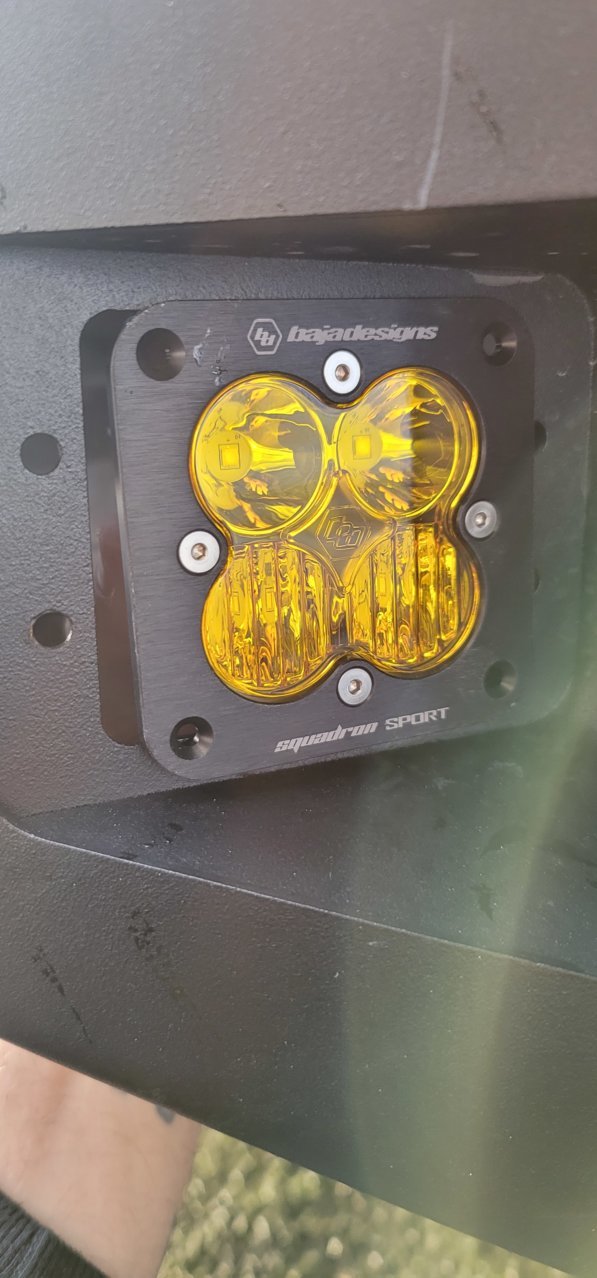

    the cutouts for the led foglights dimensions were weird. Once again , I think they were made to be specific to OP-off-roads fog lights which is included in the blackbird stage 2 and 3 bumpers as well. I used a diode dynamics flush mount cutting template and sized it up against the cutouts. I also removed a ss2 spot light I had and sized it up, it was too round and fat to fit in the hole. The dimensions that MT gave me direct were 3.5"x3.0" hole with mounting bolt spacing of 4 1/16th" x 1 1/4" so without having to cutt/grind away at the new bumper I figured I would try BD squadrons and see if they would work as well. I sized up some squadrons, and they seem to fit fine For a flush mount, I would just have to drill the 4 holes to mount them into the cutouts. I ordered some today and should be here next week.
    In the end:
    take picture online hd
    overall, there were some minor setbacks with the install. I still think it is frustrating that they dont directly disclose a specific brand or type of mount that would work. most other fab companies are universal , and if they are not they always disclose that. I was frustrated that my 20 inch BD bar could not fit there it was intended to go as well as my fog lights.

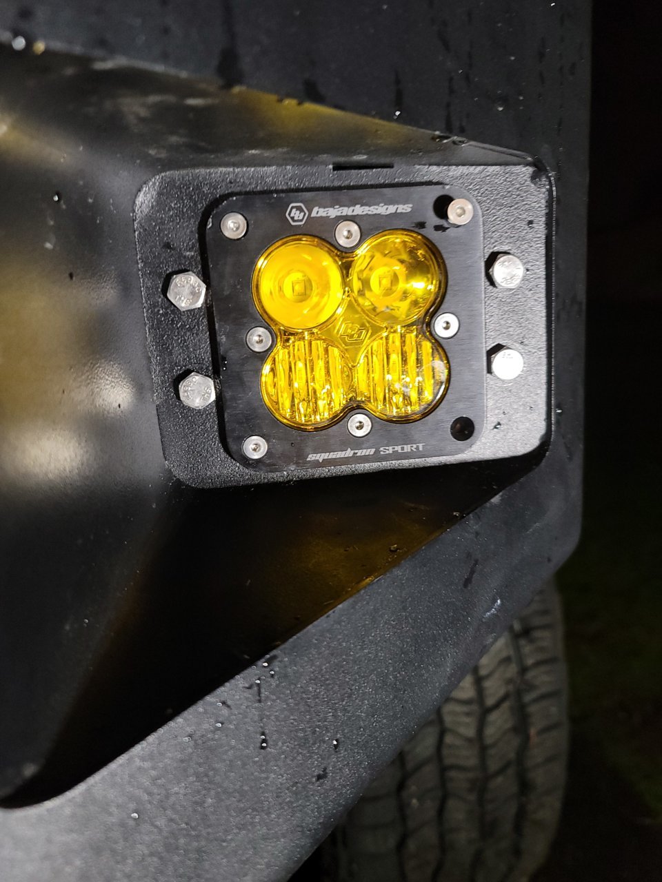

    Driving 500 plus miles on the bumper now and have noticed some serious issues. Th grade 8 bolts ( 2each a side) that hold the bumper to the winch plate/bumper mount to the frame have worked their way loose. it has caused the bumper to lean/sag forward causing rubbing issues on my grill and both front headlights. I removed the rubber trim to make more room so see if that would help. NO. I am overall kinda agro with this bumper since metaltechs feedback and questions I have asked I never get any real solutions. Additionally, I was having some issues with fitting any foglights into the cutouts. I emailed them back and forth and they said they couldn't guarantee that any other brands would work but only their " off post offroad" fog light/pods. This company is now out of business from what i could find. I assume they are just rebranded low quality stuff such as Caliraised, or aux beam so forth. I knew that I had issues with the rear metaltechbumper fitting DD flush backup lights. So I measured the cut outs and even test fit a BD squad sport. I ordered a pair of yellow flush mounts from @memario1214 , once I got them they did not fit flush. I was even more agro. Not so much at the fitmet, but metaltech4x4 does not disclose whether or not brands like BD, DD, and other brands will fit in their products. Now knowing all this, I would have rather bought something elsewhere. But for a direct bolt on bumper, the options are limited out there. I may decide to sell this and buy something else.

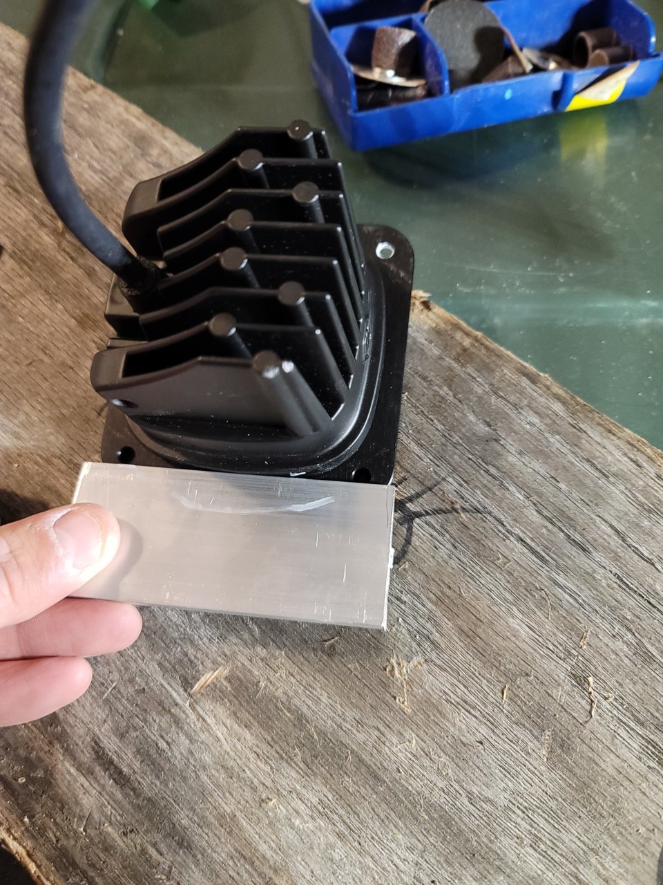

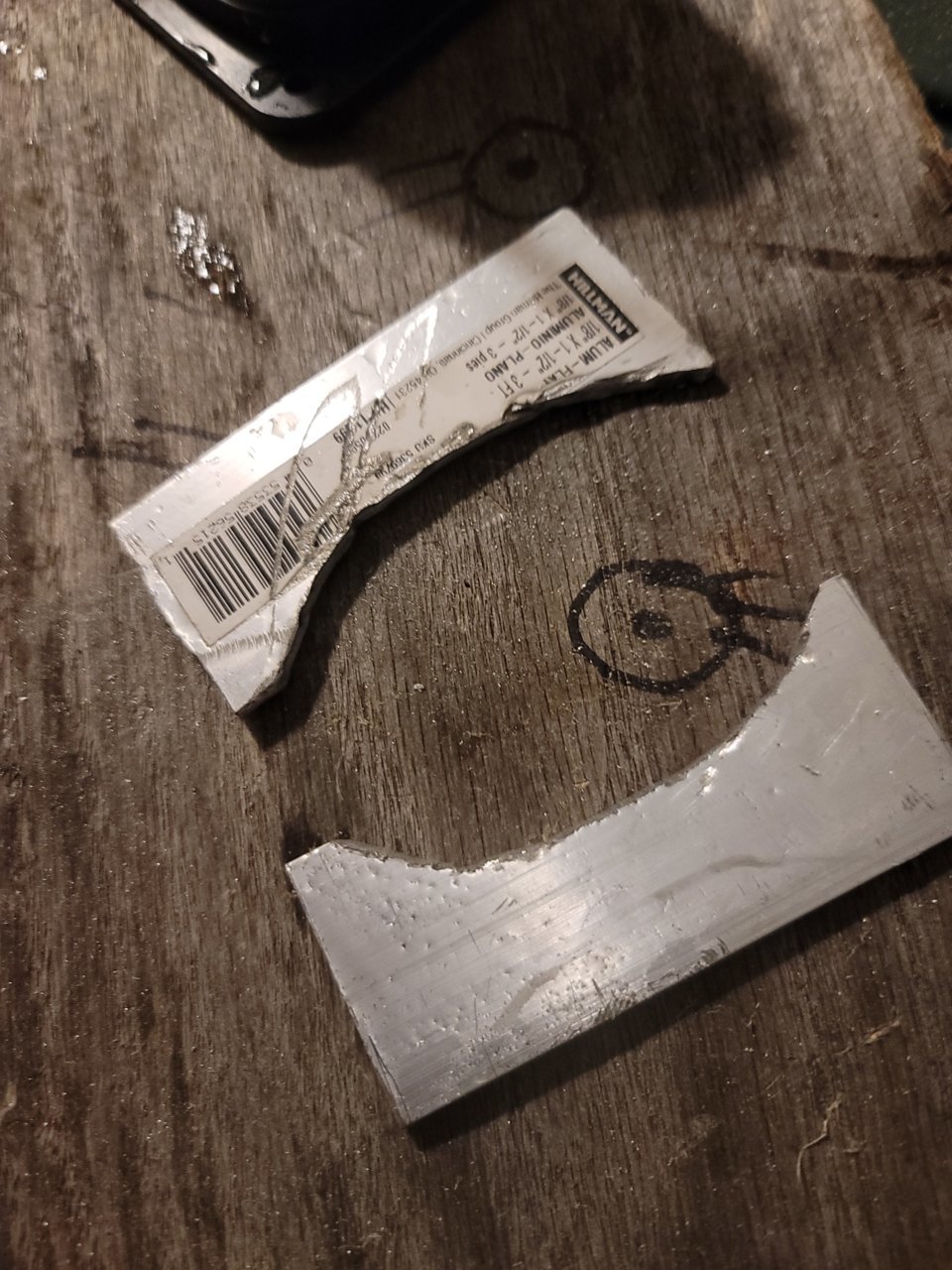

    I had to "ghetto fab" some brackets out of alum stock to make these BD fog lights work properly.

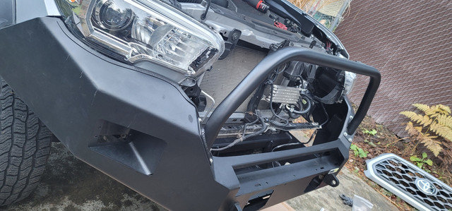

    Initial fit-up done, wife helped me out in getting it in all the holes.. (Happy VD to y'all)
    WrecklessAbandon likes this.
  11. Feb 14, 2021 at 7:40 PM
    .劉煒
    .劉煒 Well-Known Member
    Nov 7, 2015
    #168910
    2,510
    2016 Inferno DCSBTRDORMT

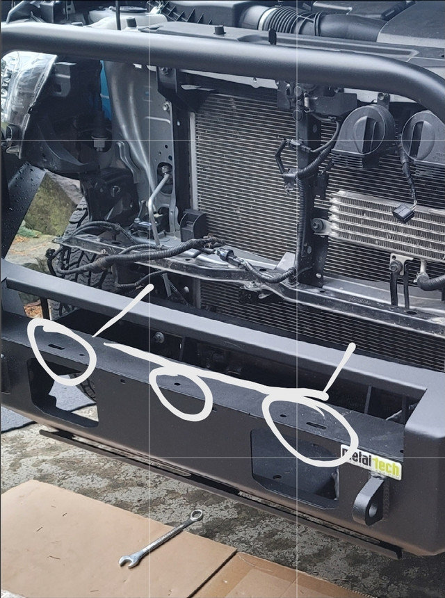

    Um.. you didn't drill out the third hole?
    Yeah not impressed with their lights either - their 'plug and play' harness ... isn't. I think I'm just going to go do a fitup of some rigids and 3d print an adapter plate of the appropriate dimensions.

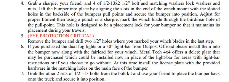

    You were complaining that your bumper slipped after a few months off the winch mount.
    So, after installing the winch platform, get the bumper in position, put in 4 bolts
    (aka, step 4)
    mark the holes for 2 extra bolts (3rd hole), which are there to keep it from sliding around like your bumper did ... remove the bumper, drill, put 3 bolts per side. (aka step 7)
    Yeah, their instructions are pretty eh.
    but with 3 holes, they'd likely not be slipping forward either (since the other 2 holes are meant to slide about a bit).

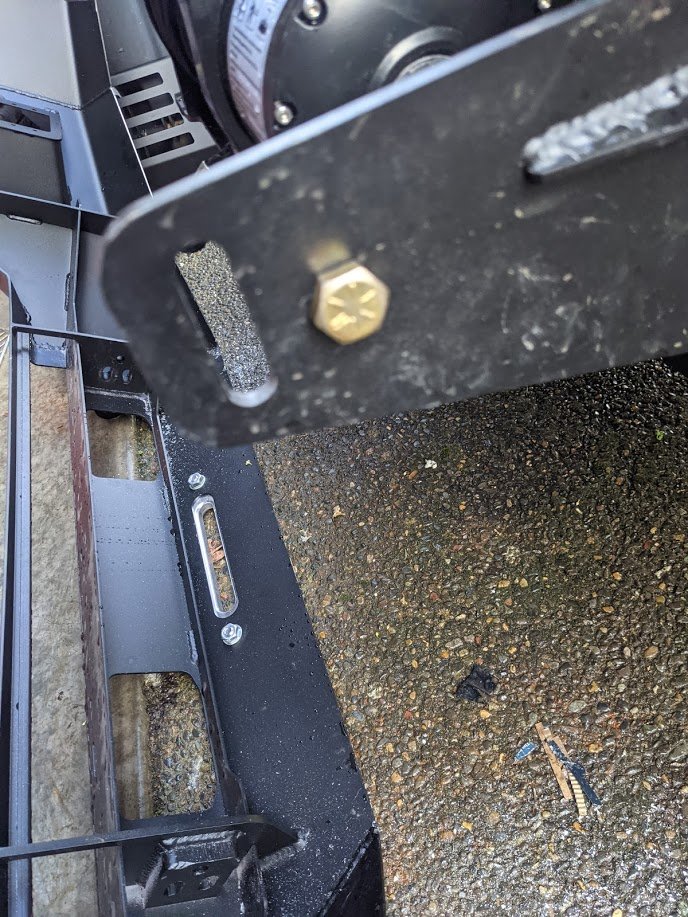

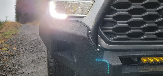

    Okay done and mounted up.
    So.. to add to the OP's info
    The bumper is attached to the winch mount by 3 bolts per side (6 total).
    cdiNeQo3AszOrCHZyLyHc8nEcT6Fiiy_cWot7-JD_c2fd7675e8d35b988a46d7c9582d3edb3ba8611d.jpg
    This is the winch mount side. Two bolts go through the long slot, and a third bolt goes through a hole your mark and drill out.
    bFGL12gnMFCCHWui_TaDeHapLc70szpz_rvGT667_b13baa910cb072963ccd5cb2094979467e3980cd.jpg
    This is the bumper side. Note the two longer holes.
    Yk38o5Z5o1cd6uEwzM2eTv-PayYh9gvq0qxLtIow_20b9b7665cb2091a2d6b19ced9ce604bf1031a76.jpg

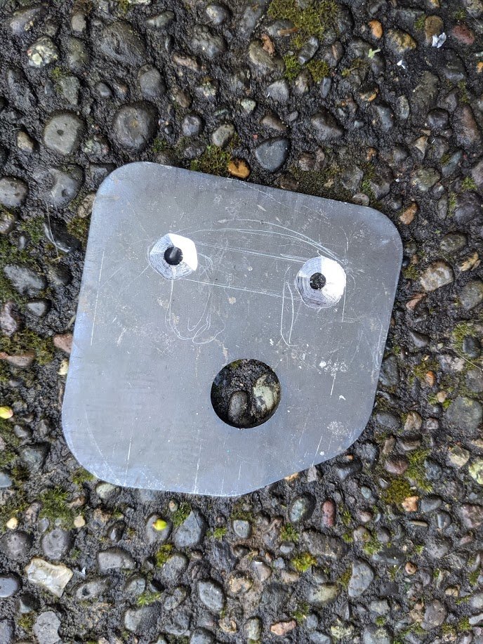

    This is the 'shim' plate that goes between the bumper and the winch mount. Note I've scratched out the outline of the vertical hole and the two horizontal holes. (I messed up this one and went back and redrilled and fixed it).
    Basically, you adjust the bumper as needed and then mark and drill a hole in the winch mount. At the same time, you also need to drill out holes in that shim plate. The holes you drill will keep the bumper aligned. Without the shims and the third hole, the bumper is held by bolt tension only and will, as the OP noted, will lean forward and sag once those bolts rattle a little bit.
    Yeah.. this was only vaguely noted in the instructions.
    2dxhG0OnZPPi2RttUQc7FDcG-iWbPwbNp2D8WfRI_e8add0cf425e8945cf7c1a265eac0cd552a2c933.jpg
    Anyway, install finished! Good holiday project.
