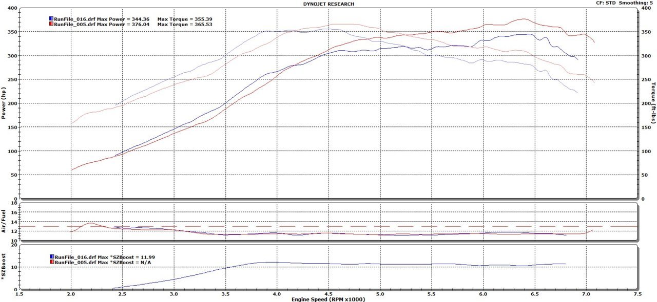

    That dyno sheet was of the 300zx?

    Yes

    In the Tacoma I cheated a bit since I have an early distributor model. I watched where it was messing with the timing the most under load and boost and retarded the base timing a couple degrees since it was all low RPM stuff. Just means it maxed out at 29° of total advance instead of 32° which it'll almost never see cruising around anyway. I didn't think it was worth it to piggyback for 7psi. I did run a lot of water/meth, mostly needed the water TBH. But if I got out of the PHX area and even got to say 2000' above sea level I hardly needed the meth on. At 3000' I could hit it with all 6.5psi and it would maintain anywhere from 19° to 26° of timing without the meth.
    The 87 Z is a 9:1 compression engine, vs the 7.8:1 or 8.2:1 of the turbo models (depends on year which comp ratio you have). Pretty brutal torque curve on your Z though, I'd love to have the early attack that the DOHC seem to have. I'm banking on Schneider 270/270 grind cams to get me where I need to be because the VG30E is built for boost abuse but they didn't think about boost vs NA with the cam profile which is the same between the two.

    Ah. 9:1 is decent for boost lol. Maybe one day I’ll rebuild the motor (what am I saying, of course one day I will) and I’ll lower that down. Some guys in the club do 9:1 and get some amazing numbers. Usually it’s 8.5:1 though which is stock in 2nd gen turbo cars.
    That torque is all due to the variable timing on the intake cams. Does the ‘87 have a version of that? I can’t remember. 270/270 sounds pretty freaking aggressive, you’d definitely feel something. Believe it or not, the 2nd gens have the same cams for NA and Turbo cars too. There’s a difference in the intake cams for auto cars though. Less aggressive.
