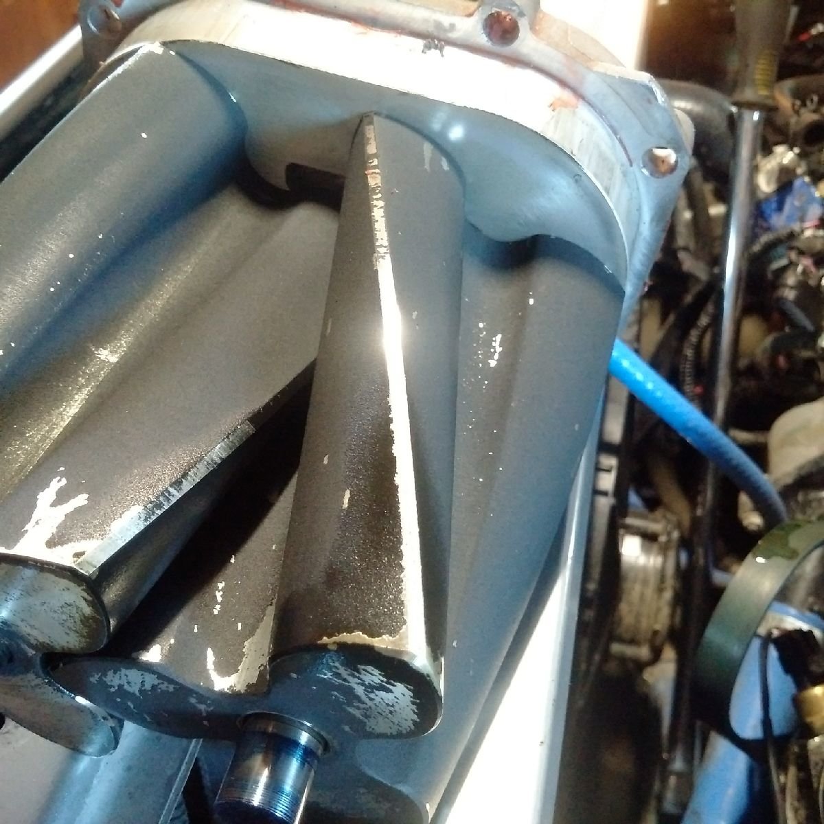

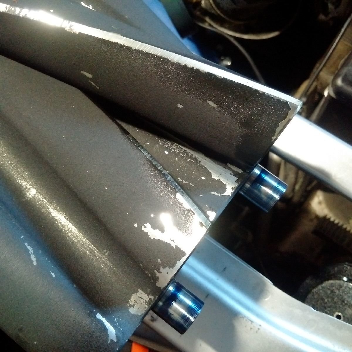

    Took my rotors out today to do the rear bearings, plugs and install a solid coupler.
    Here's what they look like. The coating is coming off as you can see. But honestly I was expecting it to look a lot worse than this after 6 months of relatively heavy meth use.

    I had always been somewhat concerned over the bearing grease being stripped away with gas or meth injection. Great to see the grease still intact and not even discolored.
    The missing coating is minimal, now I know I wont worry about the sc internals if I run meth in the future.
    Thanks for posting! Lots of valuable info posted today.

    Oh yeah, the grease inside the old bearings looked good. No concerns from me.
