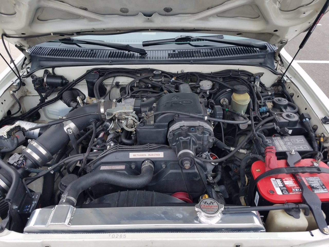

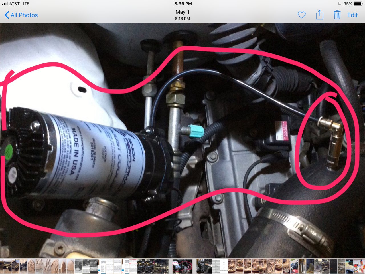

    So I’m chiming in here. I run a methonal kit instead of a 7th injection setup.
    With the snow kit I can run a much smaller pulley and get 10 pounds of boost now
    with perfect AFR numbers at 6000 feet.
    At my altitude 6000 feet it works perfectly for the 3.4 v6
    Stage two snow kit so it’s progressive starting at 4K up.
    I have probably 40,000 miles on my methonal kit. Super happy with it, used the washer resivoir
    to keep everything clean and easy. Usually mix boost juice and wiper fluid half half.
    Only draw back that I have run into is the spray nozzels tend to clog up. The smaller the nozzel the sooner it clogs up. Number 1 nozzel lasted 5,000 miles, Number 2 nozzle for me lasts about 15,000 miles. So keep an eye out as if it gets
    plugged there is no warning to let you know. Nozzles are cheap 20.00 and a few minutes to replace.
    I run a number 2 nozzel and or a 3 nozzel for more fluid in summer to cool things down more.

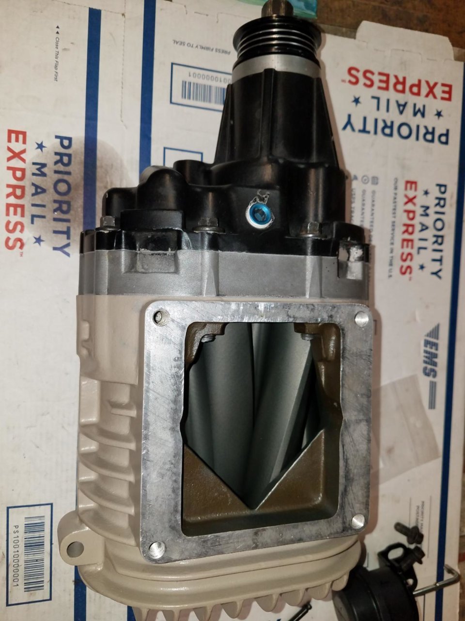

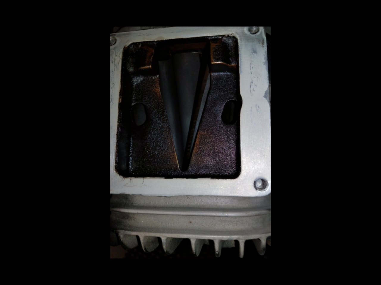

    I had my supercharger rebuilt again at 575,000 and there was very little wear to the coating from the methonal. This will vary depending on the quality of coating that was done.
    Photo of rotors at 100,000 miles below and 40,000 with methonal use.

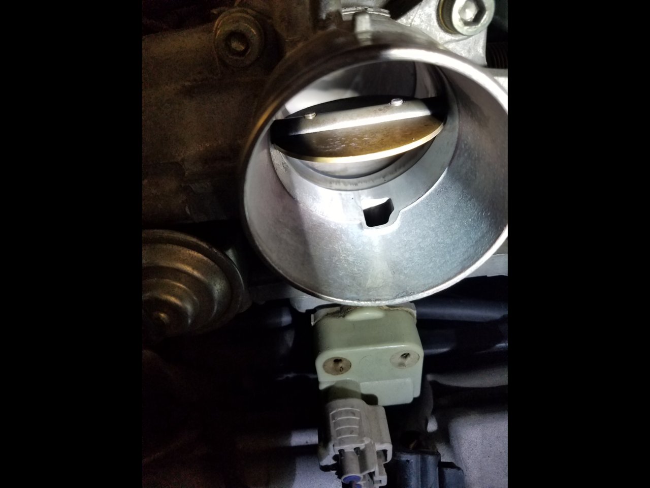

    Methonal will also totally clean your throttle body and valves squeak carbon free
    I also did have the supercharger inlet and outlet ported while it was getting rebuilt
