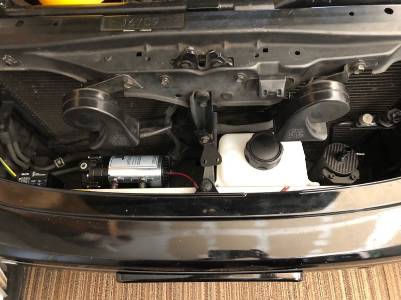

    Not a Tacoma but figured you guys would know. How durable are the nylon lines with road debris or whatever? I’ve got the option of mounting the pump horizontally or vertically. Both have their pros and cons. Horizontally the line is exposed through the lower grille but the pump is completely up and out of the way. Vertically the pump is exposed slightly, but the line is out of the way, and the inlet is at a lower point.

    I think the lines would be durable enough but you could always wrap exposed hose with some rubber hose or wire loom for extra protection. I would prefer the pump be more protected myself.

    I second this idea.

    Hmm...now that I think about it I do believe I have a roll of gates fuel hose I can use to slip the the injection hose into.

    That or some convoluted tubing from a home improvement store works great. I wrapped mine in convoluted tubing

    I went through 2 pumps in less than 6 months mounted in a location similar to this. The water will get inside that motor housing and lock it up. Now it's in my engine bay.

    I’m open to suggestions but there’s a serious lack of space. I even downsized to the 2 qt tank.

    If it's somewhat shielded from the elements and has some airflow around it should be fine.
