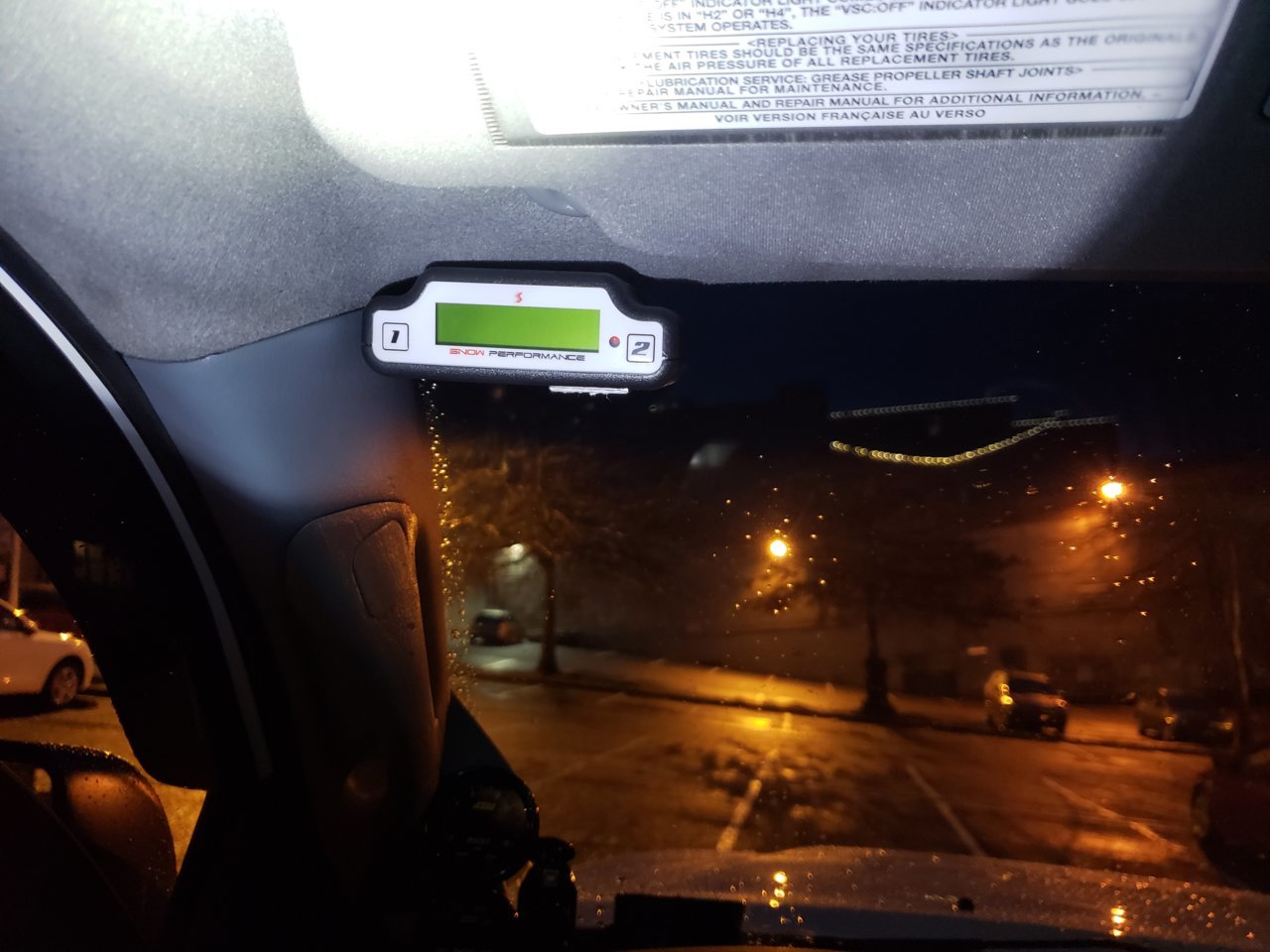

    @rjbiii, here's an idea for the control location. Requires trimming the corner of the pilar next to the windshield but it was my option. Out of the way, sun, and not visible to people passing by.20181213_071650.jpg

    Ohhh.. I do like this a lot. May have to move mine.. Do you have any pics that are brighter?

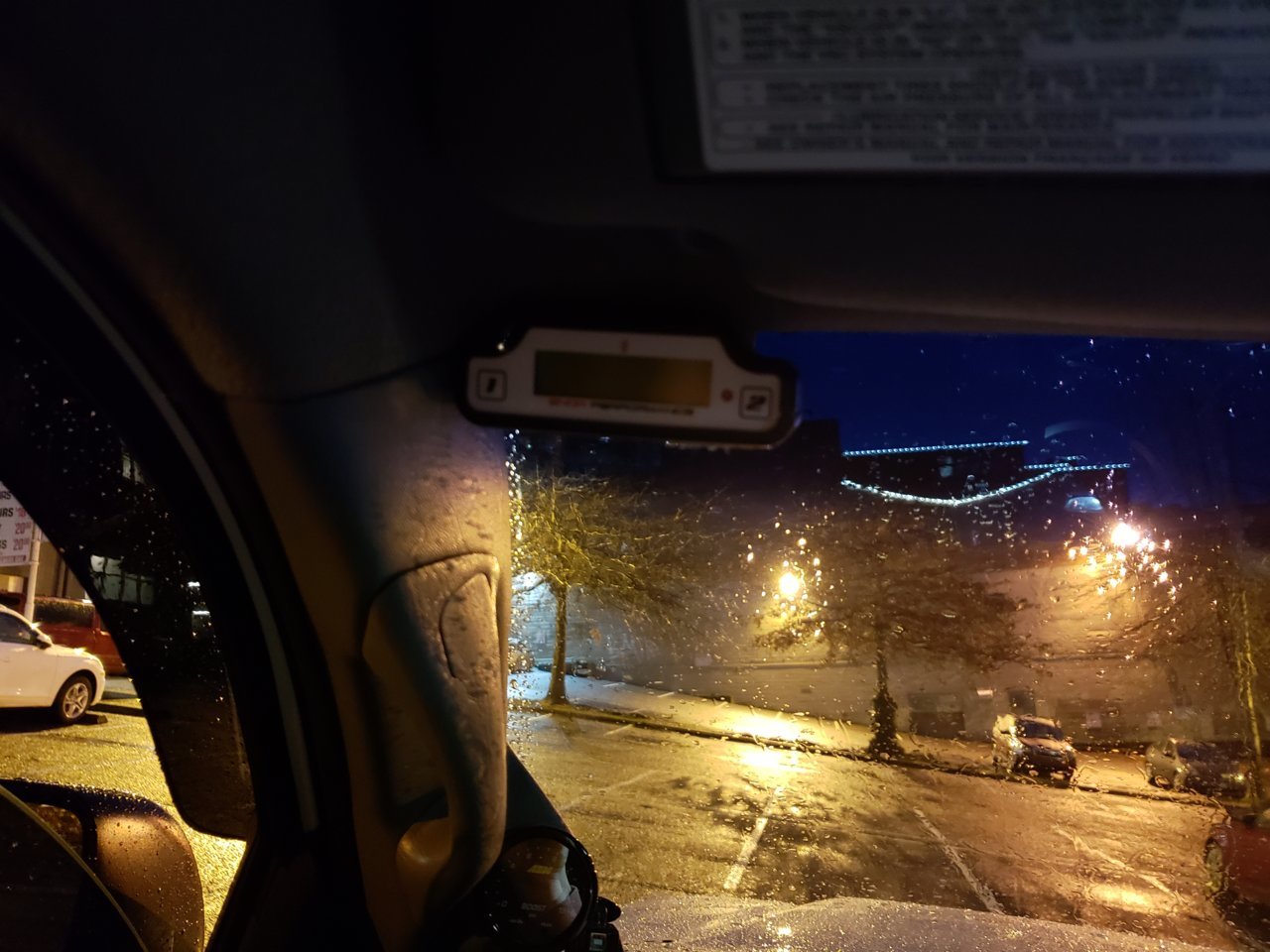

    Sorry, dark outside now. This is my eye view point.15447145855505166119243451467043.jpg

    That's awesome thank you for the pic! How did you secure it up there? And im assuming it was only minor trimming to get the wiring to go through the a-pillar?

    I took snips and just nipped the corner off. Wires fed just fine. I bent a thin piece of flat aluminum in a V and tucked it above the headliner. Yes, its hack. Yes, it works. I was in a hurry and was tired of getting taco neck trying to read it.

    How did you attach the controller to the aluminum bracket?

    Press fit.
