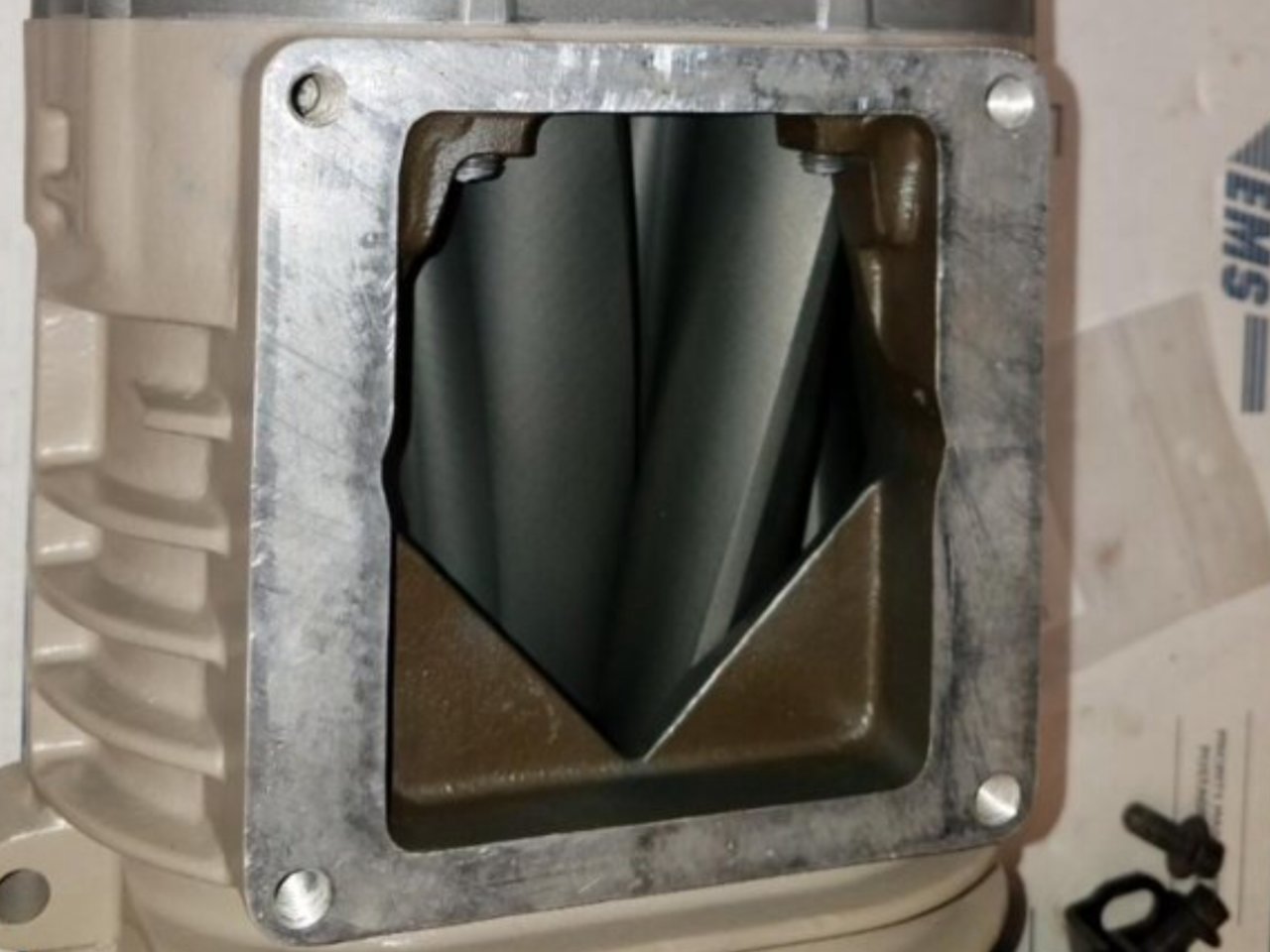

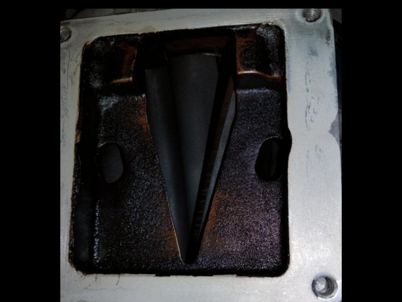

    This is how much I had removed on the top section of the TRD supercharger.
    ALOT
    Supercharger now seems to respond faster, spools faster and at higher rpms its does not bog down anymore, has less air flow restrictions.
    Instead it has a new bust of power on the higher rpm range. I thing I gained one pound of boost.
    Have to dyno it to see the real results soon.

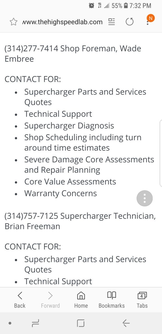

    Has anyone considered a special coating for the lobes?? I meant to call today for info but got sidetracked. Screenshot_20181213-193342_Samsung Internet.jpg Screenshot_20181213-193342_Samsung Internet.jpg

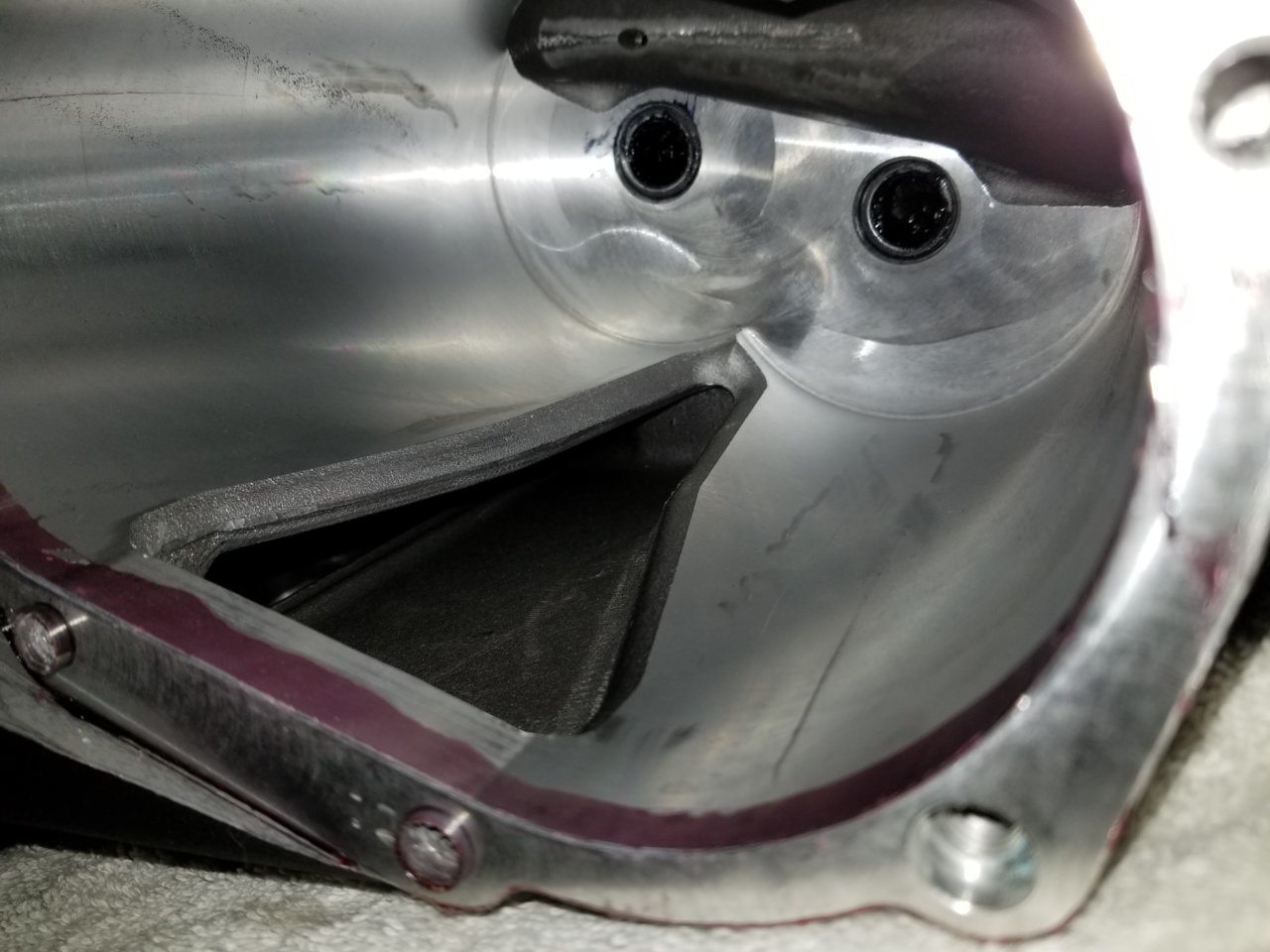

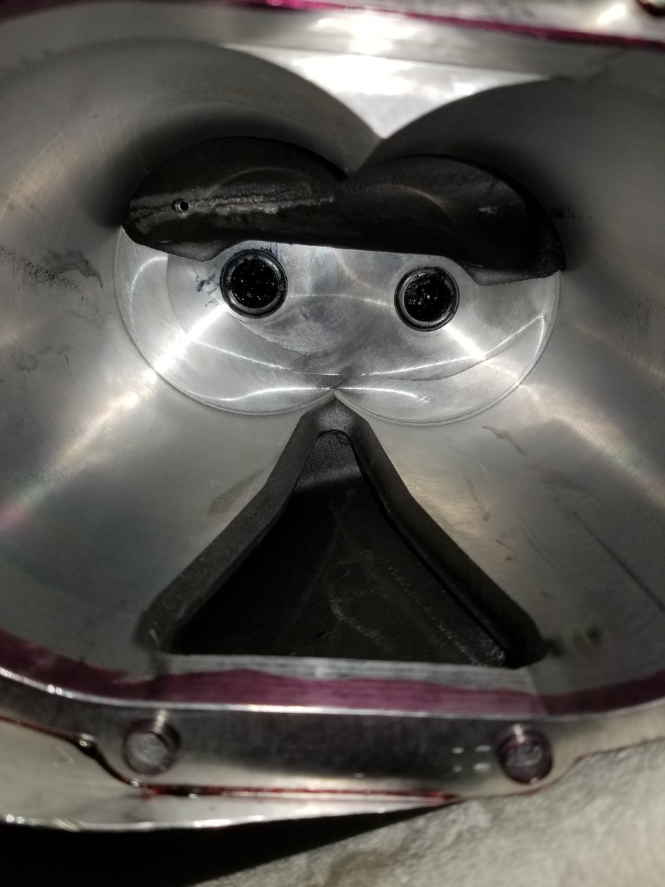

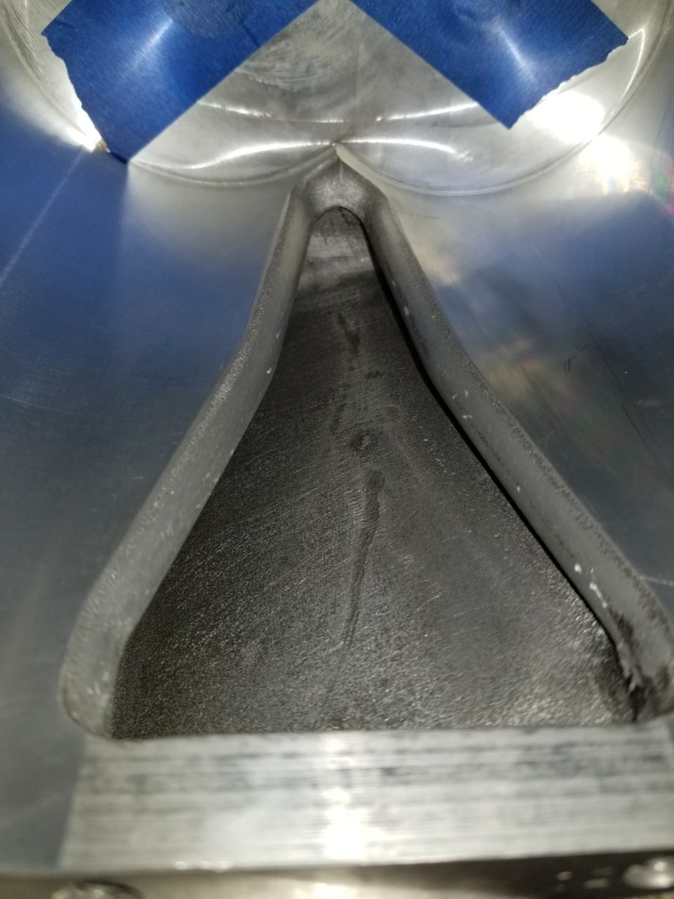

    Supposedly there is not much to gain by porting the gen V blower. I dont know enough about supercharger port timing to go hogging it out like that.
    Here is a before and after of my discharge port.
    Before
    After
    So I didnt enlarge the discharge port, I only smoothed the edges.
